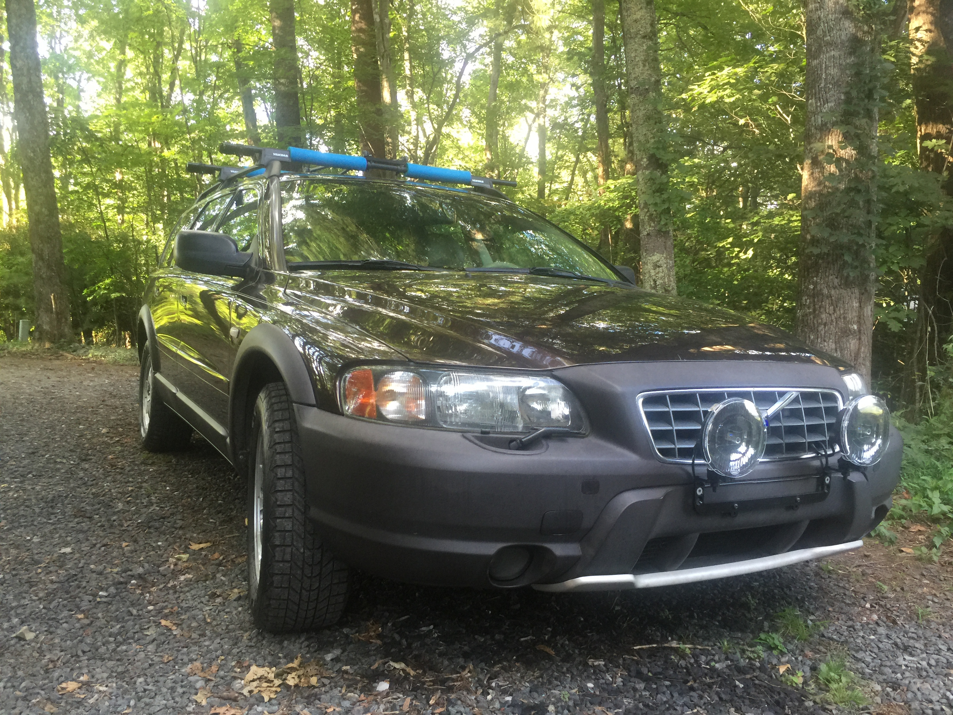

Good evening from North Carolina.
I have a 222K mile 2001 V70xc that I love. I have had it out of service for the last year and a half and am brining it back. I had a headlight issue that kept it from passing inspection. I fixed it a month ago. Now ready to get going.
I performed a lot of service over the past week of evenings. Replaced timing belt, pulleys, water pump, power steering pump and tank, intake, gaskets, pcv system, and injector o-rings.
Once I got everything bolted back up, it started right up. I let it idle while filling the coolant. After about 10 minutes the engine cut off. Since then it will turn over when the key is turned, but it will not catch.
The battery is new. I have performed the battery reset procedure several times. I have seen the Immobilizer warning show, but not every time.
I have gleaned a lot of great information from this forum in the past. Good enough that I have never had to actually start a post to ask for help, but this has me baffled. It wouldn’t be so bad if it were in my driveway, but I borrowed my in-laws garage to do my extensive service, and I know they want to put their car back in there.
I have had this car 10 years, and do the wrench work my self. The closest dealer is a two hour drive and I have never been there.
Your Ideas and queries are welcome and I will respond asap. I’ll be headed back to it in the morning and currently I am out of ideas.
Thanks,
Patrick

What did they call that color, was it eggplant? Looks good.
