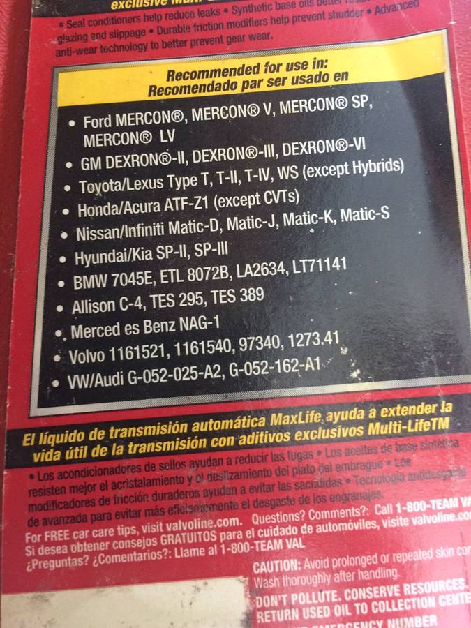

As I ultimately decided to have a shop handle the BMW tranny refill, I still have the MaxLife. While it doesn't call out "LV" on the front label it does list Toyota T-IV on the back.
Looking at the Valvoline website today, the ONLY MaxLife listed is the LV.
Thoughts about this vintage MaxLife (perhaps prior to the LV branding) being safe to use?

- Vintage Bottle Back
- maxlife_back.jpg (111.32 KiB) Viewed 1675 times
- Vintage Bottle Front
- maxlife_front.jpg (76.91 KiB) Viewed 1675 times

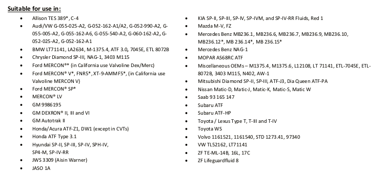

- Current Applications
- 2019-09-07 20_14_28-US_Val_ML_ATF_EN.pdf - SpringCM.png (41.09 KiB) Viewed 1675 times

I've been doing drain and fills using this fluid on my '94 850 and '06 V70. I don't think your vintage fluid is synthetic.

Actually, my bottles have the same text as yours..."synthetic base oils better resist clutch plate glazing and slippage"...so if yours is synthetic, so is mine

I've used the Valvoline MaxLife Dex/Merc LV pictured above as well as the Wolf's Head Super Universal Synthetic. Both performed identically. Both worked well. I wouldn't fear trying the Havoline product as well.
