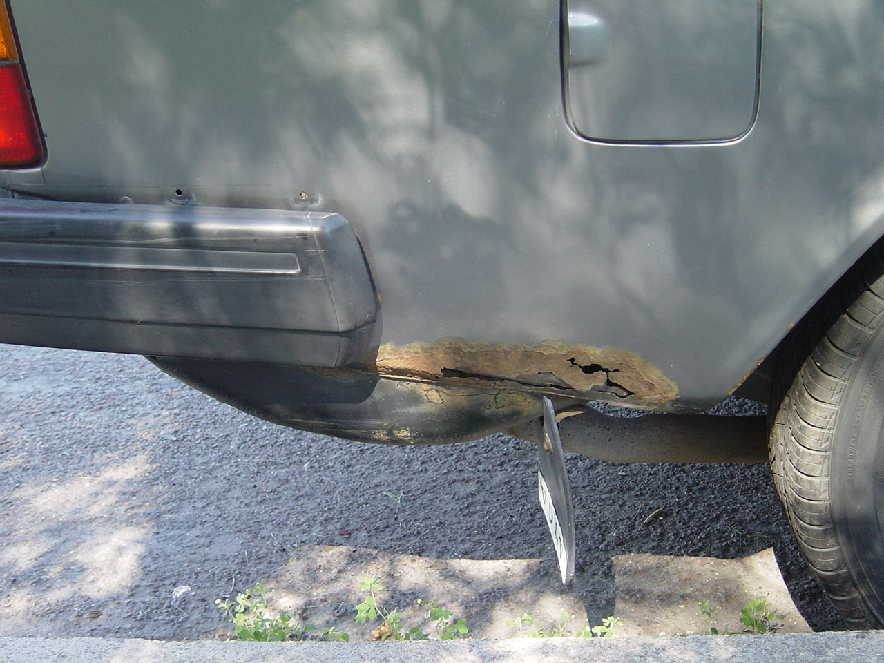

Agree with everything mentioned above. Very low miles, the question is why? Stored? Dried out rubber and gaskets?
They sometimes rusted behind the rear wheels by the spare tire well, as well as the rear floors.

Ask to see the pictures before the new paint. If they don’t have any, it’s a rust bucket
