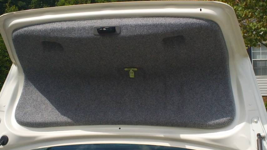

The key no longer works on the trunk lock. The spring for the flap door to the lock fell off and is blocking the key from entering.
The alarm module under the passenger wheel well needs a battery so the remote does not work at this time.
Any advise on getting into the trunk from the backseat so I can pull the cord? Thanks.

When the battery died in the Alarm Module in the passenger fender well I lost the use of the trunk remote and button at the trunk. The key hole is also broken as the small flap door spring broke so the face just spins and can't get the key in.
Don't have time to remove the Alarm Module Battery so would like get into the trunk from the back seat and tie a twine to the Yellow Emergency Pull Clip and open from the back seat for now. Good thing I didn't go grocery shopping or it would be gross siree by now.

Used a long thin wooden rod with an eye hook screwed into the tip to pulled the yellowish plastic tab and opened the trunk. Next removed the clips of the trunk lid interior cover and then the 2 screws for the trunk lock.
As I suspected the spring for the flip cover where you insert the key popped off. Son saw it come off earlier and kept it. The flip cover had dropped into the key hole and jammed into the lock. Remove it and now it works. Didn't bother trying to put the spring or the flip cover back just in case it jams again. Will see if debris gets in with the next big rain.
