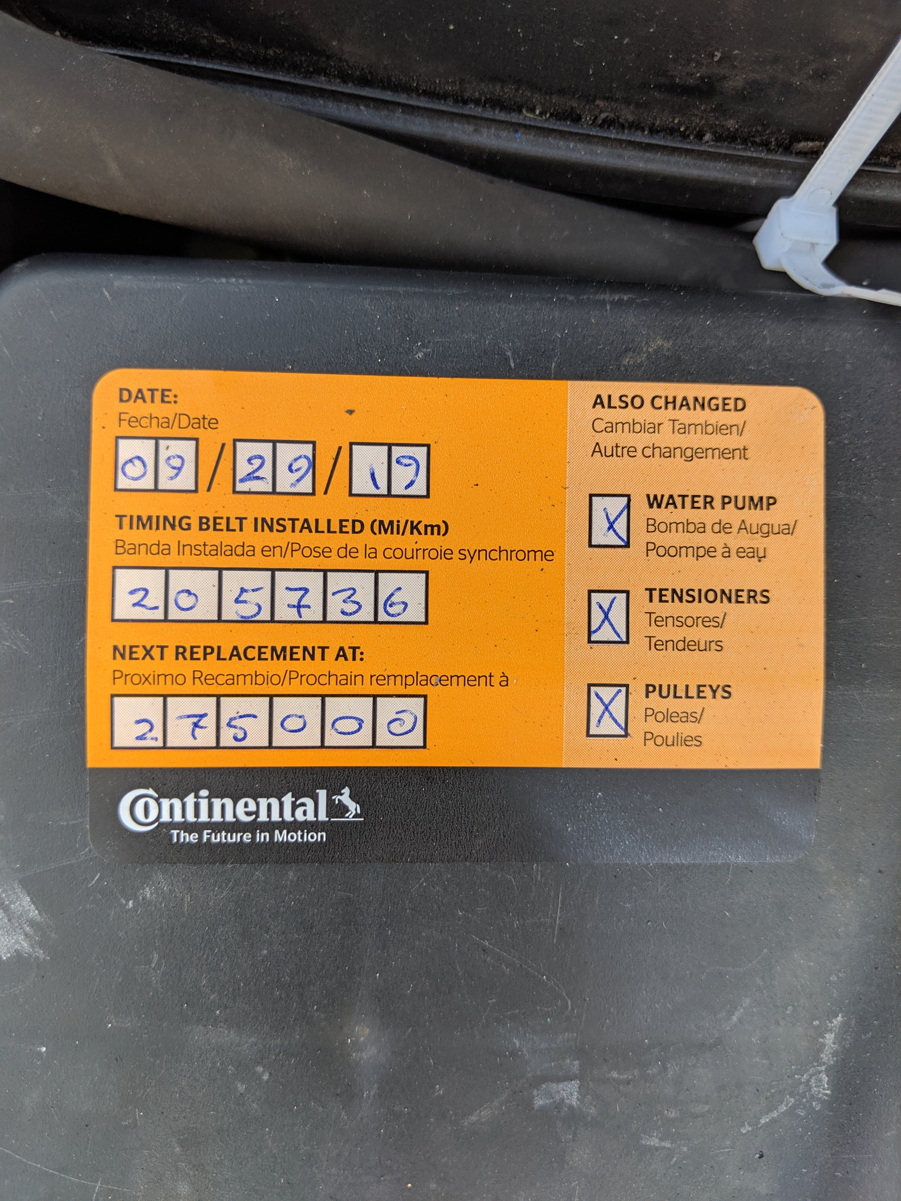

Also, i added photo of my new timing belt sticker I filled out myself! A very rewarding feeling, if a little optimistic.
