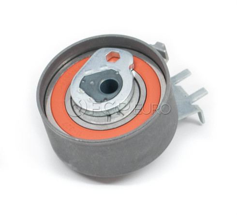

Sounds like this is loose... I'd make sure this piece is tightened down enough. Pretty easy to get a wrench on it. I had a similar sound 6 years ago.
