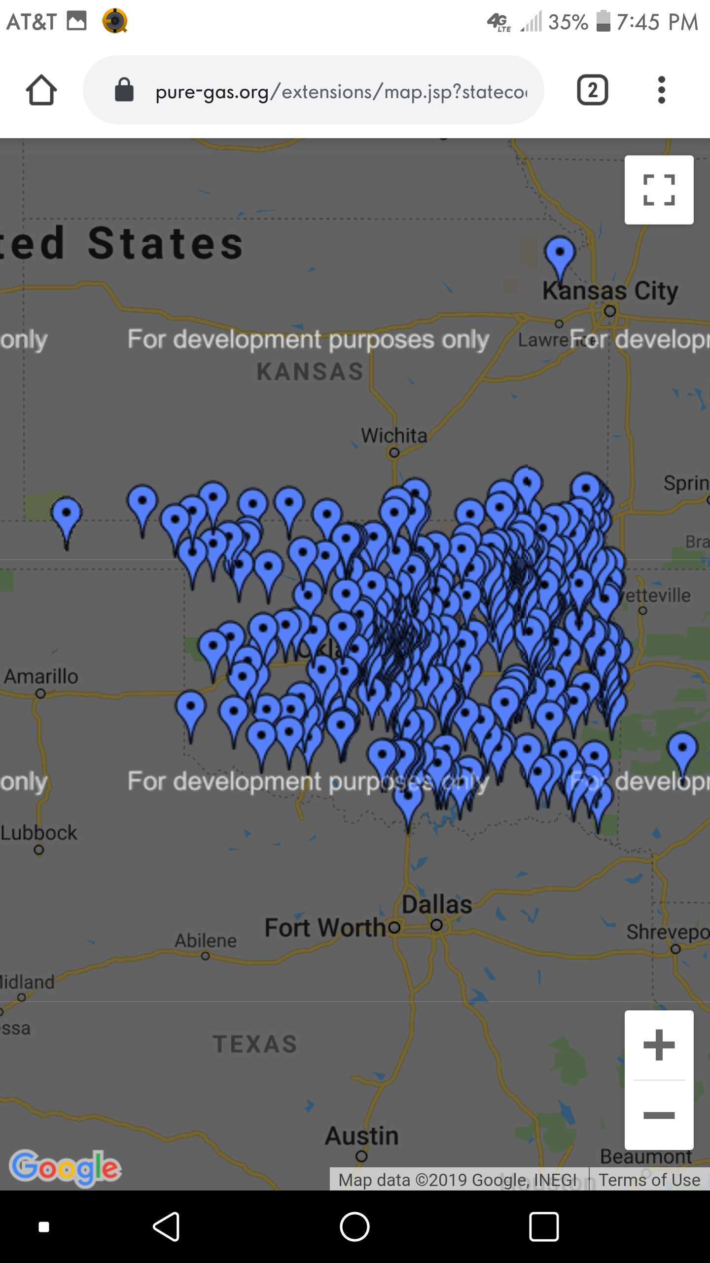

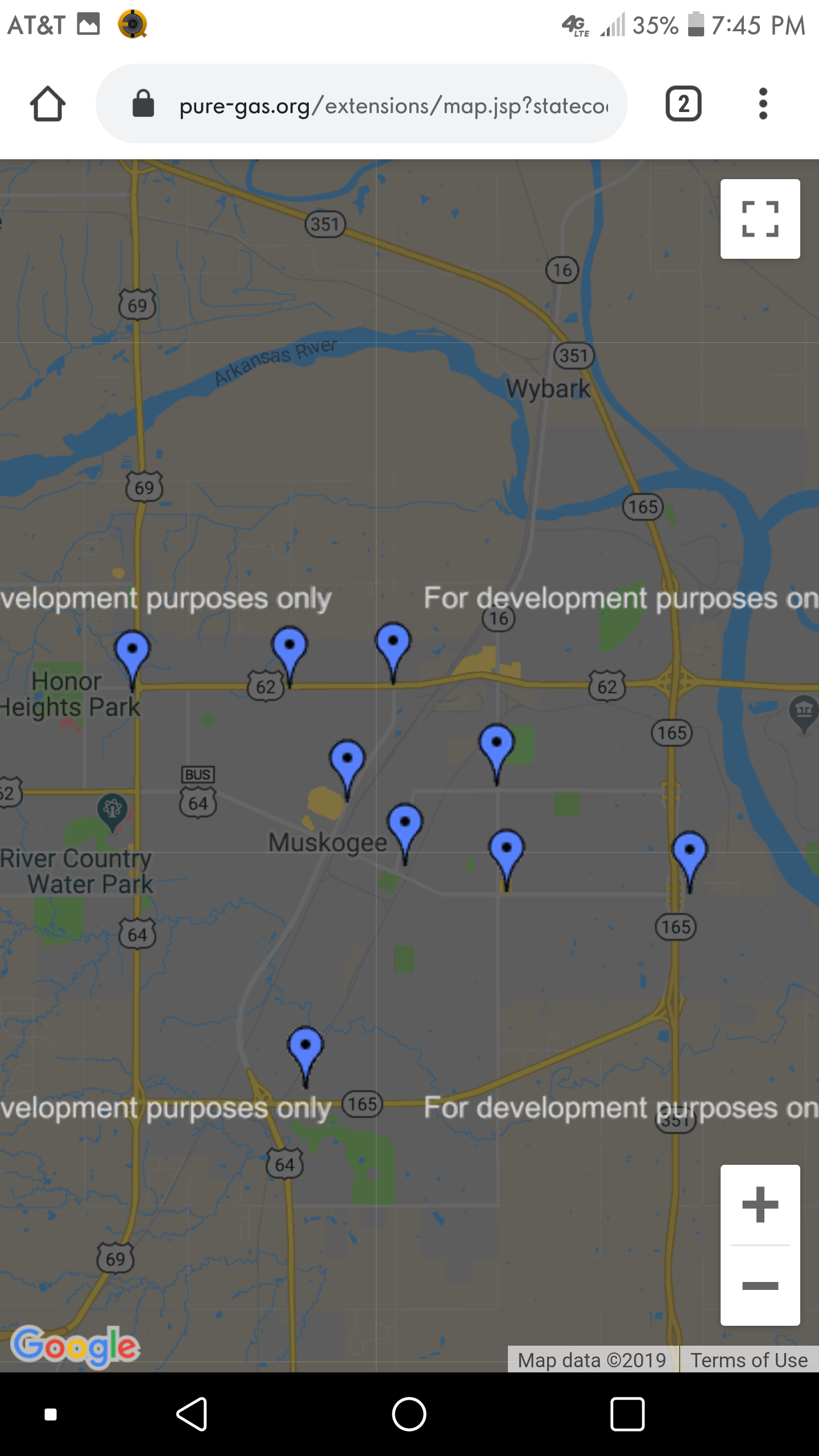

For those of you that like to use pure gas, refer to pure-gas.org. it's the most handy way to find some near you. It uses Google Maps.
