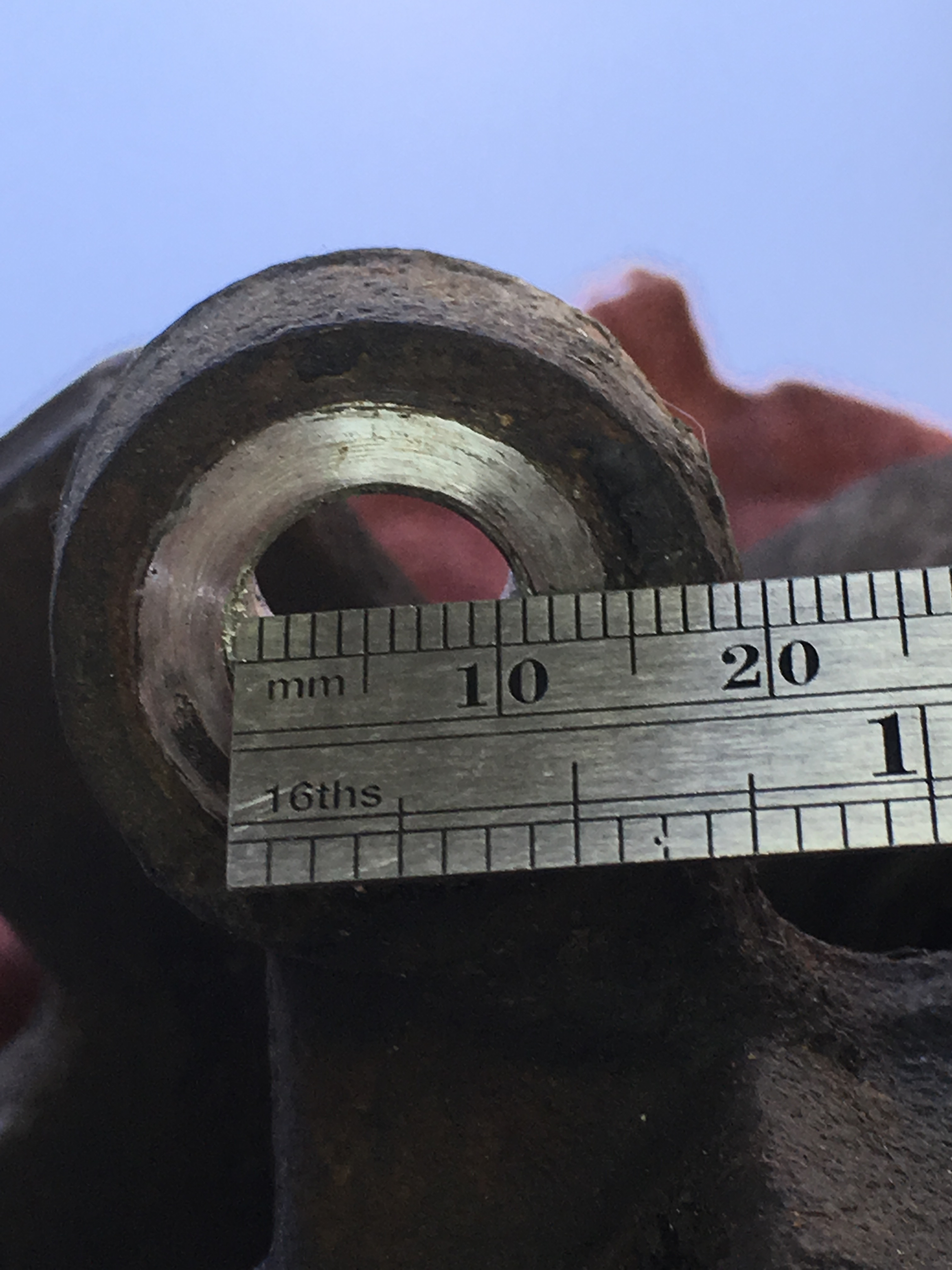

In ordering new calipers for the rear of my '94 850T, I'm seeing two part numbers. One says "with 10mm mounting holes," the other says "with 11mm mounting holes."
So, I'm a bit confused here - the bolt is a 10mm shaft, so of course the hole is just a hair bigger than that. How literal do you think that is? The hole measures maybe 10.5mm.
I though there was only one 850 rear caliper.
Rear Caliper 10mm or 11mm mounting holes..? 5003813 5003814

Thanks. I'm not seeing anywhere to enter VIN there. I see the M10 bolt.
On my car they list two at the rear, 5003814 and 5003813 - they don't say which is left or right, but that's my assumption....
What do you think "for 3546491-6" and "for 3546492-4" mean? Those aren't VINs I don't think. Mine is 2065786, miles from those numbers.
They also list a single (which side??) 850R and T5-R caliper for $260, "Genuine Classic Part."
<EDIT> It appears # 5003814 is LEFT
# 5003813 is RIGHT

If you go to FCP, they list a right rear Centric, "with smaller mounting holes." Not very specific, is it?
https://www.fcpeuro.com/products/volvo- ... -142-39511
The left Centric says nothing about hole size.
Ipd has rebuilt rears, with no mention of holes.
