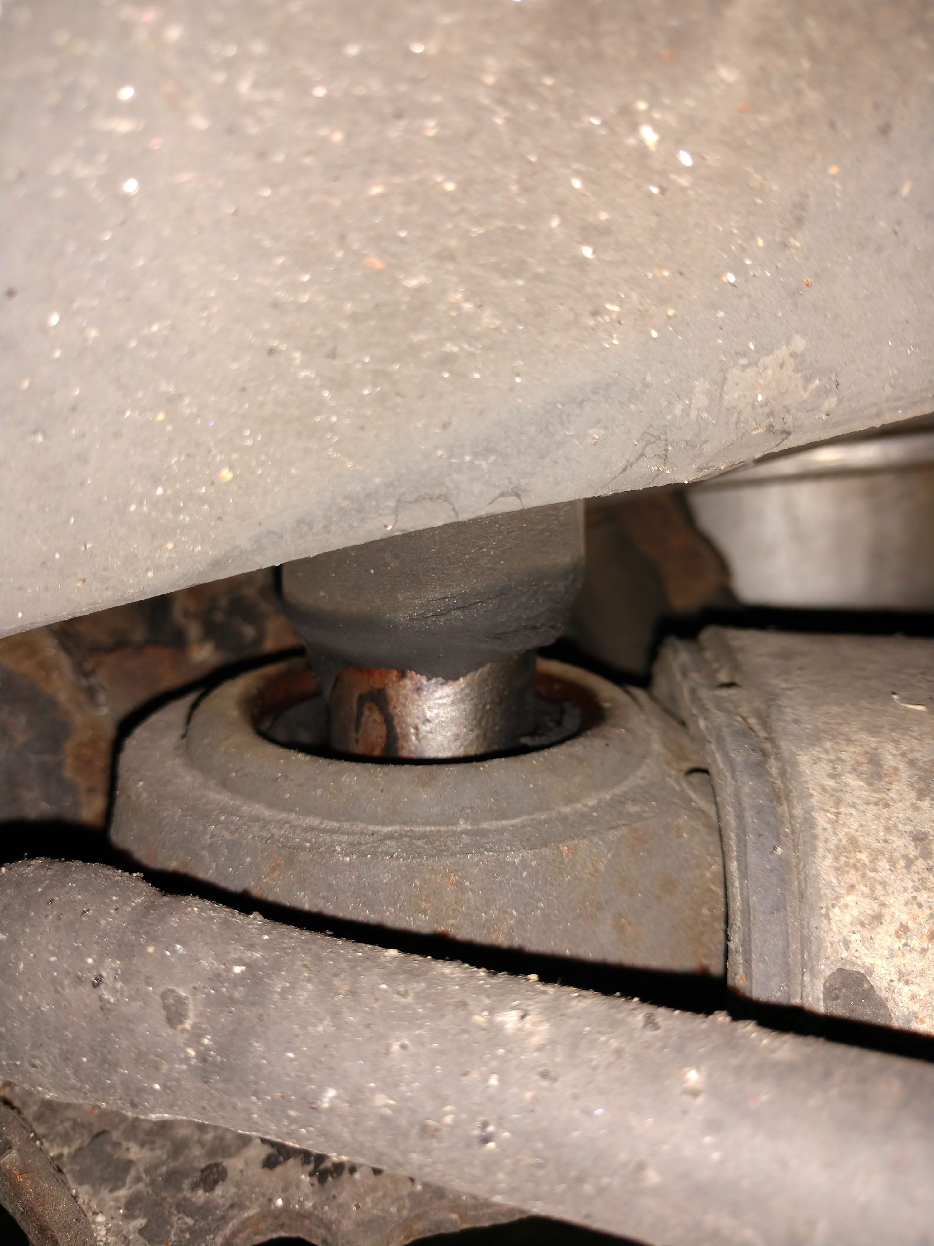

My 1995 855 have a banging noise recently whenever go over "a bunch of small bumpers" or rough road. The noise is more pronounce when no one sit on the back seats. I replaced both rear shocks and rear shock mount. But banging noise still there. No banging noise in rear passenger side.
Any idea about this banging noise coming from ?

It could be the rear axle bushing that connects the rear axle to the frame. If you replace it be sure to buy OE quality or you will be replacing it in very short time again. They are pricey but last forever.
The job is nasty to do, I let my indie do it.

It is also possible that the inner Delta Link bushing has failed. The one that connects the DL arms to each other. They usually split the bracket around the bushing and can rattle around.

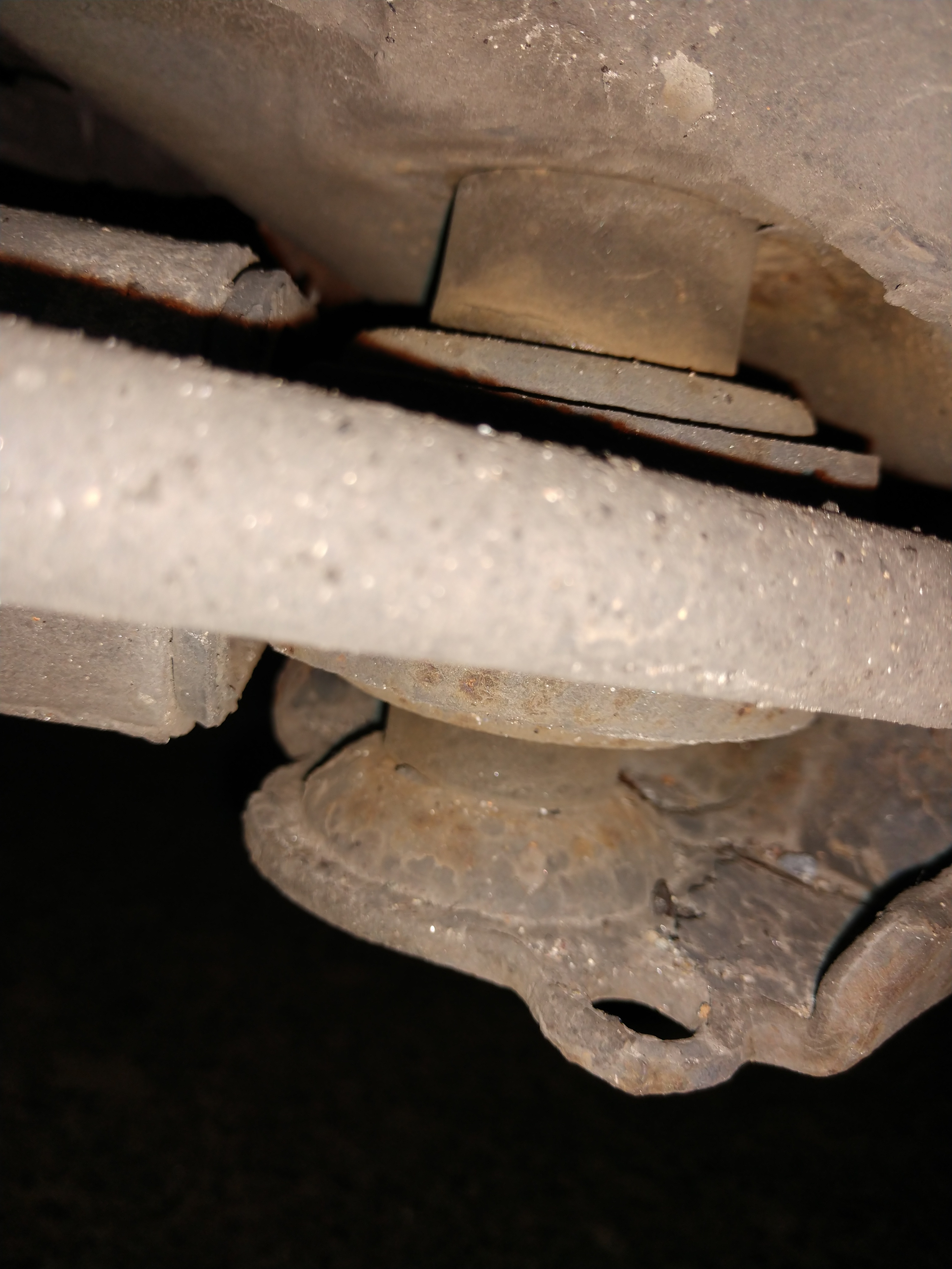

Just took a look at the driver side rear suspension and found the root cause immediately ! It is the delta link bushing. Febi brand does not hold up like Scantech (used in passenger side).
Time to get a better bushing ....
Thank you for all yours help.
