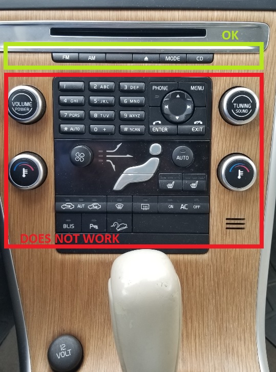

I recently purchased used 2010 XC60. This morning control panel centre console (CCM) stopped working. I can change radio stations from the wheel control buttons (as well as volume), but cannot control anything related to control panel centre console (CCM).
Before I take the car to the service, is there anything I can do (reset, fuse, cables, etc.)?

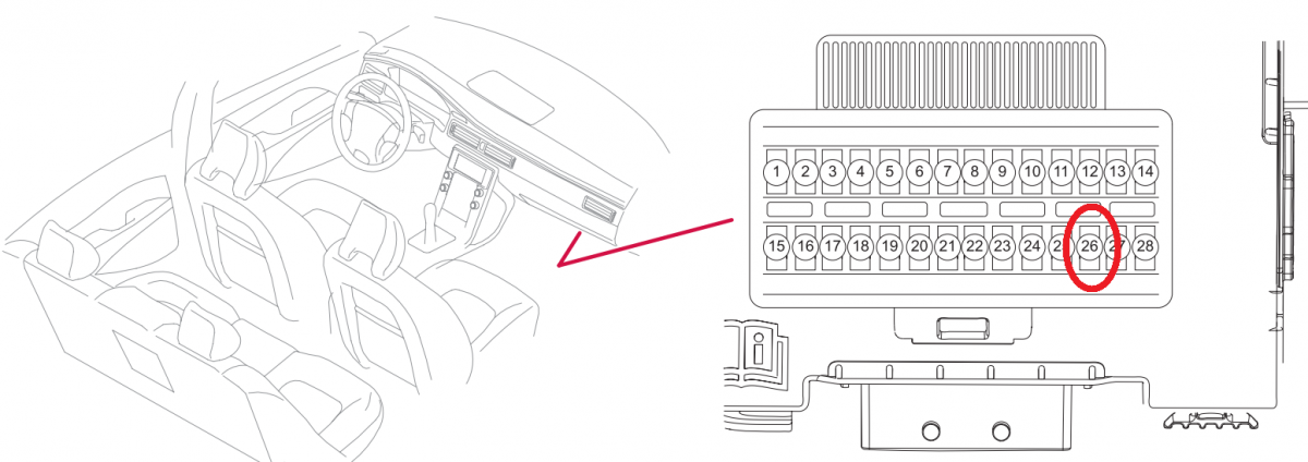

Checked. Blown fuse. Unfortunately, as soon as I installed new fuse, it blew again.
Most probably there is a short on PCB. I will take my car to Volvo service tomorrow.
Thank you for instructions about fuse location.

Very interesting development. After I left the car at authorized Volvo service, they called me back, saying that the only thing that has been changed is the fuse. I have not picked up the car yet. I clearly remember that when center console module stopped working (blown fuse) outside temperature was about 10 degrees lower than previous days. I have not yet seen piece of electronics that will blow a fuse one day and work properly next day, but time will show. It could be wiring problem, not electronics.
volvoxc602010
- Posts: 4
- Joined: 08 Oct 2019, 06:49
- Year and Model: 2010 XC60
- Location: Virginia
- Has thanked: 1 time
Picked up the car from Volvo service. Everything works fine. The bill says that the fuse has been replaced. This is definitively the most expensive fuse replacement so far: $155.
