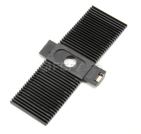

How's your:
https://www.fcpeuro.com/products/volvo- ... 50-8699465
When this thing, made of swiss cheese, is broken you will get shift error messages eventually. You'll notice there's a sensor contact on it. If this is broken, replace it. You only need a bone tool (plastic pry piece) and a lot of patience... It took me over two hours to carefully remove the dash pieces...

I appreciate the advice. I replaced the 1st item(shift blind) about two weeks ago. It was broken. Did not help. I'll have to see about part number 2.
