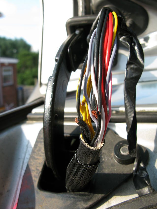

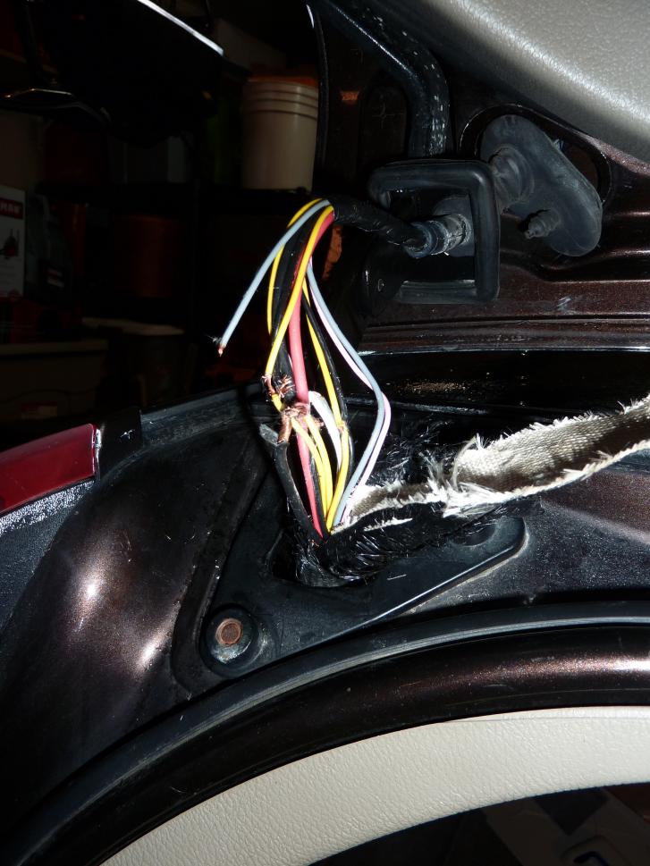

I would definitely check the wiring in the left rear hinge area and be sure to pull back the protective jacket some as the broken wires could be back a ways under the harness jacket. I attached some photos I've found online with the problem. My car has the same problem and the intermittent tailgate open condition would set off the alarm sometimes after the locking the car and it sitting in the garage at night. If other wires are broken you might see the license plate lights out or go on and off as you raise or lower the tailgate, rear wiper or rear lock not working.
