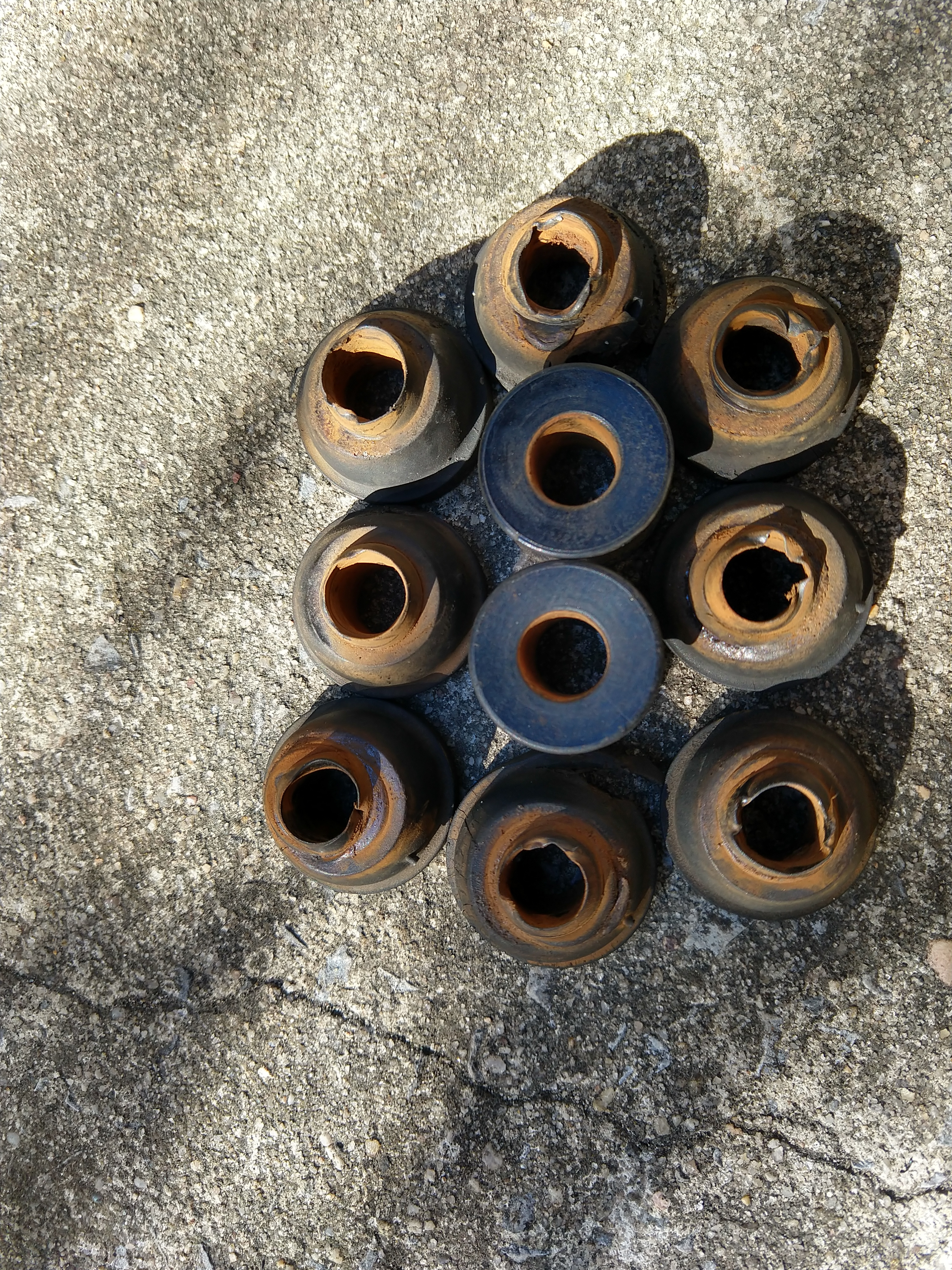

Okay, here are some updates:
This is what were were looking at. Not sure I understand how a few bad bushings would make the rear so loud, but that's Volvo...
Bushings were completely dried out. Some were severely cracked.
The Ford piece does come with a screw that is a little bit longer than the Volvo one. But it works. We're only looking at a little more than half an inch/.
Here's the final install. The rear end feels super tight now. (I also had to remove my shocks and screw down a shock that I hadn't quite torqued down...)
Final thoughts... Is this better than The URO piece? Not sure. These bushings are made in America. (They say so on each bushing.) Hopefully, that's a good thing. Will definitely keep an eye on this moving forward. The real test of any rubber in NYC (hahaha) is how well it does after a winter.
Part used: MEVOTECH MK90130 Supreme, $6.15/each
