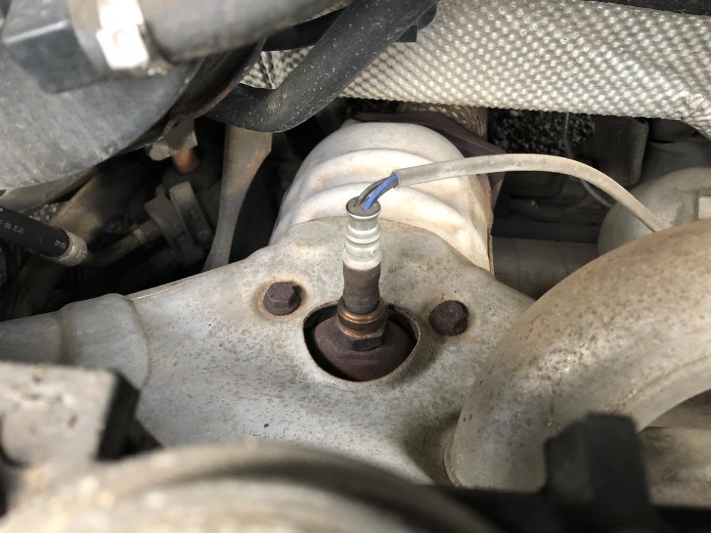

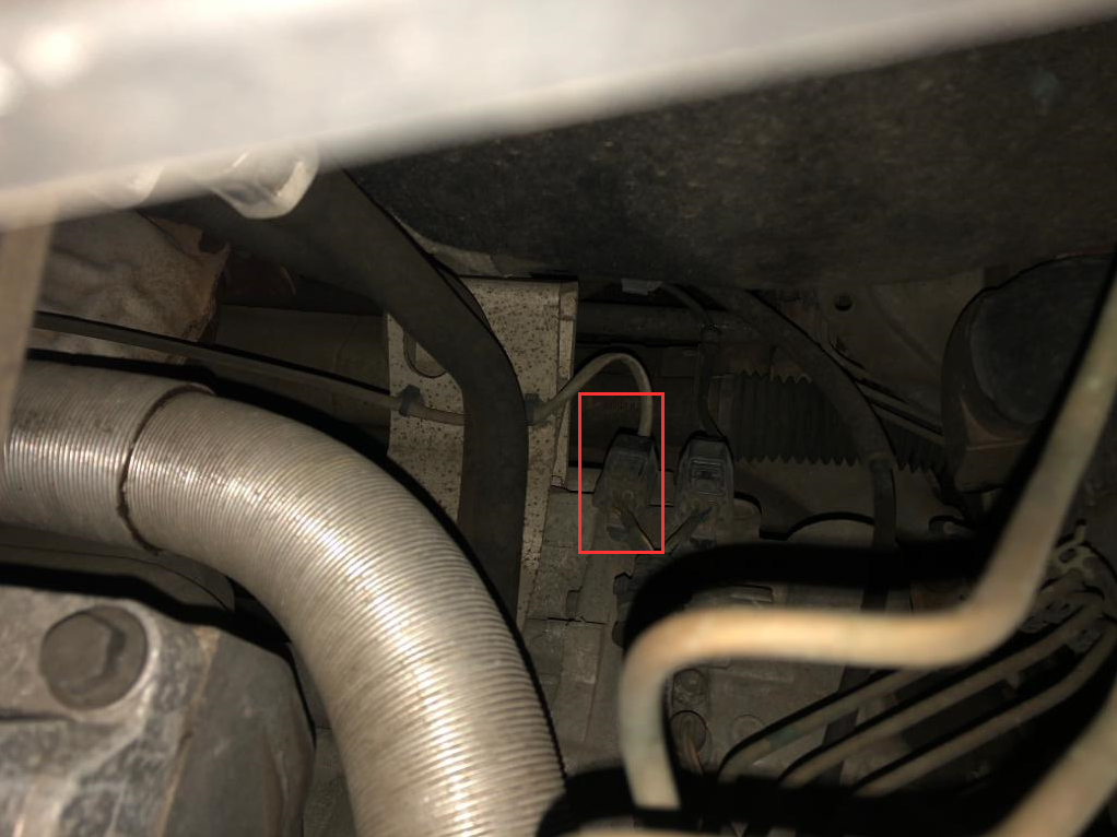

I have read and watched a few guides about how to replace this myself and it looks sort of doable, however I am having difficulty locating the sensor as all the guides I have found are for left hand drive.
Can anyone advise whether the position is the same?
Please find attached a couple of photos.
Am I right in thinking that photo 1 is the correct connector?
...and photo 2 is the front O2 sensor?
(I must admit I am hoping they are as this makes the job a lot easier...)
Thanks!
EDIT: I realised I had my Left and Right mixed up, edited post for clarity...

Thanks for your reply Oragex,
Yes, I watched that video when I was researching and the sensor is in a slightly different position to mine, I am guessing this is because it is Right hand drive (my original post was misleading - had my left and right mixed up :roll: ).
Anyway, I have just received the Haynes manual this morning and it looks like I am indeed looking at the right part - I will try removing it this week.
Thanks again

So I tried it after 3 days of morning / nightly penetrating oil soakings and it will not budge.
I have a 22mm socket with a slit for the wires as I wanted to be sure I could get it off first before committing to wrecking the sensor (in case I need to get it to a mechanic after all...)
I have acquired a blowlamp so will try your cycling idea this weekend, thanks for your advice

Well, I heated and cooled it 4 times and tried but... no success.
I have acquired a stiff breaker bar (mine is ratchet) and will try again.
Kroil or PB Blaster are pretty expensive in the UK, so will investigate the light oil / acetone option.

So I drove it home this evening and had a go with the stiff bar and it came off with barely any resistance!
I am so pleased, now I know I can order the part and replace it.
