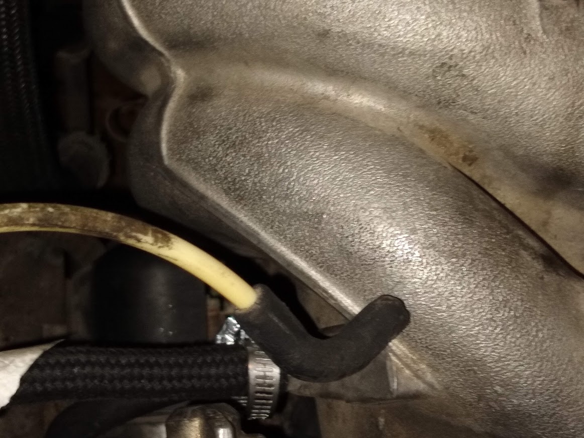

I have a fourth hose that's supposed to go from the turbo to the front of the intake manifold (the red hose in the diagram). Is that right?

I have a seventh hose that goes from a hose near the fan to the intake manifold. That seems right. (See the attached photo.)
So ... between the fourth and the fifth hoses, it seems like both could go to the intake manifold, but both can't. One suggestion to me has been that the hose by the PVC goes to the TCV, but the third hose is already going there.

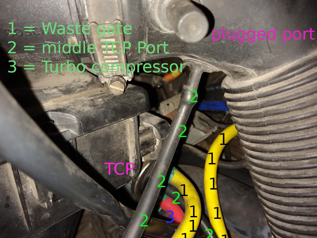

Here's a picture with labels showing what the hose routing is at the TCP. Note, the plugged port is just a port that could have a tube to it but has a plug that slides off instead.

I'm pretty stumped. If the hose labeled 2 in the above photo goes to the intake manifold, where does the hose labeled 4 go to? Or should it get plugged like the other one on the turbo hose?

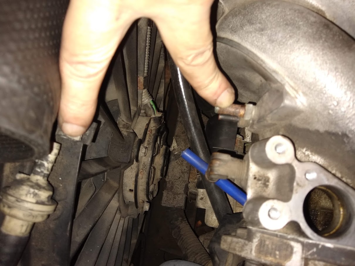

I see where the EVAP system connects to the intake (see the pic with my fingers in it). But I don't see a second place where the snorkel can connect. On some cars, there's a t-connector after the evap solenoid, but mine doesn't have that.

Unless someone says otherwise, the vacuum hose #4, connected at the fresh air pipe to turbo, connects to the valve (grey plastic) near the fan in your pix with two fingers, NOT to the copper nipple at IM.

Maybe. I've just never seen that gray plastic connector go to anything but the intake manifold. I've seen it go there with no t-connector and I've seen it go there with a t-connector. And I've never seen anything else go there.
