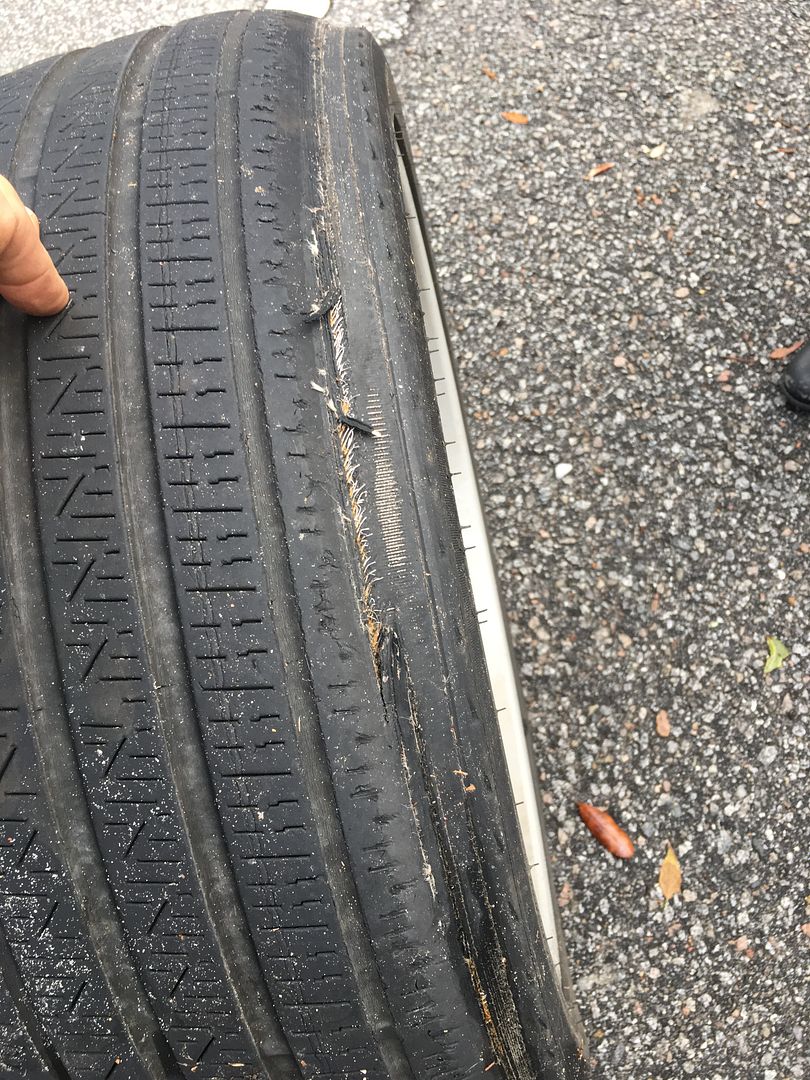

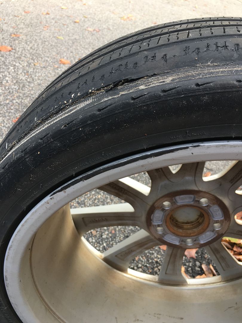

Yes, my 2017 S60 which I bought new has 40K mi now. Just had a flat on passenger front due to some crazy wear. I find it hard to believe it's an alignment issue. Just sent it to dealer and they say the solution is to run a harder tire. Wha?! Asinine. This is a design flaw if tolerances are so tight that being out of alignment causes this (see photos below).

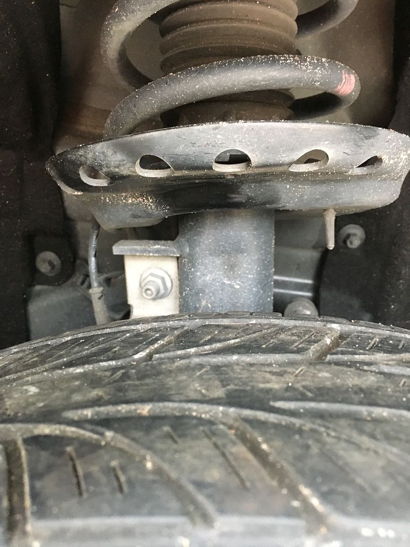

Note the clean black spot on the lower spring plate. That appears to be where the tire has been contacting hard parts. There's no way this is from being out of alignment. Look at the difference in tread depth to the problematic section!

In your second photo the tire will have to be very, very tall and wide before it can potentially flex enough laterally while on a turn to rub the strut's spring perch. The second photo with the strut and tire setup will not produce the wear you show on the two tires. Also, the tire in photo 2 is different from the tires in photo 1 and 3? Photo 2 has a directional tire.
The SAI Angle will not allow the kind of rubbing especially when the tire is so much lower than the spring perch. Follow the link to the bottom of the page for SAI Angle. It is set meaning designed into the suspension so the tire and strut move together.
https://www.superiorengineering.com.au/wheel-alignment
Even if the Camber was off, which would be very little as there are no adjustments for it, the Included Angle would not differ enough to cause rubbing. Same link as above scroll down pass SAI and Included Angle is explained.
Without looking at Alignment Specs and the Suspension in general it would be very difficult to make any calls as to why there is such bad wear or maybe potentially rubbing against something else. Could be a combination of things also including defective tires.

Thanks for the elaborate reply Mo. It's the same tire, just different angles. 2, showing the spring plate mark, is showing the rub mark rather than the worn inside, so maybe that's confounding things.
I spoke to a couple different trusted Volvo techs and there's consensus it's a simply alignment issue, exacerbated by the soft stock Pirelli rubber.
Thanks for the reply. I suspected alignment and tire issues including improper inflation but it is still very extreme for sure. I can see the tires in Pic 1 & 3 where it shows the damaged tire being the same but the tread pattern on Pic 2 :? ... Not getting it regardless of angle. The clean black spot on the Spring Perch of the Strut should not be tire related.

HA! Now I realize the difference - in desperation of avoiding a tow I test-fit my 850 spare wheel/tire but of course it didn't fit. That's an 850 wheel/tire laying against the rotor. Sorry about that, totally forgot until I just looked, thinking, what the hell is he talking about?! Did I mi....err, yep I sure did :0
Whew, thank you for the clarification. I was thinking, how...?
