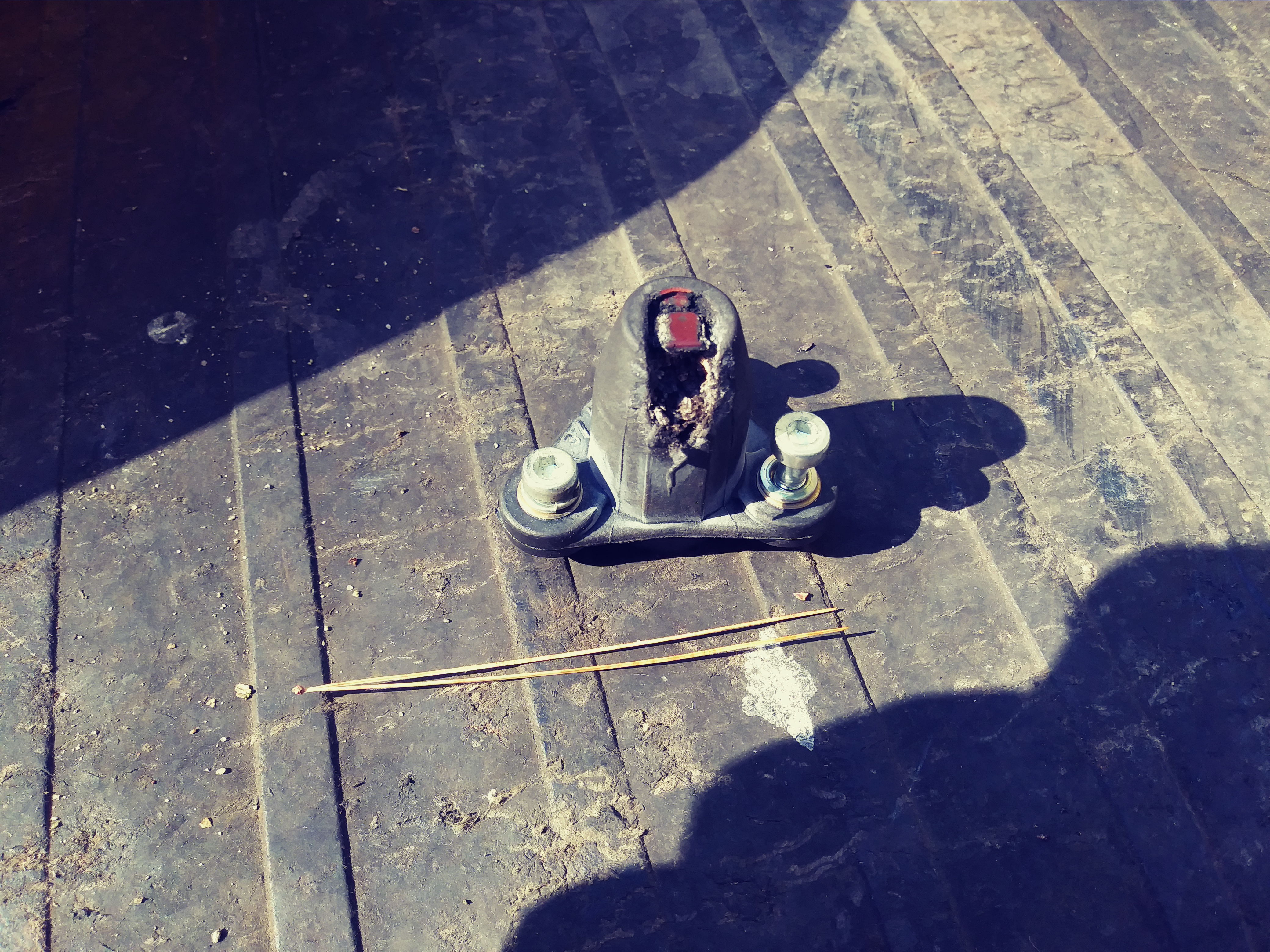

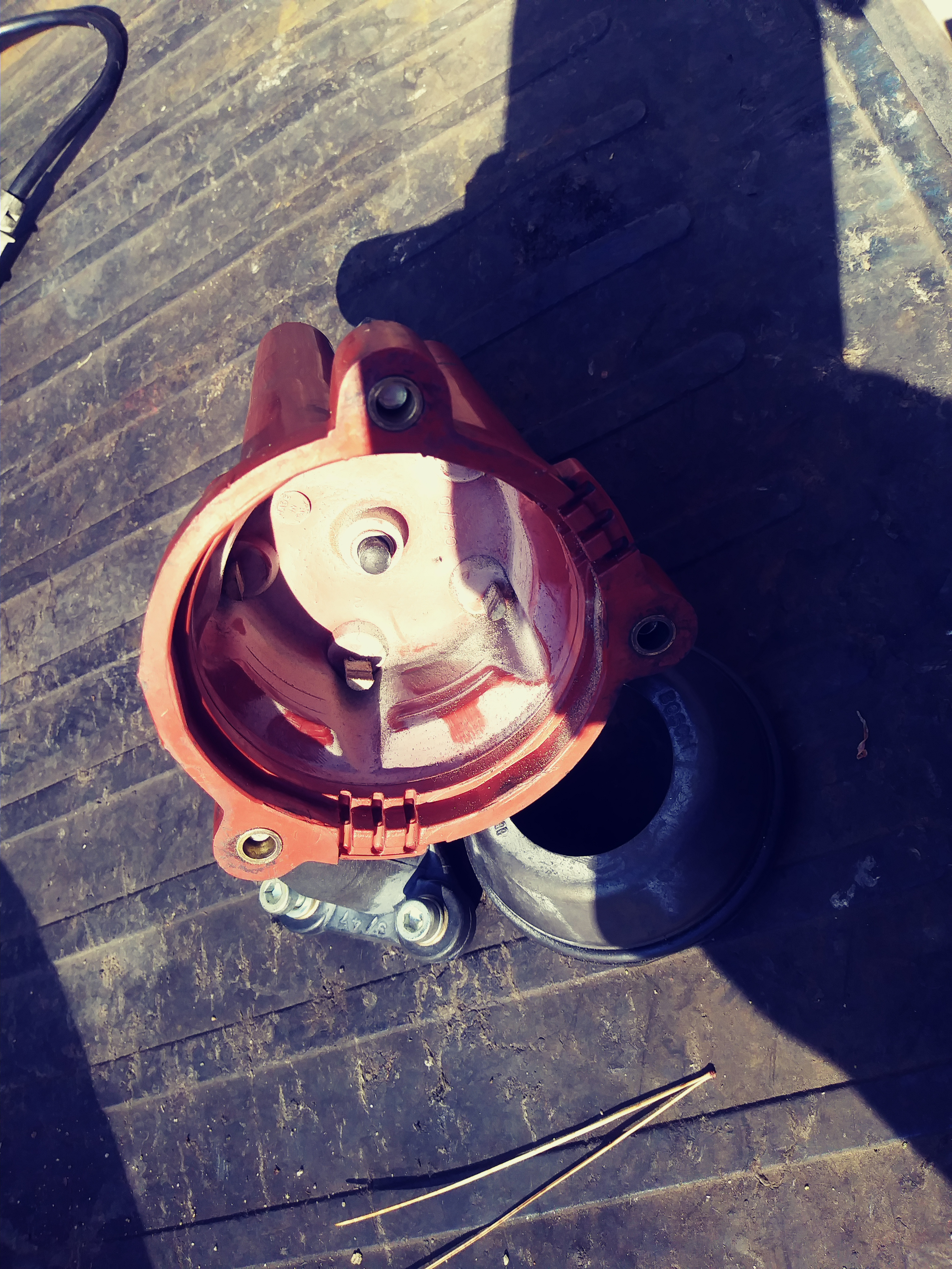

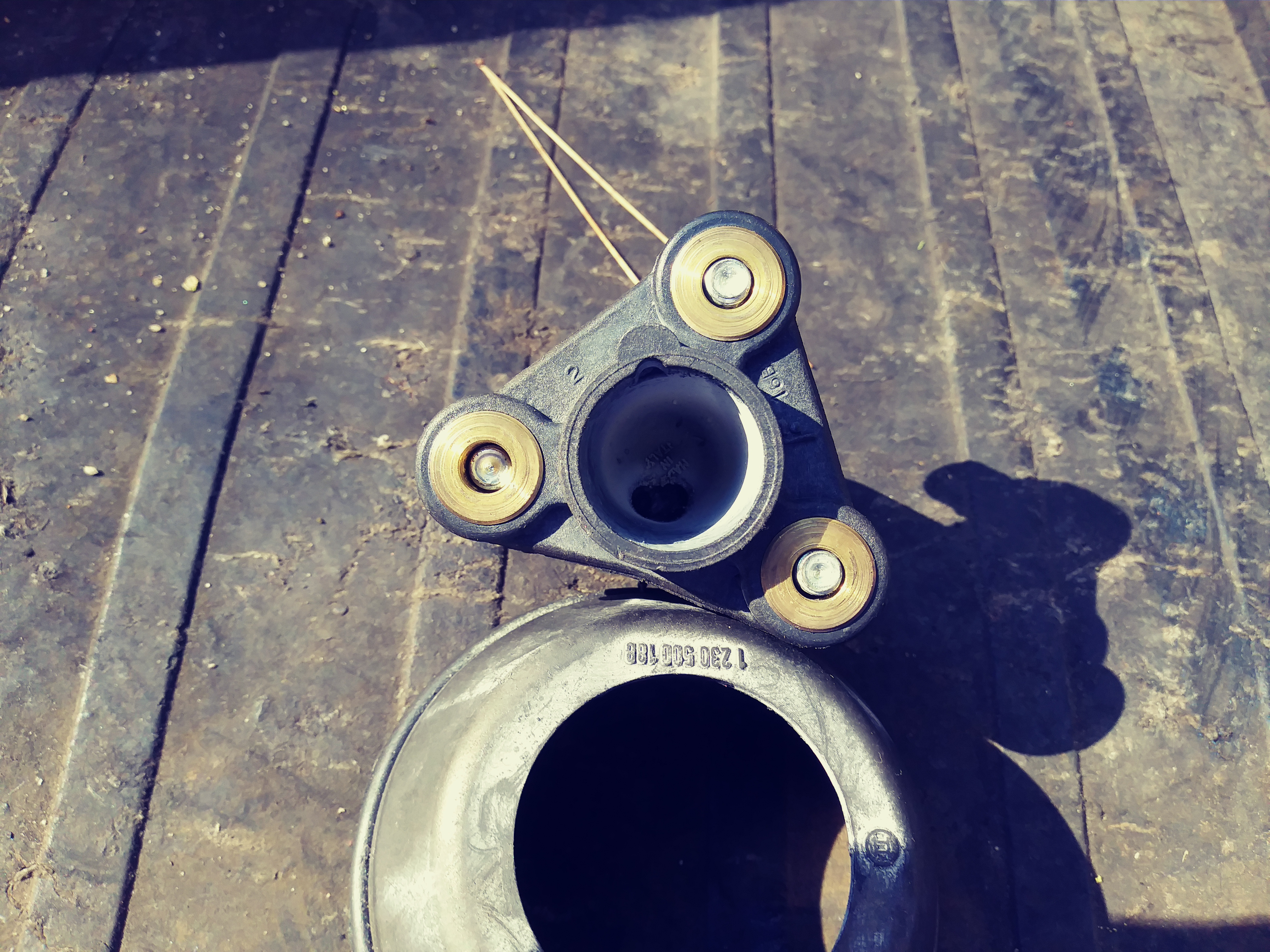

So I decide to pull the cap off and when I do a cloud of white dust puffs out and I find the rotor is completely melted??
in pic 2 its hard to see but there is a round burnhole in the underside
in pic 3 you see the inside of the cap covered with the white dust from the burned rotor
has anyone ever seen this ? Is it indicative of a bad part or something else ? Not sure what brand the cap and rotor are they were new but not in a box I found them in a baggie left by the previous owner in the pouch on the back of the drivers seat. They were put on about 2000 miles ago if that

If there is not stamped Bosch on both...cap & rotor....that's why they burnt.

Googling outside of this forum is bringing up various discussions of too high plug wire resistance causing melted rotors .
Also that some rotors have resistors built in and those can disapate too much heat and melt the plastic
I don't see a name on the melted rotor , its black and is marked 3/47 on the upper side of the base and F 168 on the lower side. The bolts have an allen head unlike the torx head on the rotor I pulled from my parts car

A Bosch rotor has allen heads.
What is the date code on the wires? I'd also check if they are all fully seated.

bronco wrote: 25 Oct 2019, 07:00 Googling outside of this forum is bringing up various discussions of too high plug wire resistance causing melted rotors .
There isnt enough current in a spark plug wire to generate "melt plastic" type temperatures. Thats probably just bad parts.

I only say that because I'd seen it in my fords that had CD type ignition boxes . There was a box made by crane that could burn holes in the cap :lol:
I do have a used Bosch rotor in there at the moment , I'' get a new one and keep the one I have in there as a spare .
I do want to check the wires and plugs though to see what the plug gaps are at
