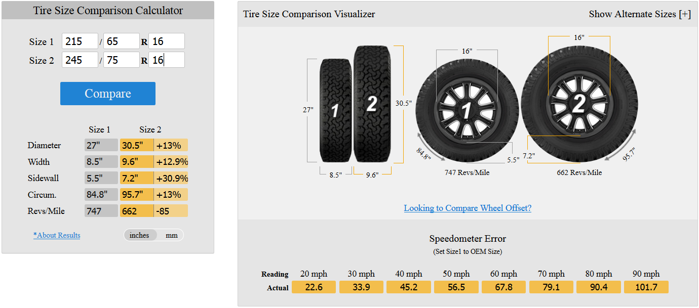

The difference in overall diameter is really too much, over 3". I'm not sure it will even fit inside the fender. I would be fine with a difference up to 1" or so https://tiresize.com/comparison/

As oregex points out the new tires are bigger. Do check the numbers on the website he provided.
The first number is the tire width in mm: 8.5 and 9.5 in inches.
The second number is the height to width ratio.
The bigger width and increased height ratio indicate a significantly larger tire.
1. The new tires about 1 inch wider and so might not fit on the wheels.
2. Also, and this is not a minor point, they are over 5 inches bigger in diameter (30.5 cf. 25.3 inches)!
If they were to fit in the wheel wells, your turning circle would be reduced to that of a fulled loaded oil tanker! You would have to add a new option to Waze navigation to avoid routes with curves. The tires will hit the side of the wheel well cavity so much sooner due to being half an inch wider of the inside, and 2.6 inches longer from the 'axle' to outside edge (radius).
You may even need a step ladder to get up into your car.
Still, you would get the monster truck look if that's what you like and you don't need to drive your car any more.

That's 3.5" bigger. On the axle the dimension is split in half up and down besides the front and back of the fenderwell space. A monster truck style lift kit? Well, not that drastic but...
