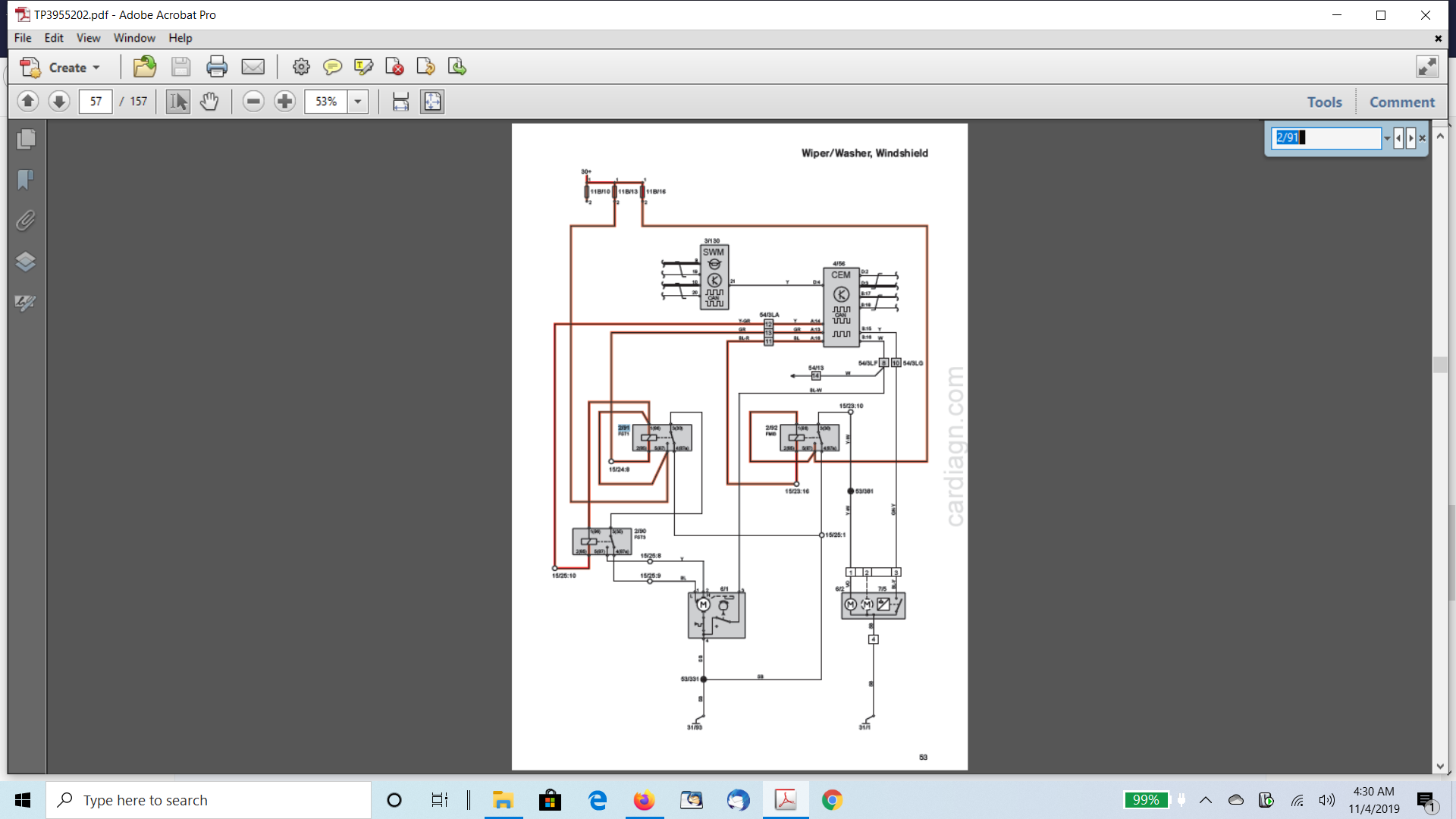

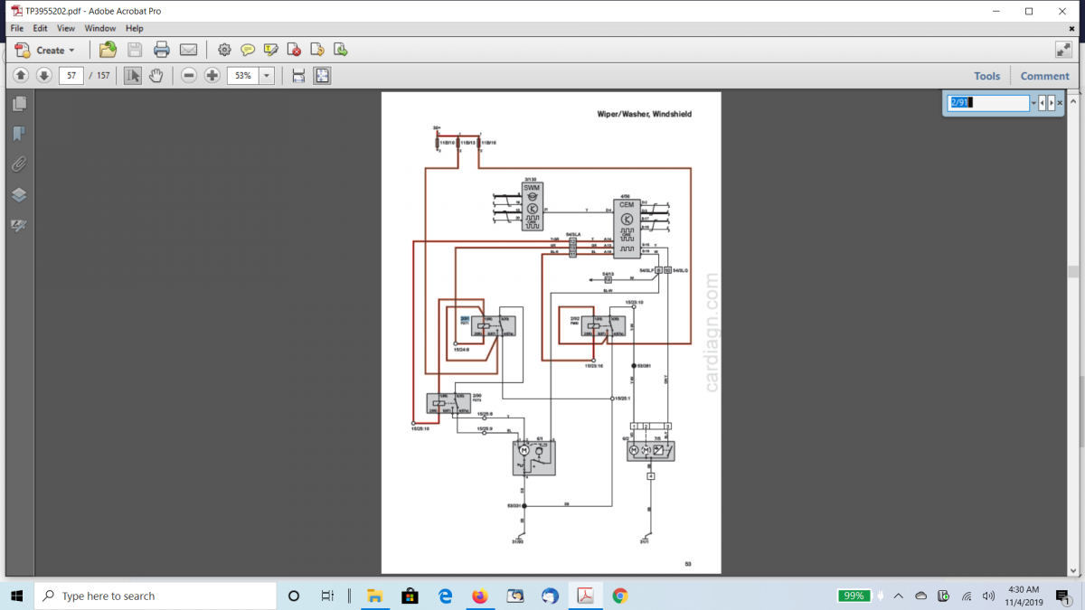

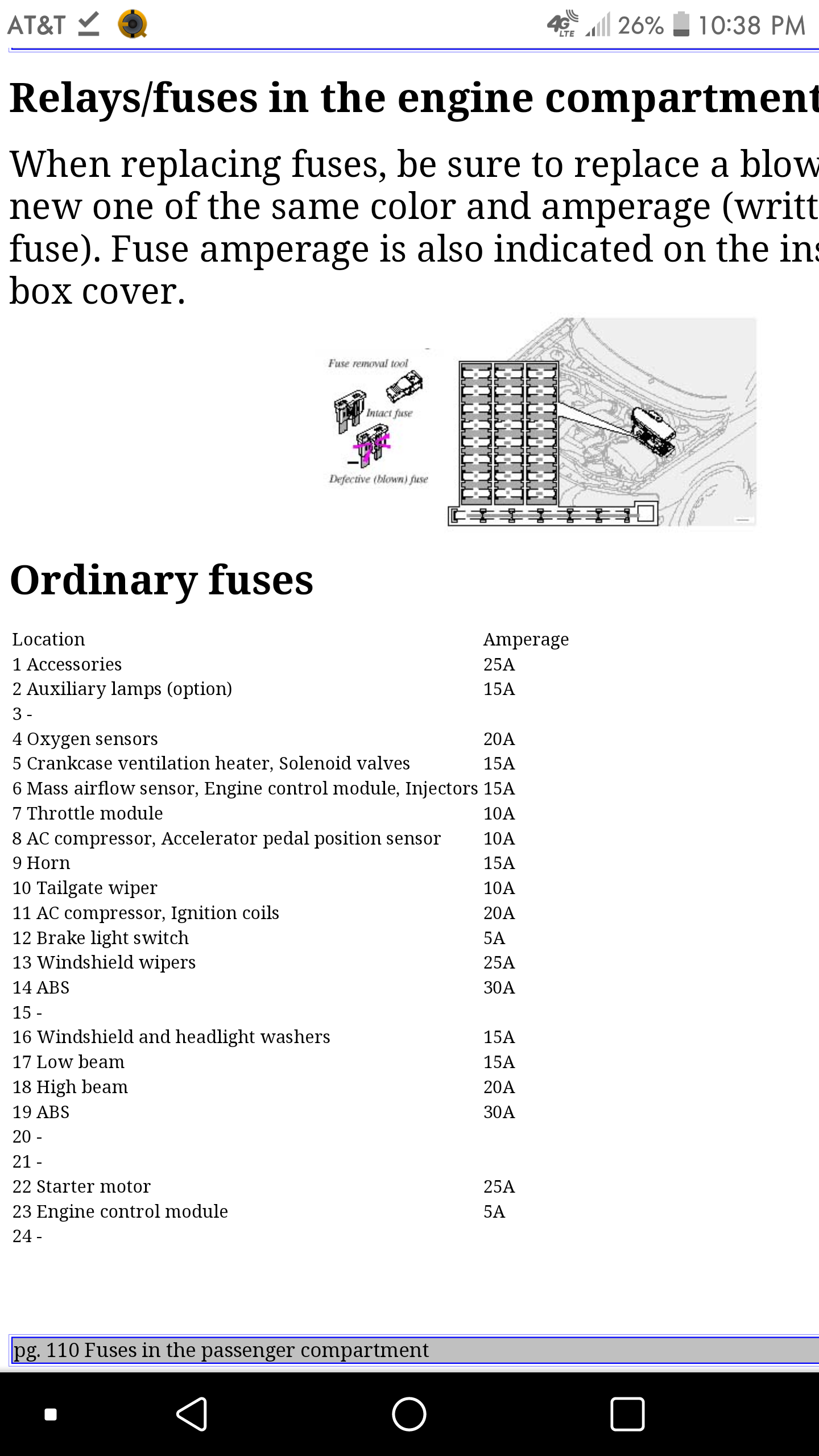

Number 13Volvoeric wrote: 29 Oct 2019, 22:04 2001 Volvo s60...wipers won't work..changed switch. That didn't work.How many fuses in system?

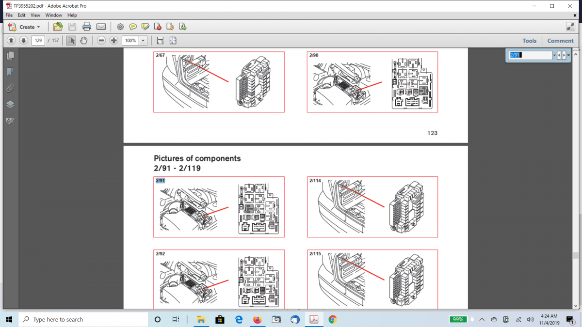

Just the Wiper part ...
One fuse, two relays all of which is in the engine compartment fuse box.
Fuse #13, relays 2/90 & 2/91.
