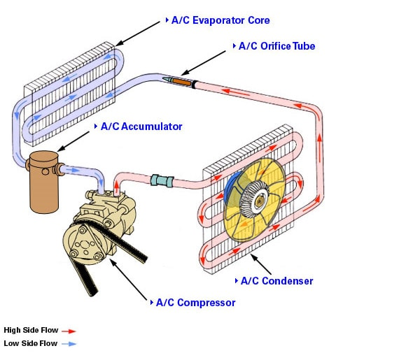

I know it's oversimplified but on car or off and which end do you intend to spray/flush from? How long is your liquid line?waynegarbo wrote: 01 Nov 2019, 14:46
I have seen Scotty's video but I don't believe it applies to my condenser because it's an older system with larger passages... But right now I'm asking if I can leave the liquid line on when I flush the evaporator.
https://www.autozone.com/images/MEDIA_P ... iagram.jpg

In thinking about this more, it would be best out of the car and back flush without the low pressure liquid line. Afterwards, I would forward flush the evaporator also.

The orifice tube in the line next to strut housing needs to come out if it is not already open there. You can't flush it with orifice in place as that will restrict flow and catch all the debris that might be there.
