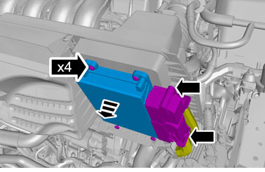

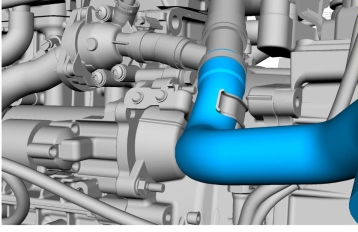

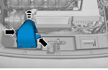

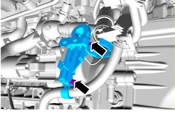

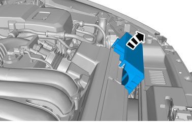

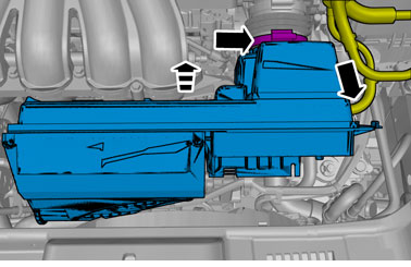

How do I remove the starter. There is a "click" from the starer but it will not turn over.
The air box looks like a job to get out first. New to Volvos but I fix all my own cars. These things are different for sure. Lot of special tools needed. Not sure if I am sold on them yet.
The 2007 S40 I have is in great shape though. 114K with engine and turbo at 76K.
07 S40 starter

1. Remove ECM.
2. Remove MAF.
3. Remove Air cleaner housing.
4. Remove Starter.

I just want to say thanks for the help. Awile back I used the pics to help me fix the issue. I never did get the air box out, came to the conclusion that the engine needs jacked up a bit to get it off. But I did see the bolt for the 12V wire was loose. Tightened it and it fixed the issue, THANKS.
