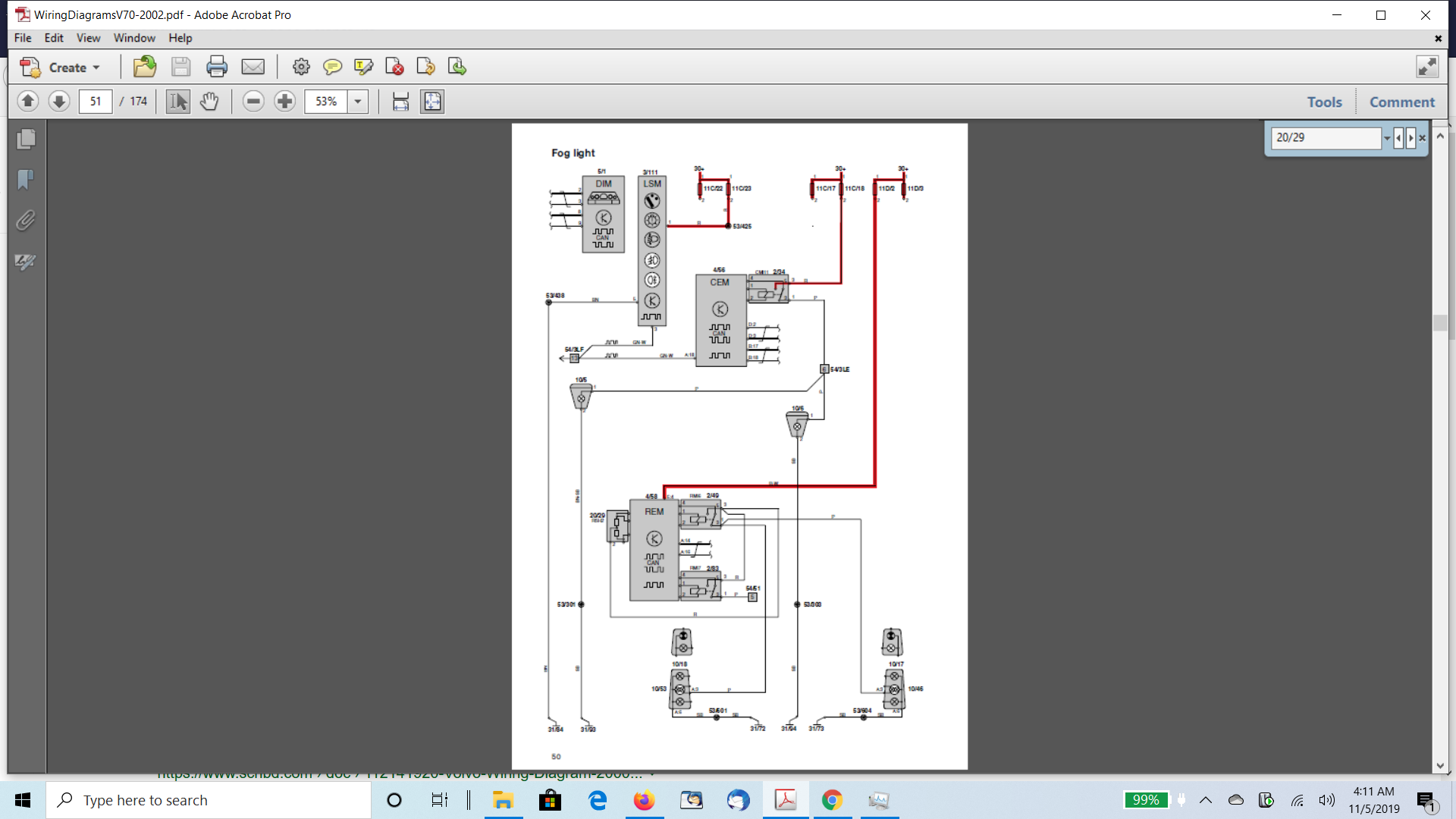

B) I have tried to get what they call the left rear fog light bulb to work again but thus far after buying several bulbs none light up yet. The old burned out bulb is imprinted with a "7506" on it and the last bulb I bought was a "1156" which is supposed to be the same bulb. Is my bulb holder shot or hopefully it is not the flexible mylar circuit board.

10/53 Rear Fog, Left

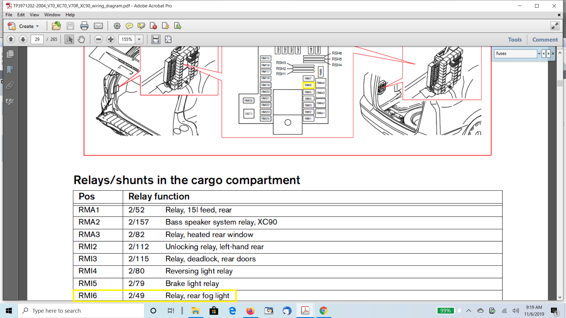

2/49 Relay, Rear Fog
20/29 Shunt, Fog Light REM.

I would check relay 2/49. Find a point where the circuit is working then work down stream from there.
Put your finger on 2/49 (Rear Fog Light Relay) have somebody switch the rear Fog Light on and off. Is the Relay clicking?
