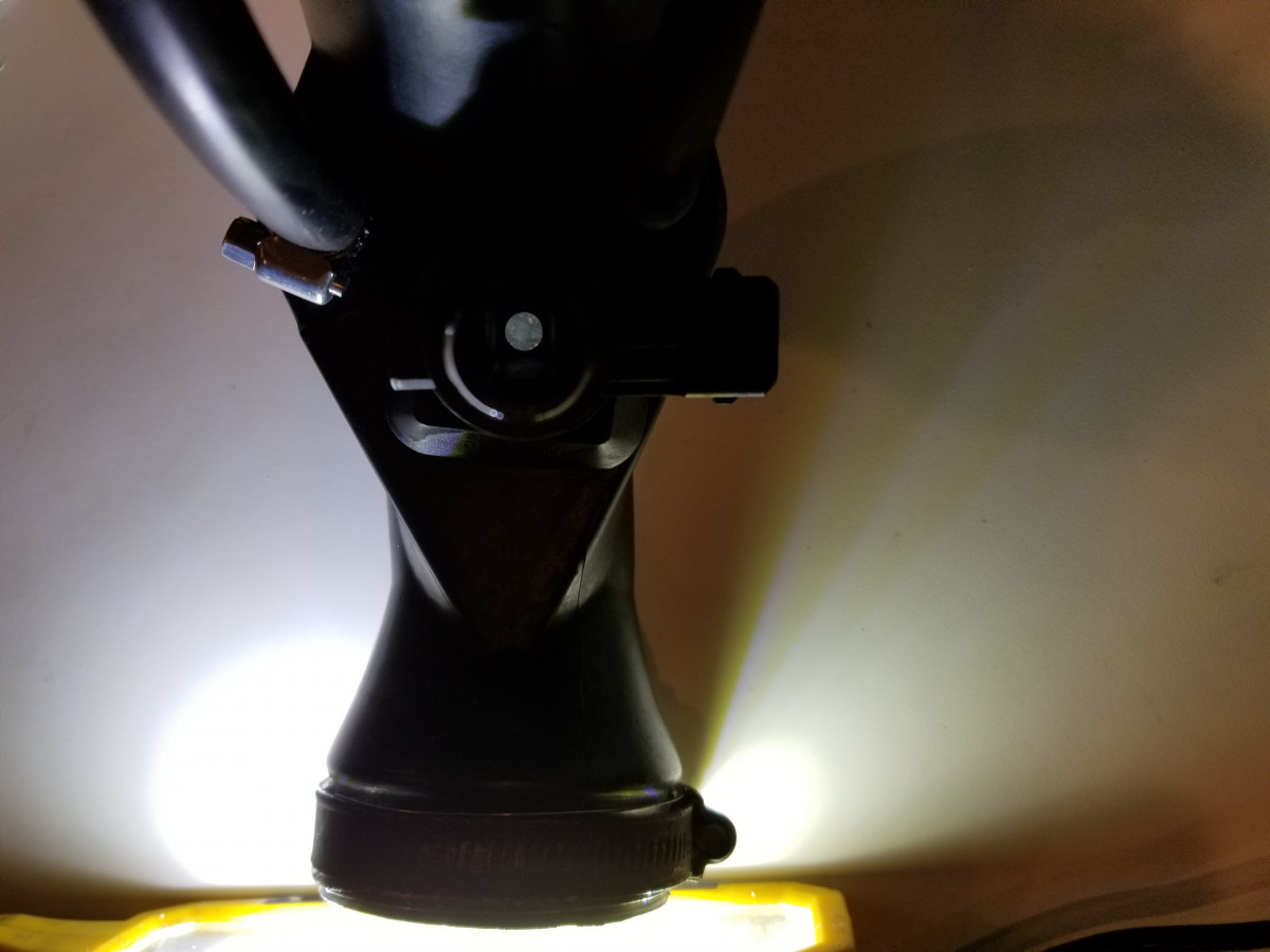

I've attached a photo of the intake pipe that I obtained from the junkyard. The red pen is pointing to an apparent orifice in the side of the PTC. However, this orifice appears to either be blocked off intentionally or maybe it is clogged. Should this orifice be cleaned out or drilled open? I don't recall there being a hose attached to this orifice, so I'd be concerned about opening it up without having a hose connected to it. I know the other three hoses need to be connected along with the electrical connection.
- Posts: 36147
The PTC is just a hole in a metal plate. The electrical connection heats it to keep it clean of cold crud.
The part where you have your pen needs to be closed, correct.
Did you pull out the PTC orfice and inspect it?
