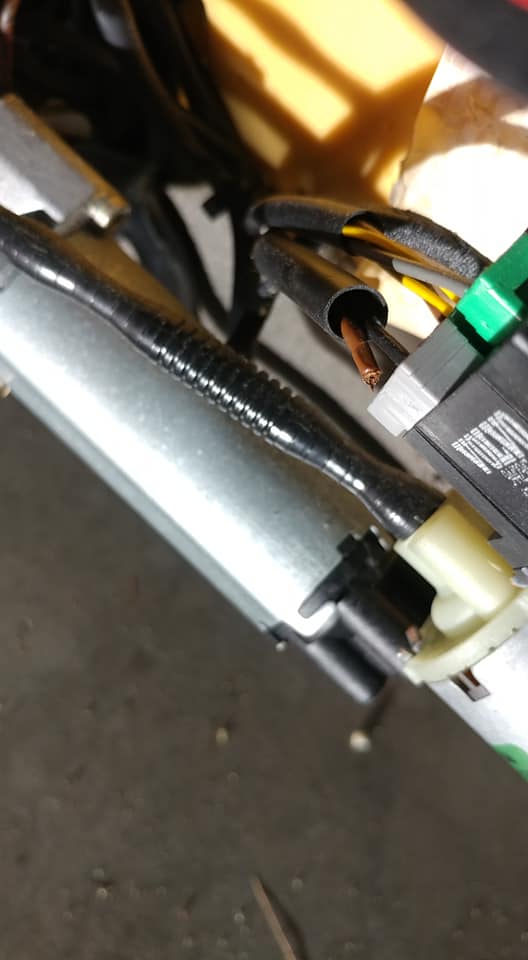

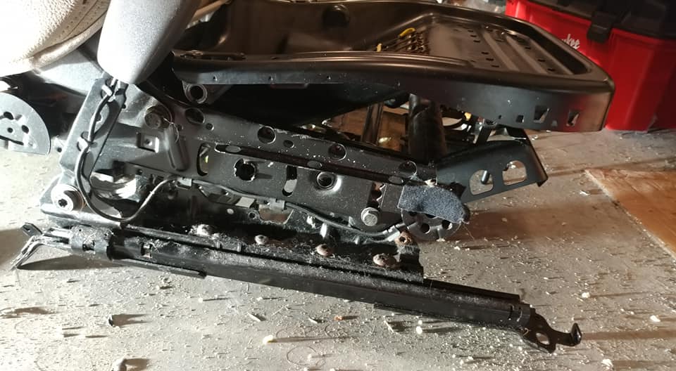

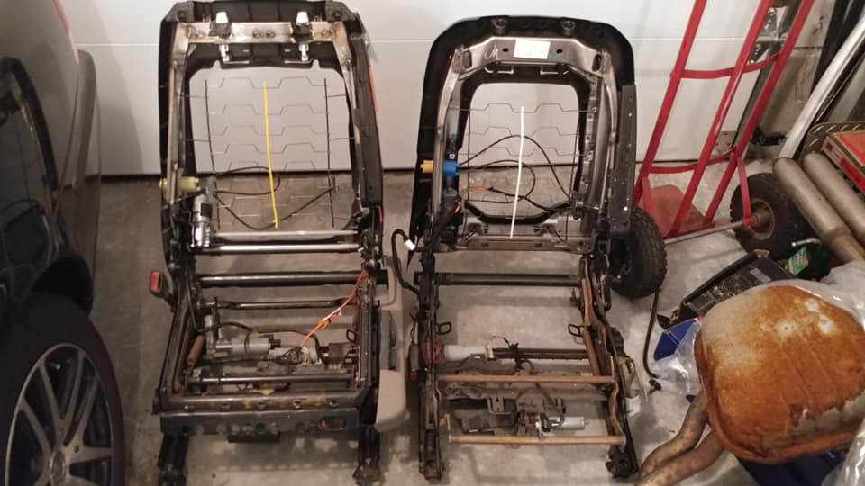

So onto the fact I did this.... I swapped the skin and cushions from an 05 S60R seat to my 03 V70 seat. The seat heaters are the same connectors, which is rather nice, but I had to use the old airbag, and electronics due to the CANBUS on this car.
Not bad once you get in a rhythm, but a bunch doesn't fit the way you'd expect. The back adjustment knob is higher on an 05, so had to cut the leather a little for it to fit the 03. Also you'll have to swap the head rest skins. I haven't yet, but the 03 has a wider footprint then the 05. To remove the head rest, feel at the back of the seat, where the top seam is, like 6 inches above the pocket, and "pop" it. Takes a lot of feeling around, took me a little.
Other things to note, I had to extend the connector for the 05 back heater to hook up as well. I used a grinding wheel, and a drill to level out the seat cushion springs from the 05 for mounting, hence, the self tappers. 05 cushions just clip instead of hog rings.
