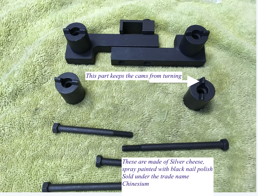

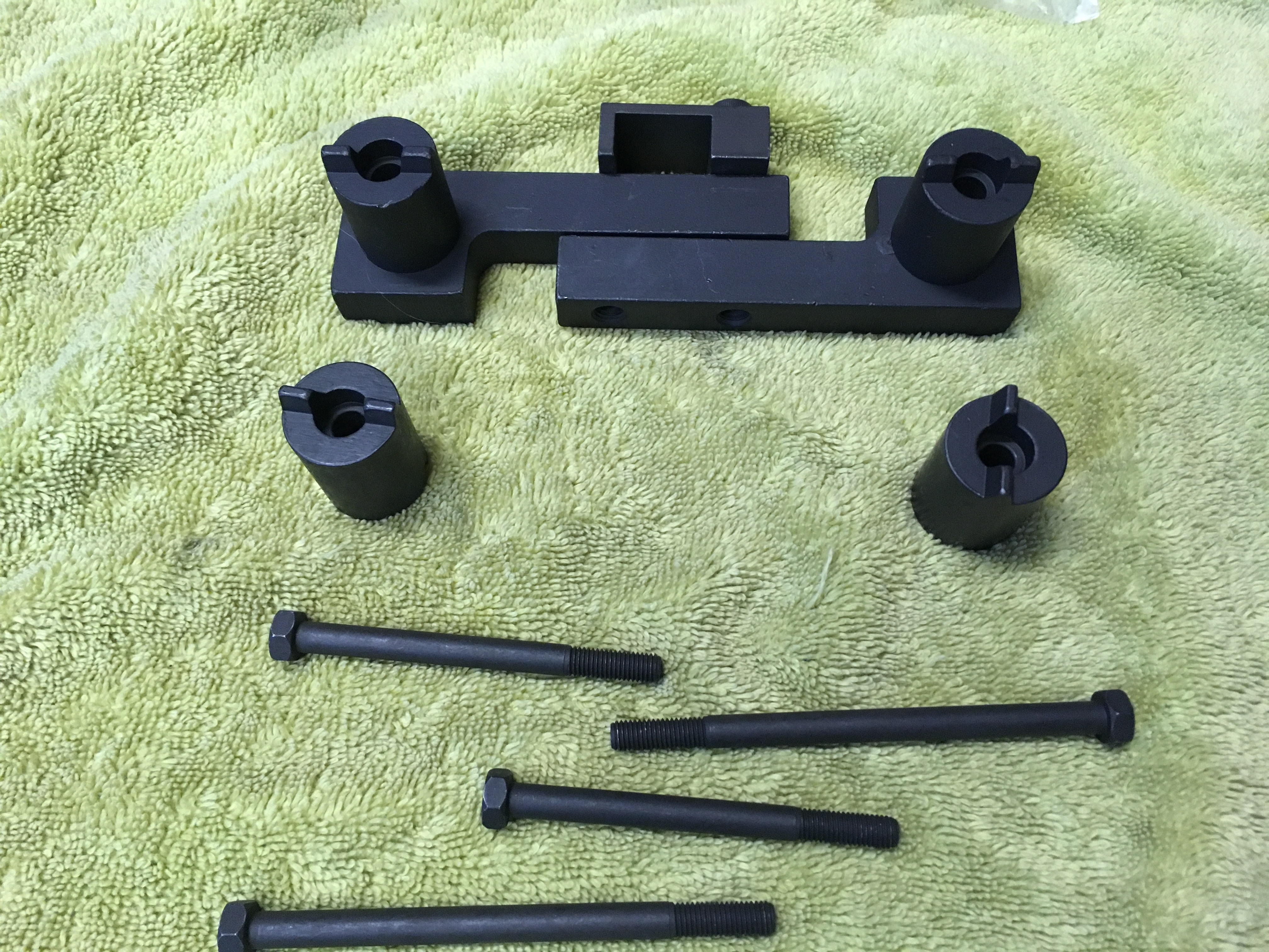

^^ Interesting! I thought I read years ago that the machine shop needs to have the jig to hold the head flat so they can skim it correctly. The reason for all those bolts is because it can move with heat or force. Is this correct?
I didn't need the wing nut tool to press the upper head down. You just get a few of the little bolts started and then gradually walk it down until they're all snug, then torque in the correct pattern.
But the cam lock tool with the teeth that fit into your camshafts is invaluable. Just don't make my mistake and crank the tiny 7mm bolts down and snap one inside the camshaft. They only need to be snug to keep the cams from rotating.
EDIT -
This thing....
EDIT -
This thing....

Just turn those screws finger tight while you hold the cam locks in the right place, no tools.
