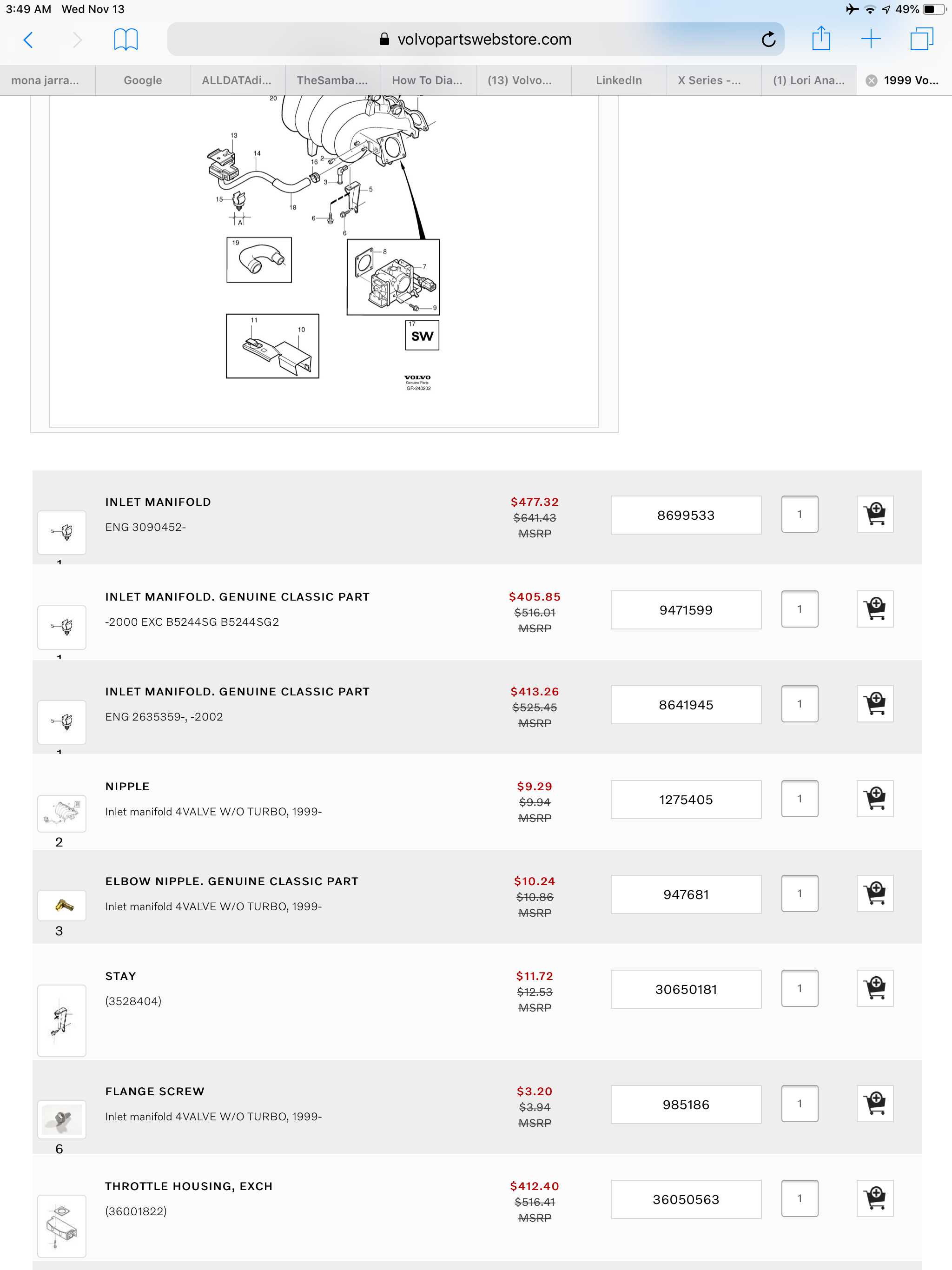

My father has a 1999 V70. It had magneti marelli throttle body, but old has been thrown away. So what is right part number?
1999 V70 2.4 naturally aspirated petrol with automatic gearbox.
1999 V70 NA Which is right throttle body?

Let’s go to Volvo web store
https://www.volvopartswebstore.com/prod ... 43308.html
And enter our year engine model
https://www.volvopartswebstore.com/cars ... parts.html
Choose the right system
Engine >> Inlet Manifold
https://www.volvopartswebstore.com/show ... evel=24667
And , Heureka!
Part 7 is illustrated
You need both the throttle body and software to be right for your car, though. See the forum on this throttle body below
