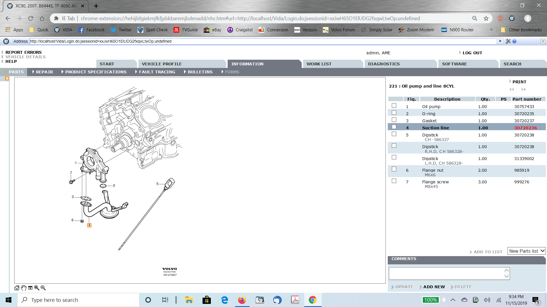

Enter your car info here: https://www.volvowholesalepartsdirect.com/
There are diagrams on the site; you will be able to get all the P/N's for the o-rings etc.

I am also running in to the same problem with my oil pan. I looked at VIDA and seems like a pretty involved work.
I see that the exhaust manifold need to come out sub frame dropped and engine held on hoist.
Does any one know we need to follow all the steps mentioned in VIDA to achieve this or are there any expert shot cut to replace the gaskets/orings.
