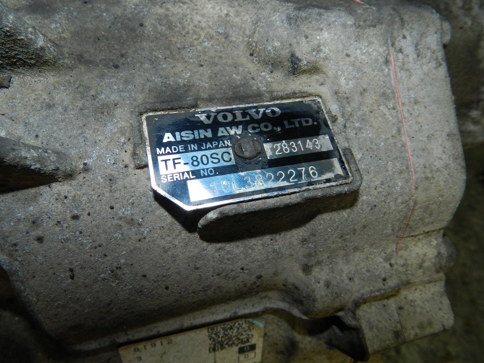

Post by mayfair »
hello again many thanks for your reply it has helped me identify a possible replacement transmission
the plate on the transmission is shown on the photo .................
TF80-SC
1283143
SERIAL NUMBER 10L3822276
can you confirm this is correct for my car ?
many thanks for all of your help
alan
