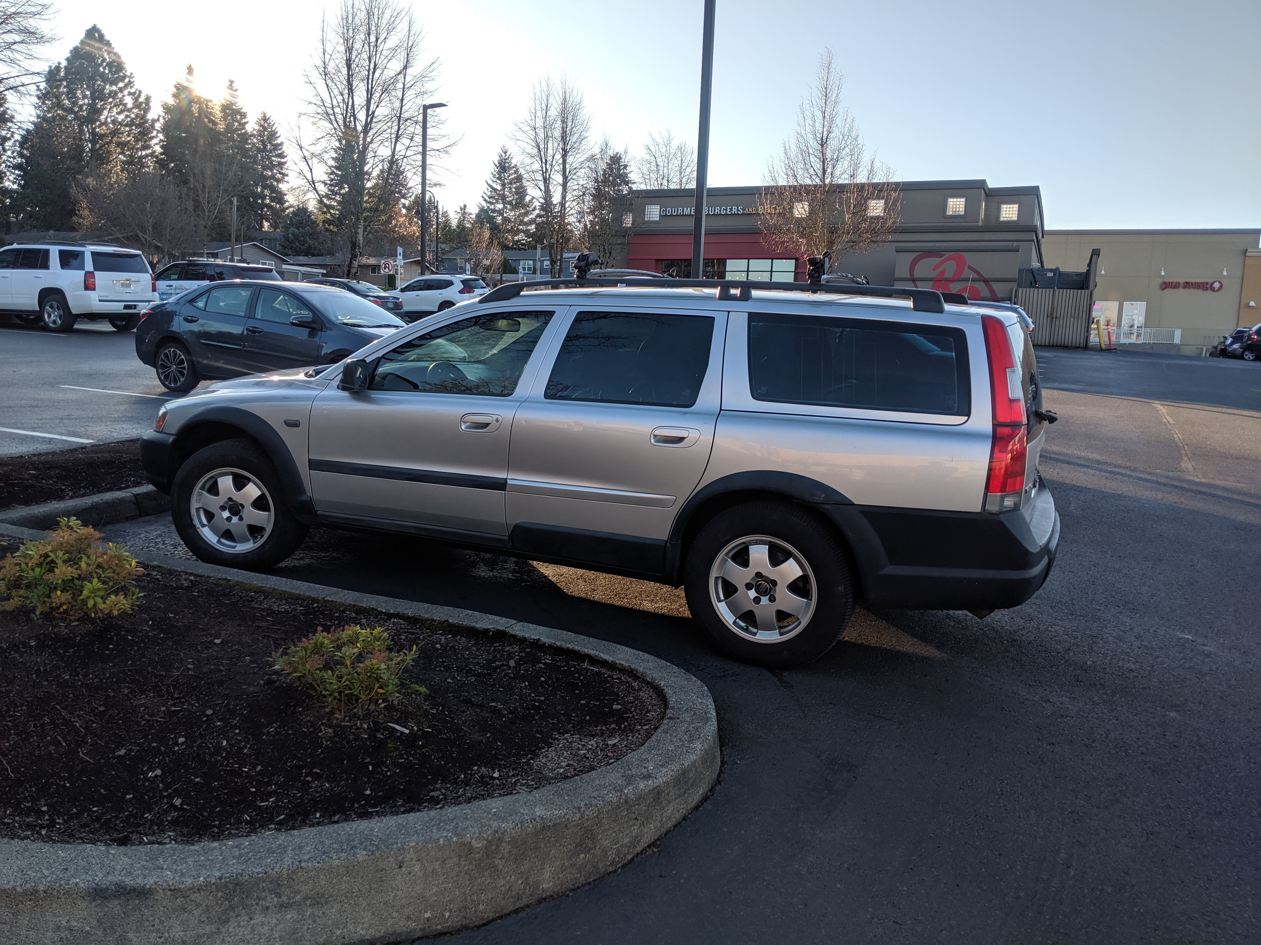

PixelDust wrote: 17 Nov 2019, 19:31
P-2 S-80 Sedan Doors (front, and rear) are compatible with P-2 XC 70 Wagons.
Correction, the rear doors are NOT the same on the S60/S80 vs V70/XC70. Good to edit the comment

Post by PixelDust »
I don't know... The rear doors look like they're exactly the same as well. Here's a photo of the junkyard S-80's door on my XC-70.
