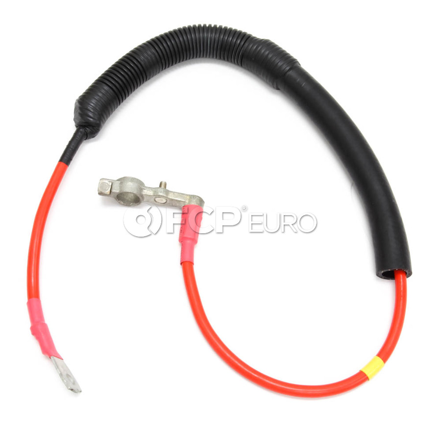

You're correct Misha, the reading at battery cable while idling is 13.5-13.6v, so yes, it is higher than the reading at the cig.lighter.
Unless otherwise, ordering this item https://www.fcpeuro.com/products/volvo- ... 70-9456836

That's what you need.
But you can build your own for about 10-15$...i guess.

Is this FcpEURO cable long enough?
There are 2 more connectors fastened on at the positive red battery connector, assuming one goes to starter.
FROM VIDA:`
Removing the existing cable terminals
Remove the splash guard over the starter motor connections.
Detach the connection at the starter motor/generator.
Cut off the cable terminals on the cable to be replaced. WHAT?
Insulate the ends of the cables with electrical insulation tape. WHAT?
FROM VIDA:`

The positive battery cable on these cars is buried inside the main electrical loom so you can’t really remove th sold one without major surgery. You just leave it in, and it is considered good electrical practice to insulate the ends of dead, unused wires,
Route the new one along the bus, and secure with zip ties every 10-15 cm and when it bends
