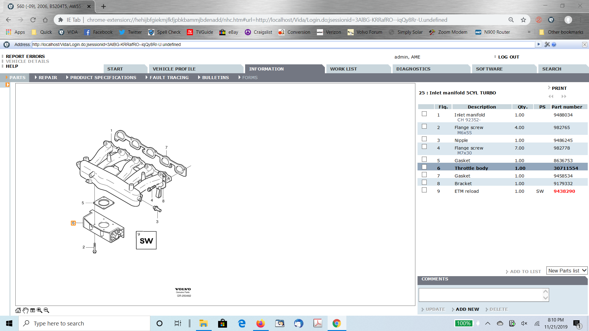

Underside of the intake manifold. Spray Carb cleaner on a rag, prop open butterfly, wipe inside clean.

The 2006 uses the Bosch style throttle body. You can try cleaning it, but from my experience and your description of the problem there's a good chance you'll probably end up replacing it. Either the integrated TPS is bad, or the internal mechanism that opens the throttle plate is worn out. Pressing the pedal down commands the throttle plate to open further overpowering physical sticking that is keeping it from opening the normal opening (smaller amount) during startup.
Also connect it to an OBD diagnostic and make sure the coolant temperature sensor is giving a proper reading for the actual engine temperature. If it's reading hot when it's not you'll usually see cold start issues. But from your description/symptoms my money's on the throttle body.
My bit of advice, if you end up replacing the throttle body I would probably recommend the xemodex 'upgraded' unit where they've modified these with a contactless throttle position sensor. PN VO.1020.30711554H.00.20 If you buy one from Volvo/Bosch you'll get one with TPS that uses a set of mechanical sweeps like the original.
