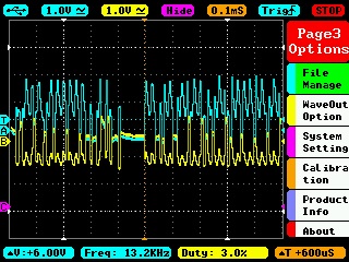

Bought a cheapo oscilloscope and tapped channel A into CAN H and channel B into CAN L with both referencing ground. The network looks good,
until for no rhyme or reason, the BRAKE FAIL message appears on the DIM, and the network goes haywire.

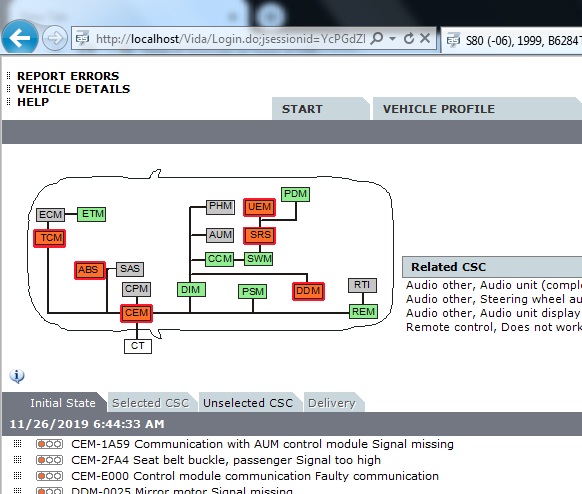

When the network is in a fail state, Vida codes show a slew of CEM, DDM, TCM, SRS, ABS faults.
When the network is in a good, non corrupted state I can clear down to:
CEM-1A59 Com w/ AUM control signal missing (I have an aftermarket stereo installed, so this makes sense)
DDM-0025 Mirror motor signal missing
SRS-0034 SIPS left front resistance high
SRS-00D1 Seat buckle, passenger signal missing
SRS-0115 Control module internal fault
SRS-E03 Configuration fault

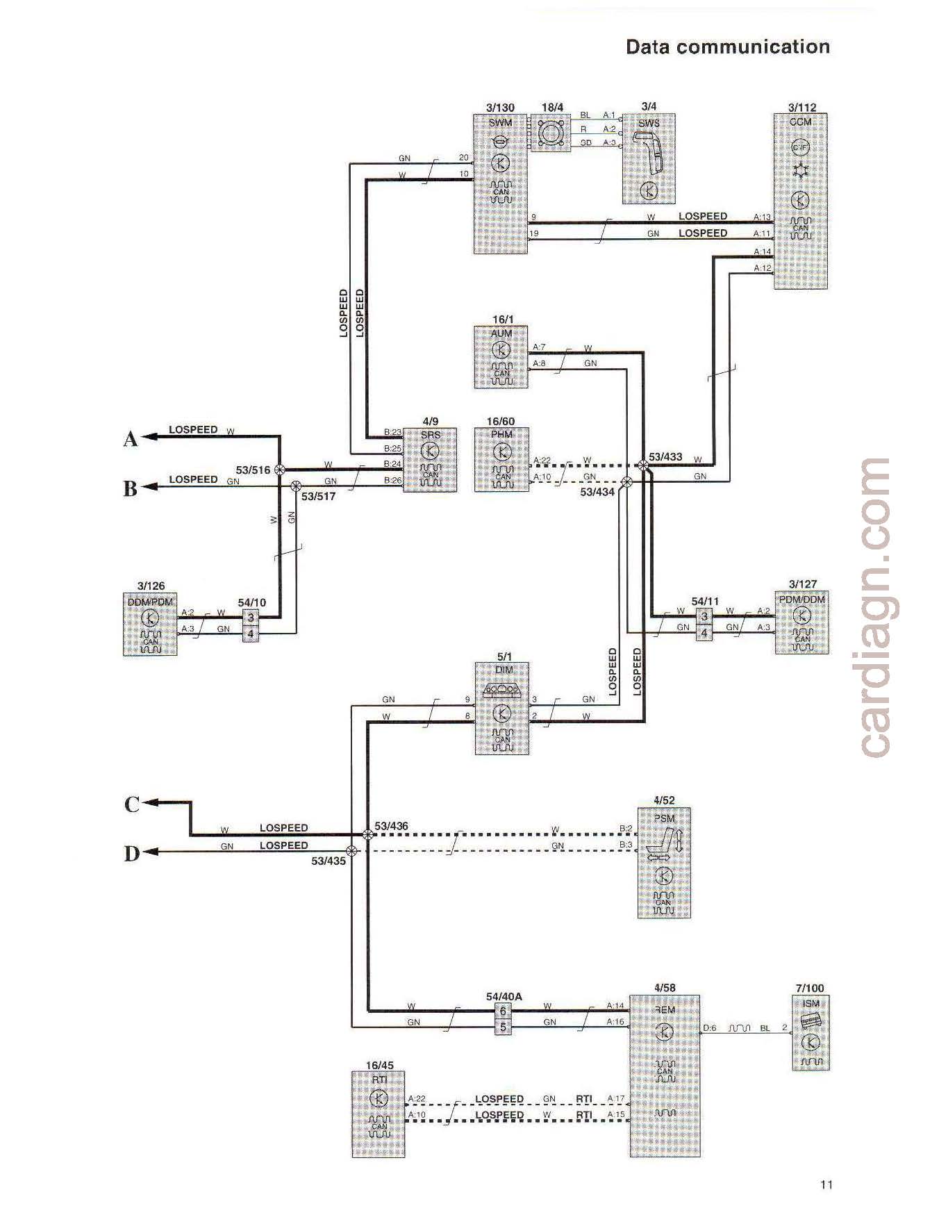

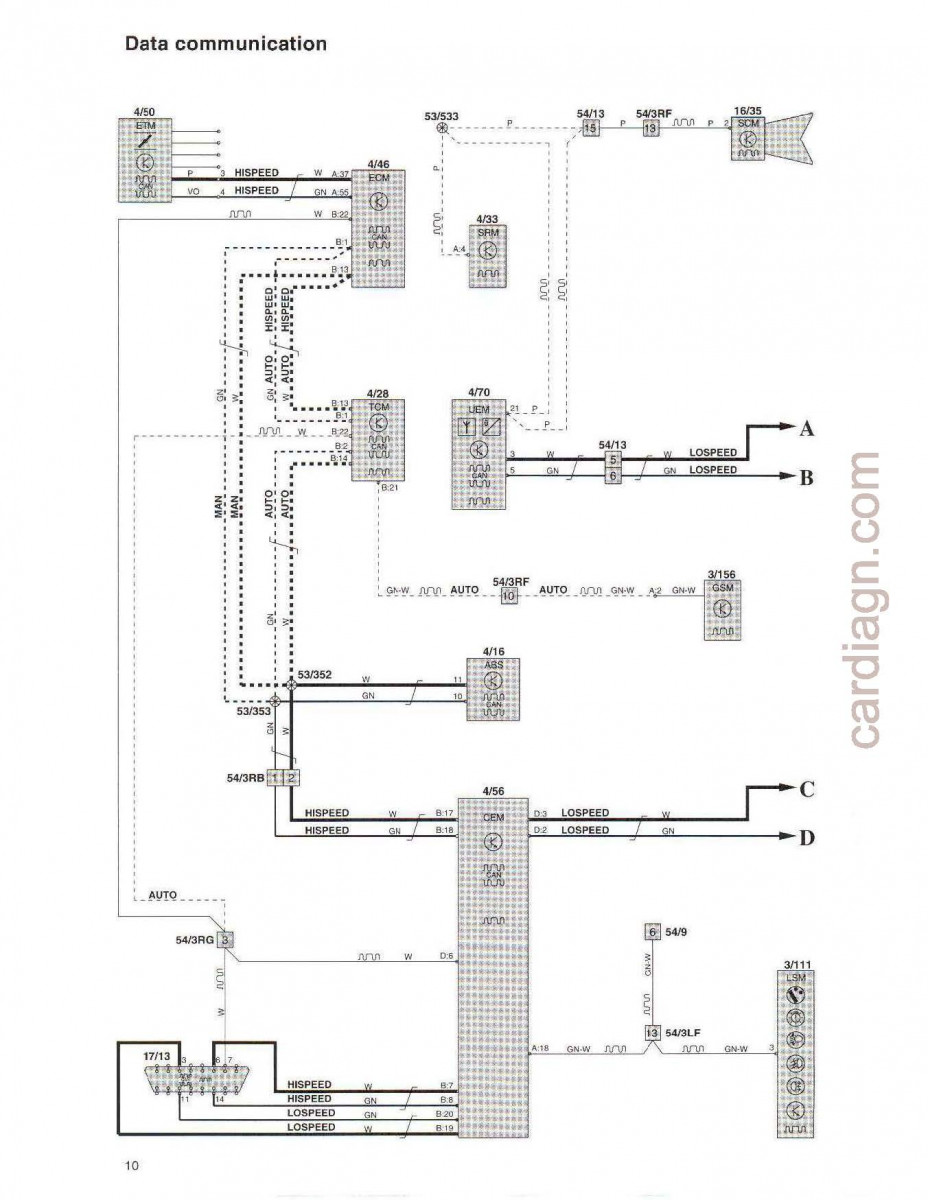

B+ is the wire from the Alternator (+) to the Battery (+).
Look at the wiring diagram for the Data Communication below.
See the two sets of High and Low CAN bus attached to the CEM.
There is a 5th CAN bus from CEM pin D:6 to the ECM & TCM.
There is a 6th CAN bus from CEM pin A:18 to the LSM.
There are more CAN buses other then the 6 listed above.
The Electrical Wiring Diagram (EWD) for the 1999 S80 is Volvo TP3939202, Google it, there is a free downloadable copy out there.

I sourced a TP3939202 pdf, that's exactly what I needed, thank you.
Looking at the drawings, I am currently on the lo speed bus when seeing this corruption. I'll swing the scope over to B+ this morning once it fails and see what the alternator is up to.
If a lo speed module fails, say the DDM, can it cause all this havoc on the hi speed bus as well, or are they electrically isolated?
That wraparound wire from D:6 on the CEM to B:22 on TCM (my s80 is auto trans) throws me right off as well... same as A:18

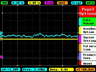

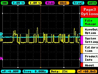

Ok, car has been sitting overnight, it started fine but within seconds BRAKE FAIL appeared.
I put the scope on the CANH side of the LO SPEED bus via the AUM plug, and the familiar corrupted waveform was shown. I swung channel A from the oscilloscope onto the positive battery post under the hood (which comes from the alternator, on its way to the battery in the trunk) and it looks rather stable, both probes are on 1.0v on the scope, (Channel B is CANH on LO SPEED at AUM):
Here is a close up of the B+ only at 0.2v divisions:
Using a fluke multimeter a 14.1vdc is shown constant.

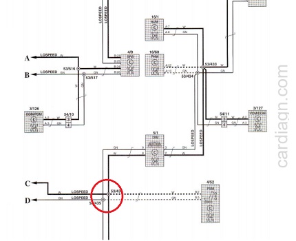

Using the wiring diagrams (thanks RickHaleParker) I traced out the junction point 53/435 - 53/436 and soldered over the mechanical crimp, no change. I cannot find this physical joint on the high speed bus though, between the CEM and the ABS module 53/353 - 53/352.... does anybody know where to look for this? Which side of the firewall does it hide?

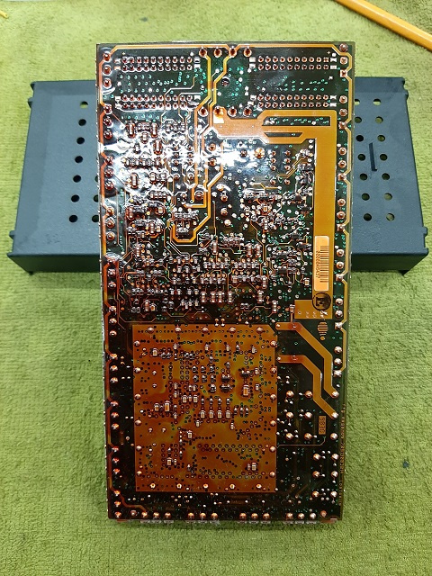

Since I had the CEM down and out I figured I'd pop it open and look for any physical water damage or a cold solder on the connector pins, there was nothing obvious so I put it all back together and reconnected the battery. The network stayed true for a few minutes then started peaking out again. While driving and watching the scope, it cleared up after a few minutes so I pulled over and restarted the car, it was fine for a few minutes then got garbled yet again. It's odd that the network was able to recover but then crap out again mid-flight.
