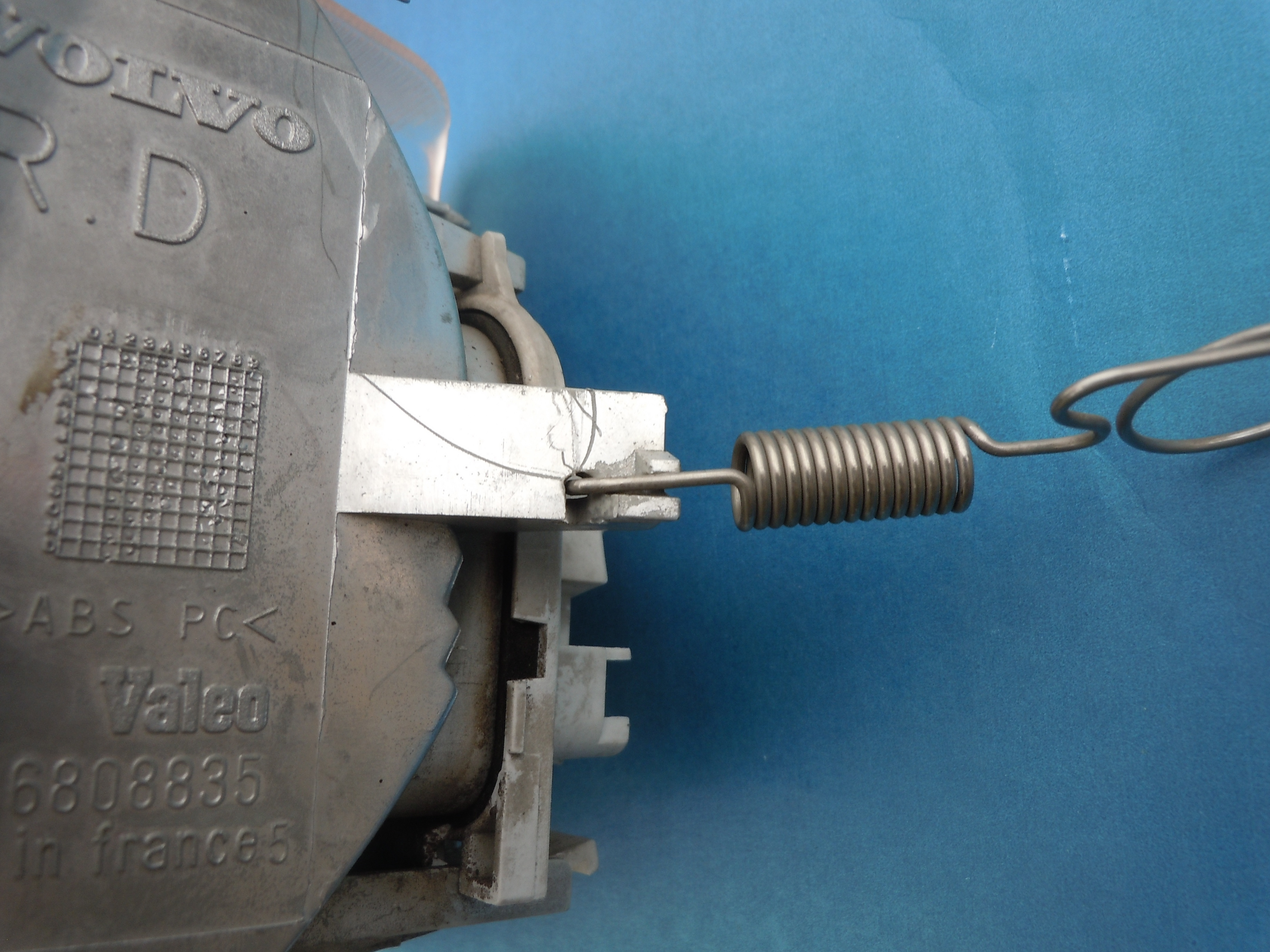

The spring that holds in the light assembly is pretty strong (it connects to a lug formed into the signal lamp housing). But you can stretch it a little by using your finger tips to lift the lens forward from where it meets the fender.
Here's a picture of the spring where it attaches to a lug formed into the signal lamp housing:
Then you need to clip the spring. Using a tool such as:

Those springs are available online for $6+. You might not even need to buy a new one if you clip as close to the plastic lug as possible, leaving some straight spring lead. Then use a stout needle nose pliers to bend a new hook at the end. Using some stiff wire you can make a small ring to reconnect the spring hook to the plastic lug. Worst case scenario: The plastic lug on the lamp housing breaks and you need to replace it. They're available online; not very expensive. I've found good ones at the junk yard. So destruction and repair costs are still minimal if something breaks.

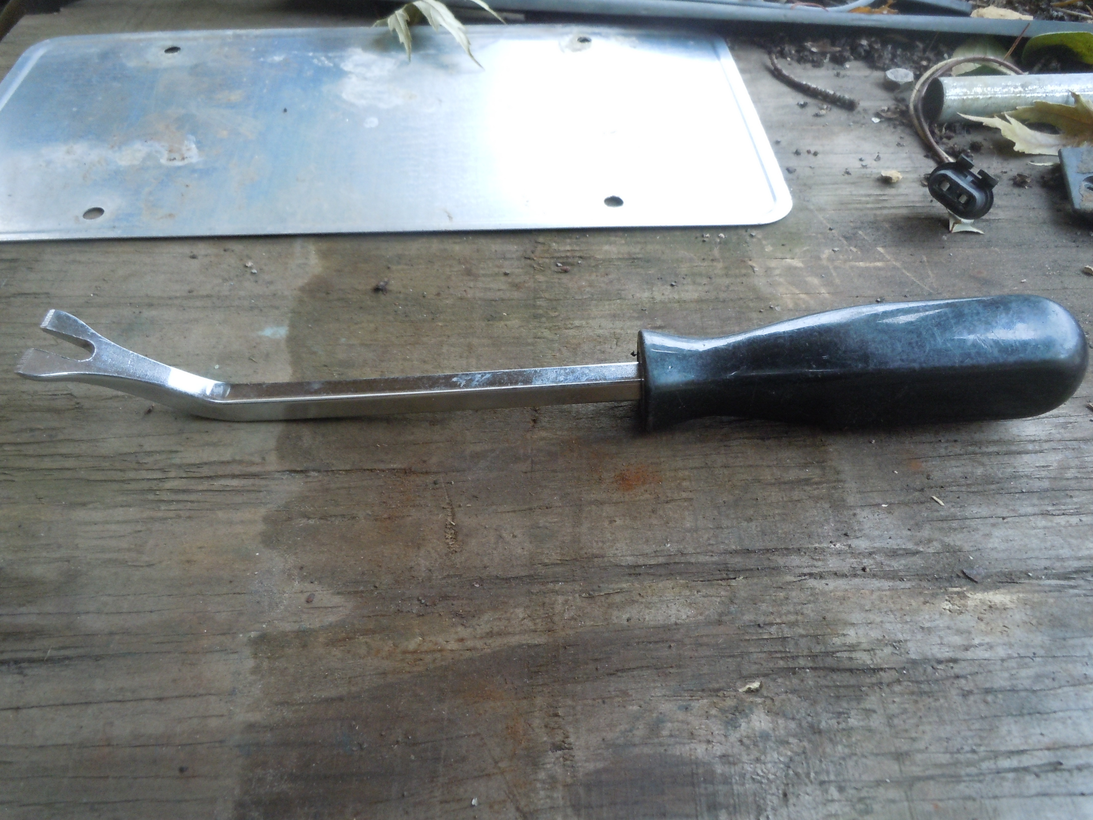

I have a tool that I think I bought at HF, but don't see it currently on their site.
The tool I have:
The shank of the tool you use needs to be stout enough that you can pry against the side of the hole the spring goes through—and long enough that you can get some leverage.
Facing the front of the car, you angle the tool slightly upward and to the right (you're actually pushing your tool handle to the left but probing up to the right. You can feel the right side lever and get the end opening of the tool around the lever to force it slightly down and towards the oil dipstick. It will help if you press down on the hood above the latch to ease the release. One person can do all that.

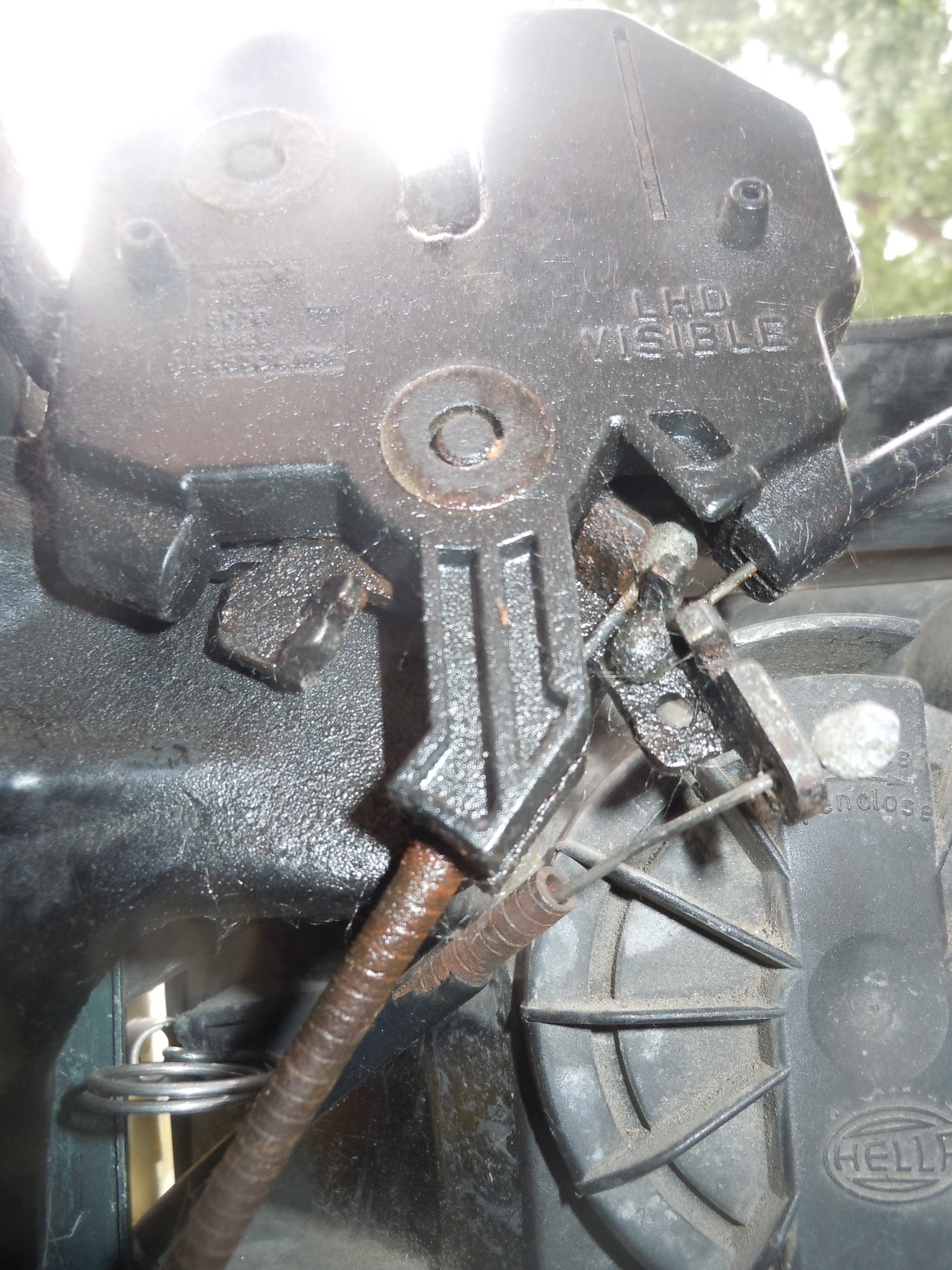

Here's a picture of the US left side latch.
The three cable ends in this picture are upper right cable that goes across to the right side latch; the downward leading cable is the main cable; the third one that crosses behind the main cable is my safety cable that threads down through a hole beside the headlight to a point just in front of the lower cross member.
Notice the notch in the lever. The trick is to catch a wire "snare" in that notch, then pull the wire sharply while pressing firmly down on the hood above the latch. I would grab the wire with a vicegrip for a good grasp and pull force.

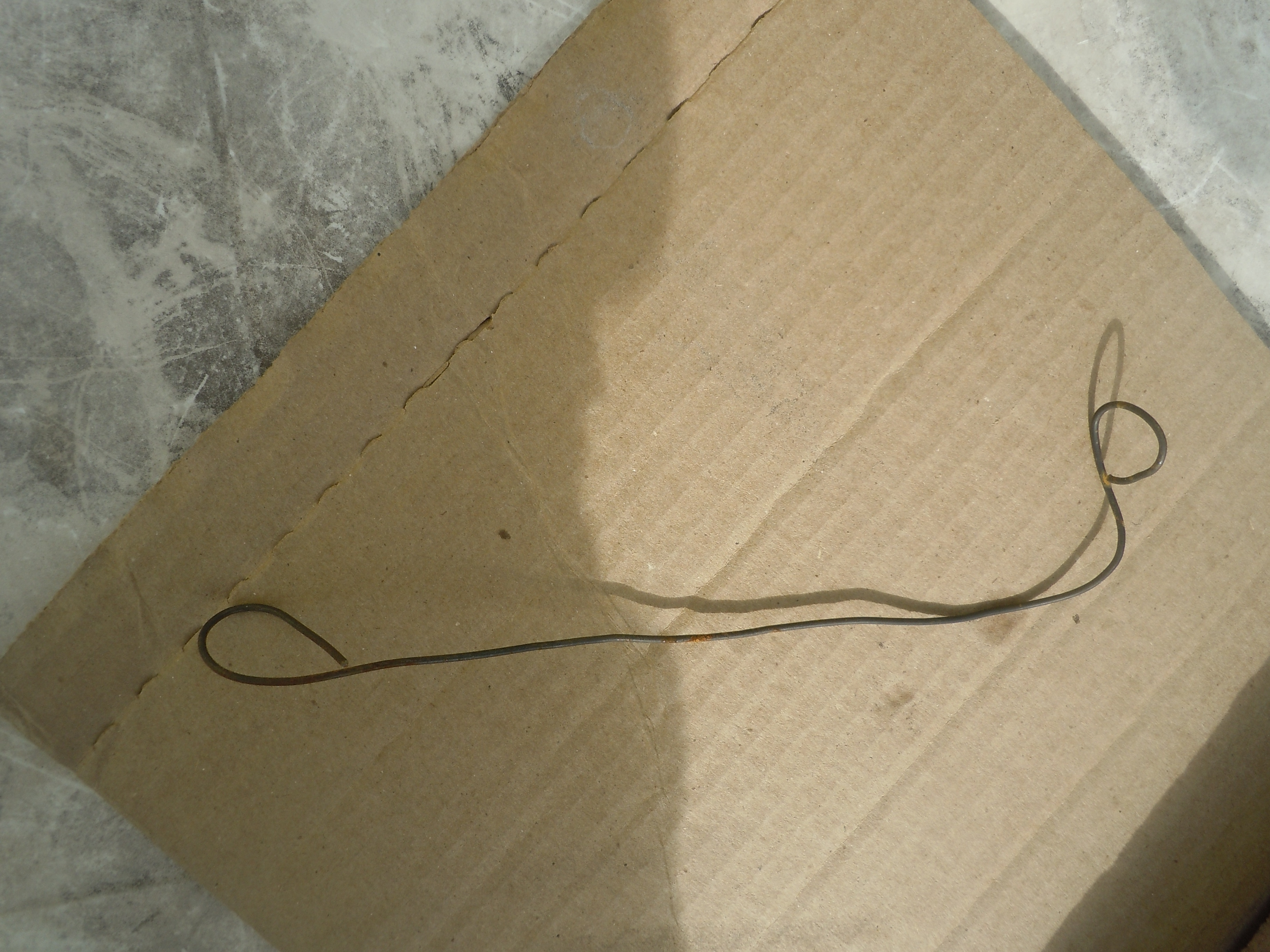

Draft wire snare (note the snare end orients upward, 90 degrees from the background):
If you have installed a safety cable you'll probably never have to go through this procedure. Imagine your latch assembly without the 3rd safety cable "in the way" of a wire snare like mine is. Then, knowing where to "fish" your snare to loop the end around the trip lever (ideally catching the snare loop in the lever's notch), is really 90% of the solution. You can see the finger loop end of the spring—that's where your snare would be coming in. Then it would be angled in front of the main hood cable. Then once you've passed in front of the main hood cable, the snare loop angles upward and slightly to the right (looking from inside the cabin). From there, "feeling" around for the latch lever, you'll find it. Snare and pull.
I crafted the "left side latch snare and trip tool" from relatively thin wire to show what would be used to get at the left side. See photo. Stiffer wire and the end wound around to secure the loop would work better. Better yet solder the end.

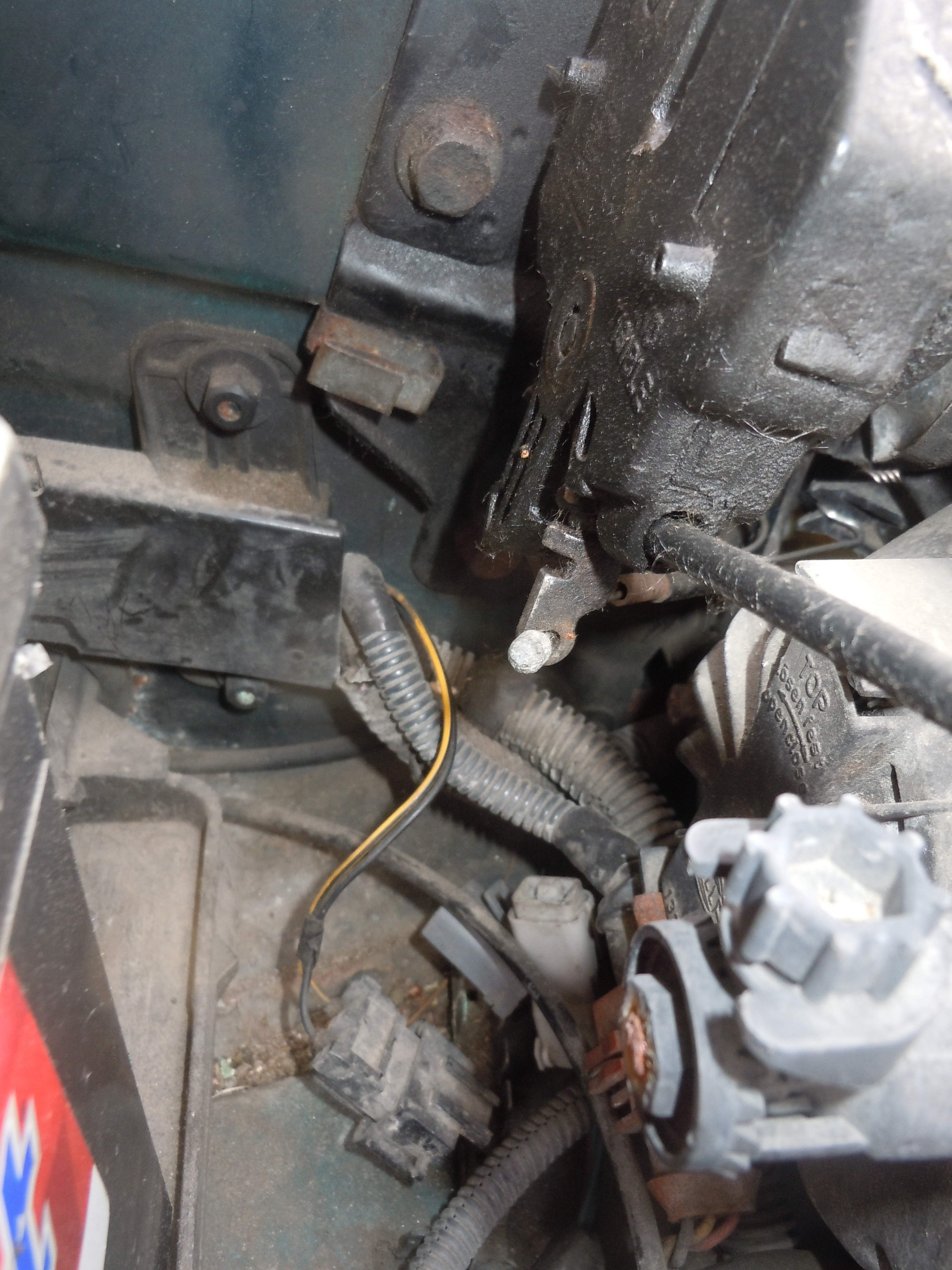

Main challenge: You need to know where to probe. Since this is a challenge project, maybe others can take a couple of pics to help orient a novice to the right location.
Another "downward" view of the US left side latch—clearly shows the lever with notch you want to catch the snare loop in.
