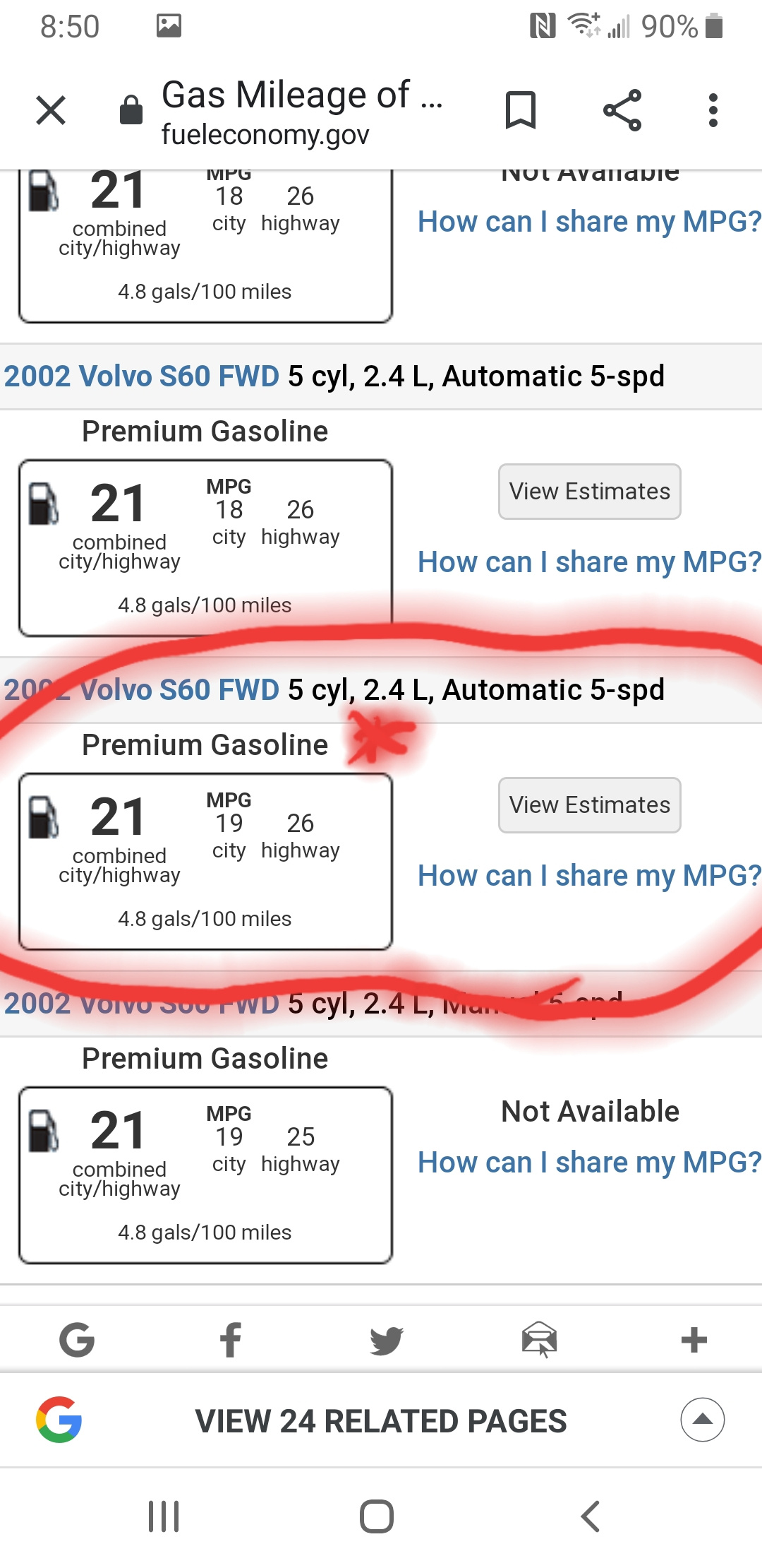

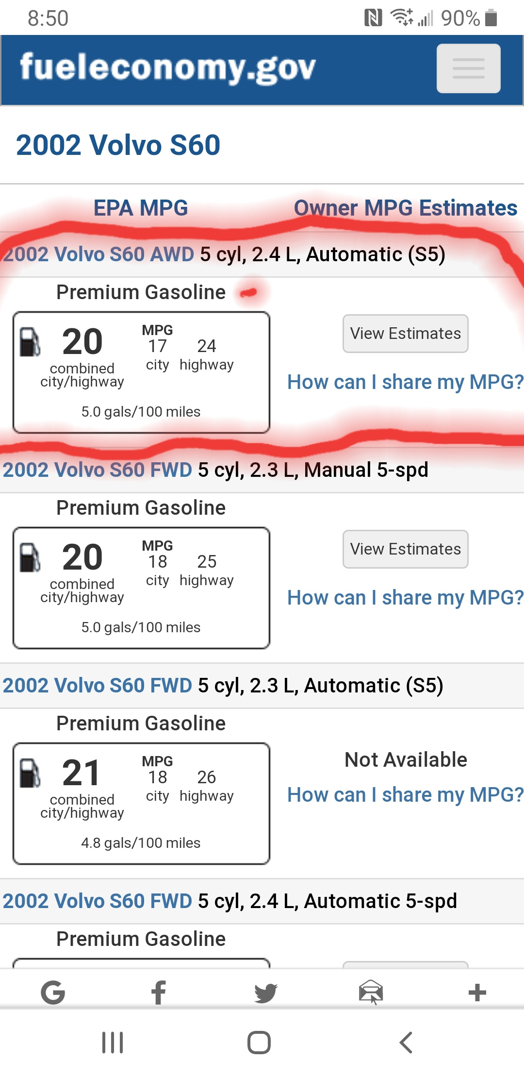

Here are screenshots of mpg. One circled is AWD 2.4 automatic other pic is FWD 2.4 automatic. Notice on Premium fuel specified. June
