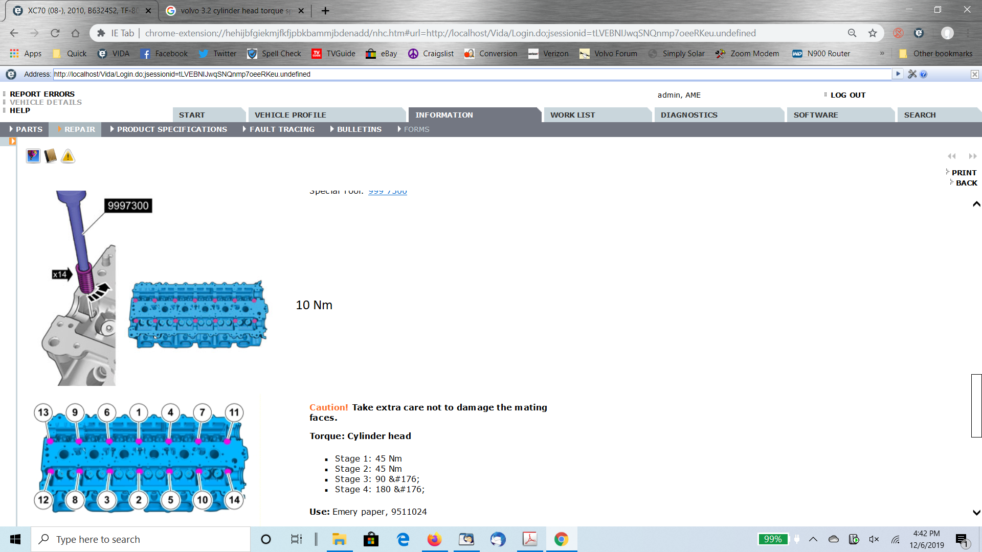

3.2 XC70 head tightening torque?
Hi all, new member here... I have a 2010 XC70 3.2 six cylinder non-turbo with a blown head gasket. Have removed head, had it re-surfaced, bought gaskets, bolts and timing gear special tools, but I can't find anywhere online where the head bolt tightening sequence, torque and final (tightening angle?) are available... I would like to get this job done this weekend if possible!!! Any help would be much appreciated..

Pass 1. Bolts 1-14 45 Nm
Pass 2. Bolts 1-14 45 Nm (again)
Pass 3. Bolts 1-14 45 90°
Pass 4. Bolts 1-14 45 180°

RickHaleParker wrote: 06 Dec 2019, 15:53 Pass 1. Bolts 1-14 45 Nm
