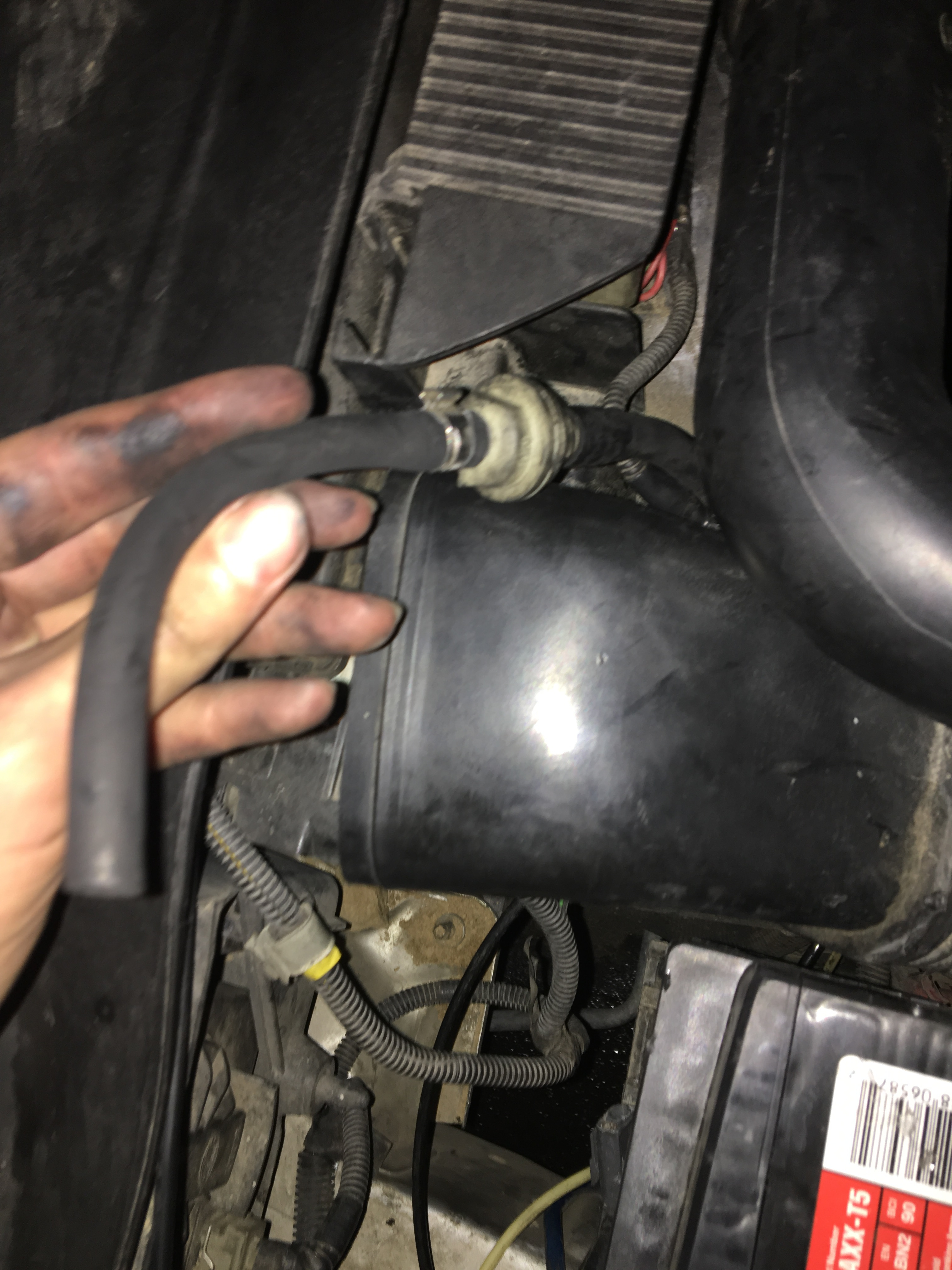

97 850 T-5 here, I have a troublesome strand of issues that I assume are related. First off, I’m getting two codes: P0440 and P0172, and I have a mystery hose that I assume is apart of the EVAP system that I cannot seem to figure out. It’s sitting on the drivers side of the fan shroud and is hooked up to nothing (see photo, and I have honestly no clue where it’s home is. Also my idle is around 950-1100. I’ve tried taking apart and cleaning the MAF with no luck, and I just did the complete pcv system replacement (cel lights were on beforehand), and my average gas mileage will suddenly drop to around 12-13 for no apparent reason and then go back to normal after a day or so. I’ve also had what sounds to be an air hiss that I can mainly hear when the hood of the car is down, it seems to be coming from around the battery/driver wheel area that I can’t figure out (and no it’s not the mystery hose, the sound remains even when the hose is plugged). Any advice would be much appreciated, since I don’t have money to just throw at new 02 sensors and MAF’s.
Can you check the canister purge valve near the fan shroud. There should be 2 connections to it- one coming from under the car ( from the charcoal canister) and other going to air intake near the MAF sensor. It could be that one of those has come off. The size of the hose gives an impression that it is an EVAP hose.

The one coming from the underside of the car is connected, and the hose I’m holding is the one that is coming out of the other side of the purge valve. So does that mean this hose routes all the way to the air intake? If so I’ll have to get some more hose, this one won’t reach near that far. Also it’s probably worth mentioning the guy i bought the car from said he had a new engine put in after the previous one quit, and it seems like the mechanic who did it didn’t quite put everything back together correctly, or the new engine and it’s components weren’t compatible with some aspects of the car so he just had to “make do”.

So I figured it out somehow. The cruise control vacuum hose was hooked up to the evap purge valve and then led to nothing, and the hose that was supposed to be hooked up to the purge valve was plugged into the intake manifold. So I unplugged the cruise control hose and plugged it into the the cruise control nipple under the battery, and took the evap hose that was connected to the manifold and plugged that up to the evap purge valve (where the cruise control line was) and then plugged that up to the intake manifold. It’s now idling at about 850 rpms, not 1100. Gonna check my codes in a bit

Hose from purge valve goes to metal nipple at intake manifold...that's correct routine.
Remove negative battery terminal for about 10-15 min in order to clear the codes and reset fuel trims.
Then....do a re-learning procedure for ecu and see which codes are coming back.

On a turbo car there are two suction routes from the purge valve to the engine
One runs to the intake manifold, the other to the intake snorkel just in front of the turbo. By front, I mean the air path front, not the location.
There is a check valve in each path after the T connection
