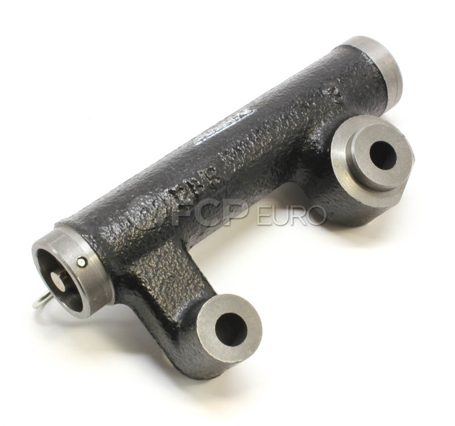

1998 is the year Volvo switched from a hydraulic tensioner to mechanical tensioner. You could have either one. You need to get the engine serial number off the block or look at the tensioner to see if it is hydraulic or mechanical. Each one uses a different timing belt.
Engine serial number 1266127 or lower = hydraulic.
Engine serial number 1266128 or higher = mechanical.
Hydraulic tensioner.
Mechanical tensioner.
