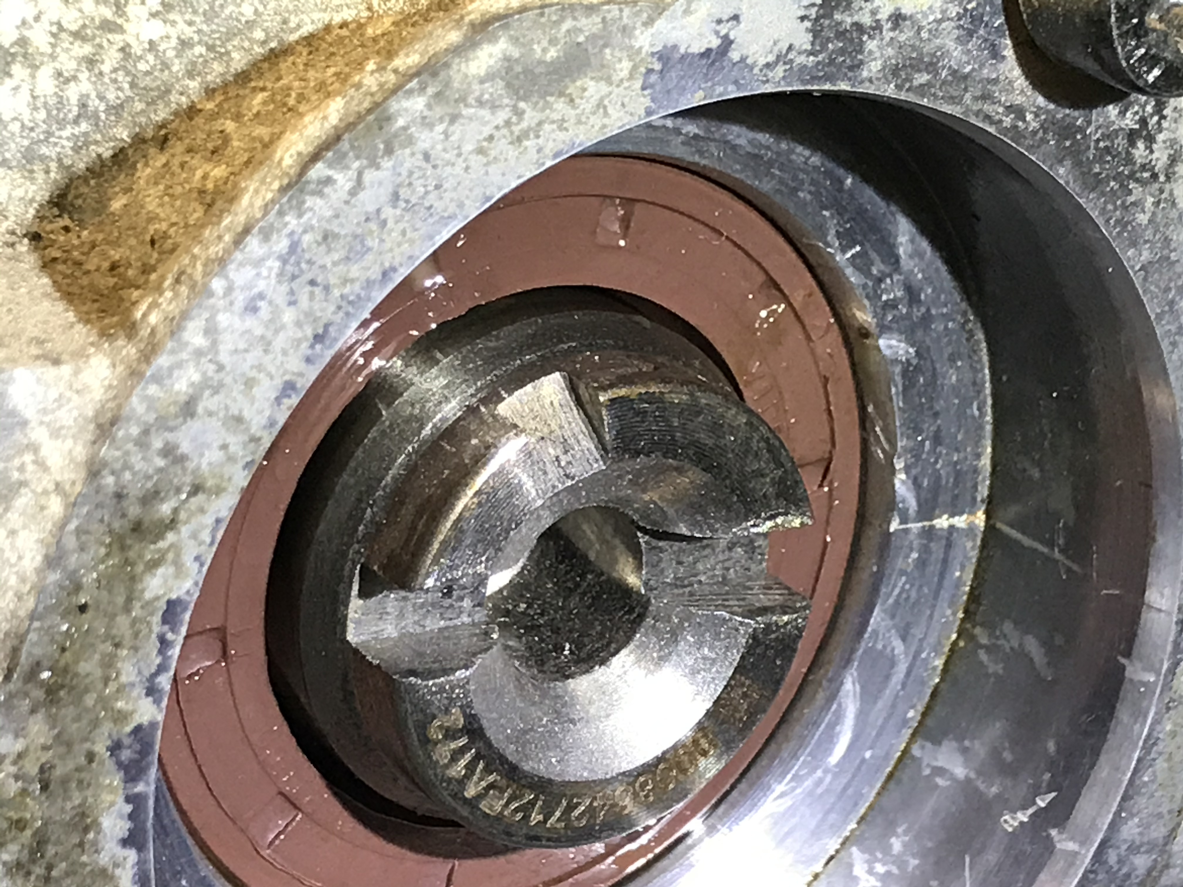

Anatomy: First off, these are NOT as pictured on FCP's site. They are exactly as I have shown in pictures, which to me is just fine as it looks identical to what came out of the head. “Ribbed” outer sealing surface, angular ribs on the ID that direct oil back into the head. Elring seal is identical to seal that came out of head. I believe the cam seals were replaced once around 120k on this engine, so I do not know if they used Volvo or Elring seals at that time.
Based on the measurements, the overall design & construction, and the fact that identical seals were there previously, I would have to say that Elring seals are superior over Corteco on the rear of the cams. I’m sure both are fine though. I used one of each, to see which gives up an oil leak first. I ordered both Corteco & Elring seals for the front of the head also but ignorantly didn’t compare the two or take measurements so I will update this when I have specs for both (updated). The reason I neglected to compare the two for the front cam seals is everything I’ve read on the forums said, unanimously, to use Corteco as the Elring seals have been shown to run small or leak early etc, something along those lines.
Other notes:
Take care with your rear cam ends where the cam locking tool goes. Measure the nubs that go into the cam slots & profile them down if necessary. My intake cam cracked simply with having the cam locking tool installed. Also noteworthy - both cam slots were left bruised from the cam locking tool.
Overall I was actually impressed with how relatively easy the entire task of replacing VVT hubs, cam/crank seals etc was. It’s really no different than retiming one of these if your timing is off, or even just doing a timing belt et.al. It’s far more daunting to just continue reading and re-reading about people’s horror stories & all the confusing steps Volvo has. Getting over the cost of the hubs was the hardest thing for me. The labor was enjoyable, but time consuming.
Lastly, I was concerned about setting the depth of the rear cam seals. As it turned out, the ones that came out of the head had been seated all the way in. After painstakingly setting the exhaust seal to what I thought was the exact same depth as the seal that was previously there, I had a thought that it (depth) didn’t matter. As a test I put the intake rear seal in all the way til it stopped. Lo & behold it was the exact same depth as the previous seal. So long story short, I just smacked both seals in all the way & have zero leaks.
