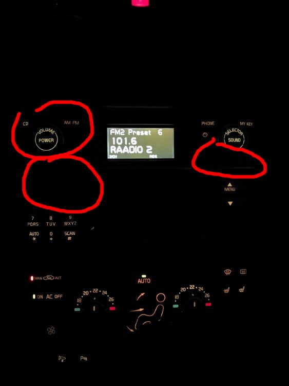

Some bulbs of central console buttons backlight are dead so I would like to replace them.
From internet search I've found controversial info about bulbs.
Can anyone confirm what are the correct bulb types for button background light?
XC90 central console backlight bulb type?

Volvo Part Number 30739358. I'm pretty sure it is a standard T3 Neo wedge, which you can get on eBay dirt cheap. Way way less the $8.36 a bulb for genuine Volvo.
For less then the price of one Volvo bulb you can get a packet of 20 bulbs .... you could even switch to a LED color of your choice.
