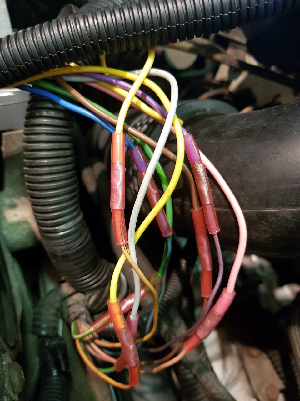

I bought a part of wire harness that needs splicing and crimping.
1/10th of the original harness price, shipped.

mirage
Re: sparkplug coil plug.replacement
Post by mirage » Thu Jan 09, 2020 5:37 am
looks good
