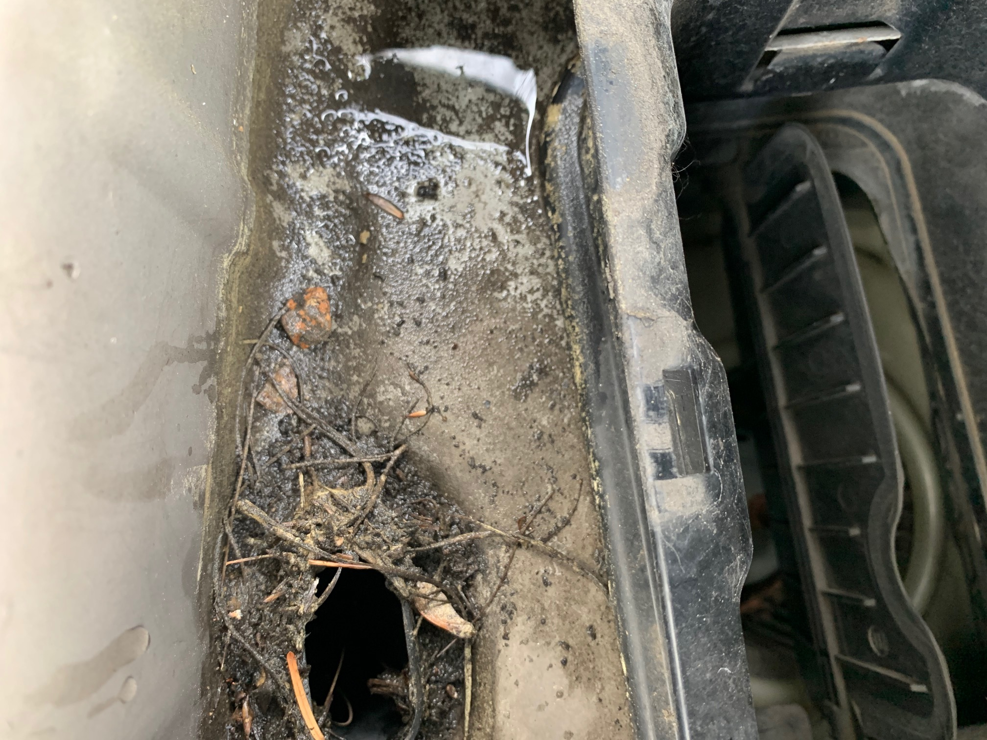

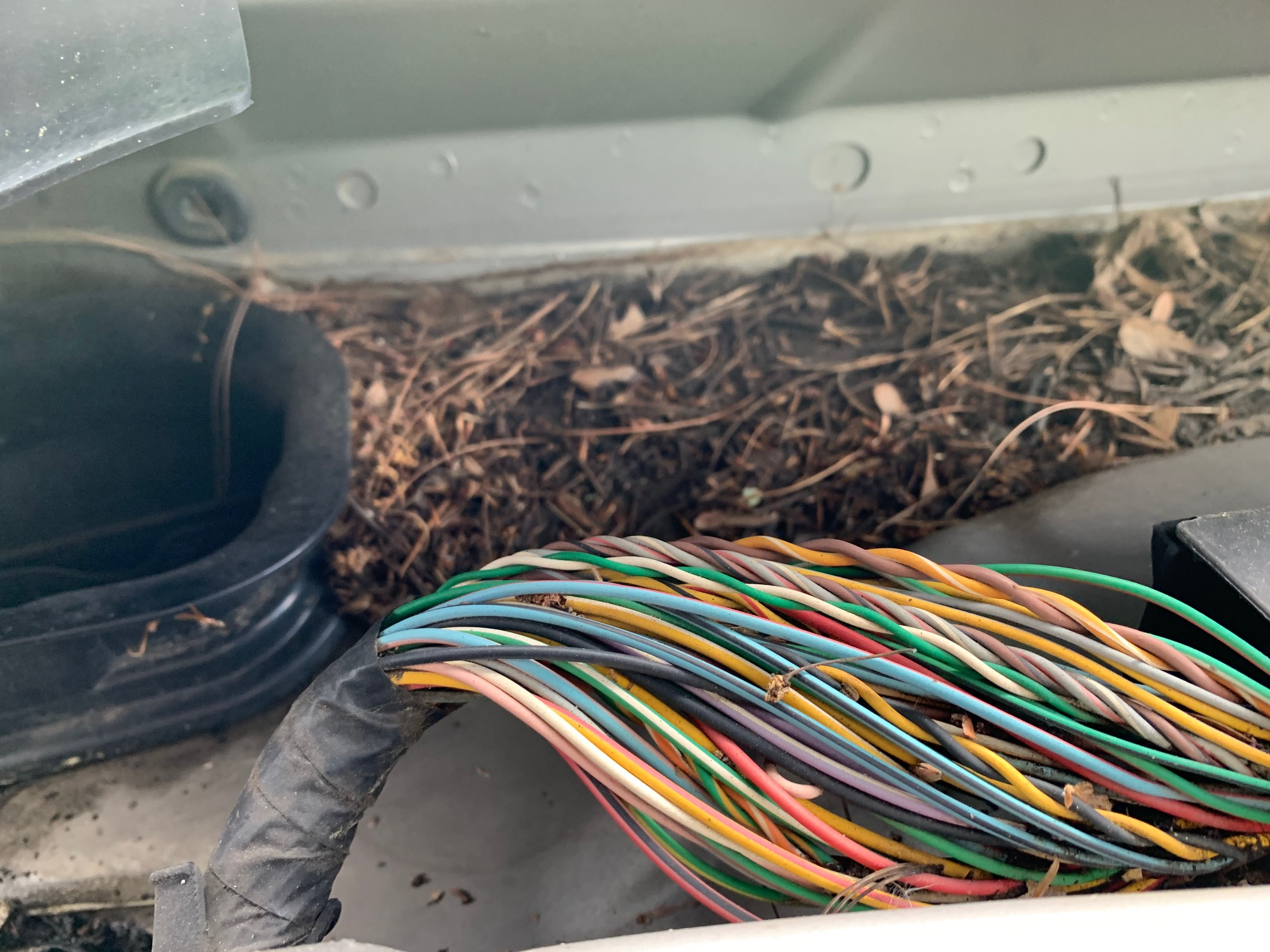

I was getting lots of water in the passenger footwell and found the Swedish National Forest around the air intake underneath the windshield cowl. Once I cleaned everything up I could not figure out how to install these seals (PN 8862737 & 8862738 #23 on the windshield cowl PDF). The things that look like clips, maybe to attach to the fender? are cracked off which doesn't help.
download/file.php?id=2375
thanks,
jim

These seals attach in the bottom corners of the windshield. The plastic rivet clip that comes with the seals gets pushed into a hole in the pan (item 18). There are other posts about leaks into the passenger footwell.
See my post for a shield covering the air intake duct. viewtopic.php?f=9&t=92152

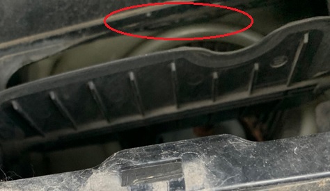

Oh, that was quite some forest there. Also around the intake for the cabin blower, there is a foam seal around the opening where the outer black plastic neck is seated against the car frame. Mine was displaced a little at some point, I think I see yours also coming loose a little bit, worth a look (pic). Finally, worth looking at the bottom cover of the cabin blower, if a previous owner removed it and didn't put back all 5 small screws tight enough (especially the hidden rear one), this bottom cover is not sealing and will leak water inside the cabin
- 1.jpg (40.25 KiB) Viewed 2473 times
