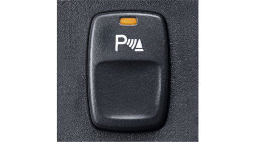

Is the LED in the Park Assist switch on?

It would be in the row of switches in the center console.
Park Assist is an option not standard equipment.

When this feature is turned on, the radio display will say: "park assist aktive"
I thought at first that this is a gimmick, but I have come to appreciate it a lot and use it all the time.
