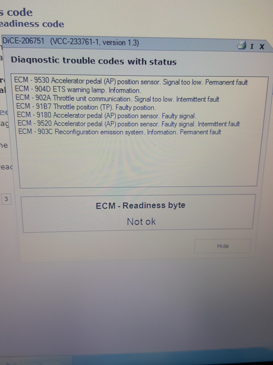

Can anyone maybe help shine light on some info on my findings with Dice tool. Here is an image for starters.The accelerator pedal is a fairly new OEM Volvo that was replaced before i bought the car. My ETM seems to past the test so i can now remove that from the equation of it being the culprit.

Read & erase the codes and see which ones comes back.

The codes are current.

In that case i would check the wiring and connectors.
Is the car in question 2000 C70?
As far as i know if you replace etm on '99+ cars...it needs to be programmed in order to work,because they are "married" with the car.
I could be wrong,so i would wait abscate or someone with '99+ car to chime in.

According to the ETM test done with VIDA DICE it passed the ETM test, both potentiometers were in sync with one another, if there was a way to share the short video recording i made while running the graph test i would put it on here to share my results.

I would snag a accelerator pedal assembly from a junk yard if you can find one. That seems to be VIDAs biggest complaint.
I don't think the pedal sensor has to be married in software to the car but I could be wrong, I have swapped ETMs between cars and left the original pedal sensor there.

Neither Pedal sensor nor ETM are married to VIN but ETM must match software in ECM

It has a practically a w pedal assembly, an OEM Volvo one, the guy i bought the car from said he just spent around $200 for it and installed it right before i bought the car. But something is clearly not working properlyOzark Lee wrote: 05 Jan 2020, 14:59 I would snag a accelerator pedal assembly from a junk yard if you can find one. That seems to be VIDAs biggest complaint.

How can i find out what software the ECM has because i saw everything in the vida test about the ETM, software number and everything and it says software was up to date i believe.abscate wrote: 05 Jan 2020, 19:08 Neither Pedal sensor nor ETM are married to VIN but ETM must match software in ECM
