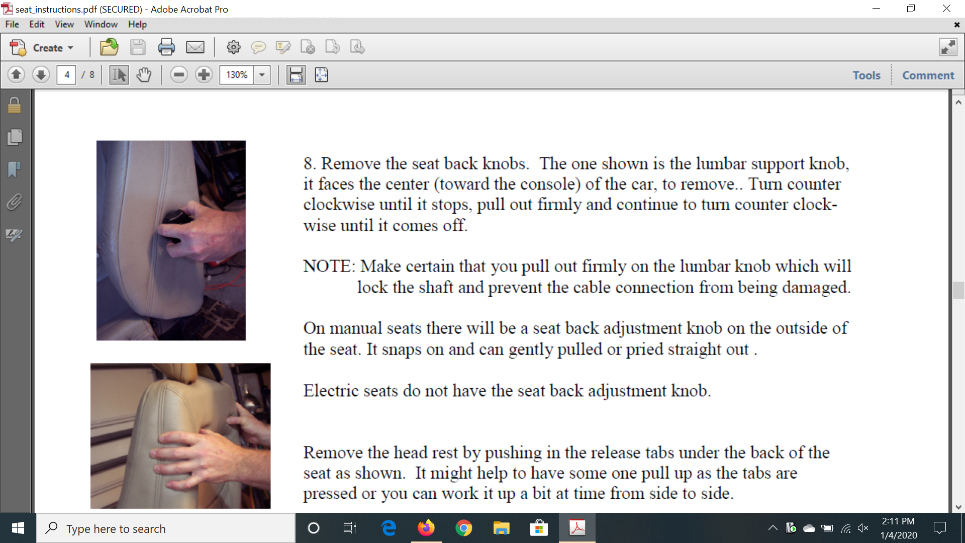

Greetings All,
I am trying to get seat covers onto my front seats and need to remove the Lumbar Support Knob. The car is a 2002 V70 X/C. Center of the knob does not seem to pop out and I do not want to damage the seat, as this car is near perfect. Any advice as to how about removing the knob?

seat_instructions.pdf- (1.63 MiB) Downloaded 351 times
