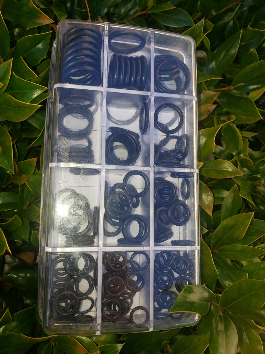

I found a set of O rings in various sizes in plumbing section of hardware store. Would these be ok to use or are the O rings on fuel injector something special?

Hardware store o-rings for plumbing are not petroleum/gasoline compatible so won't do.

Good point. Thank you. Hopefully will come out and go back in with no issue.oragex wrote: 05 Jan 2020, 13:51 Hardware store o-rings for plumbing are not petroleum/gasoline compatible so won't do.

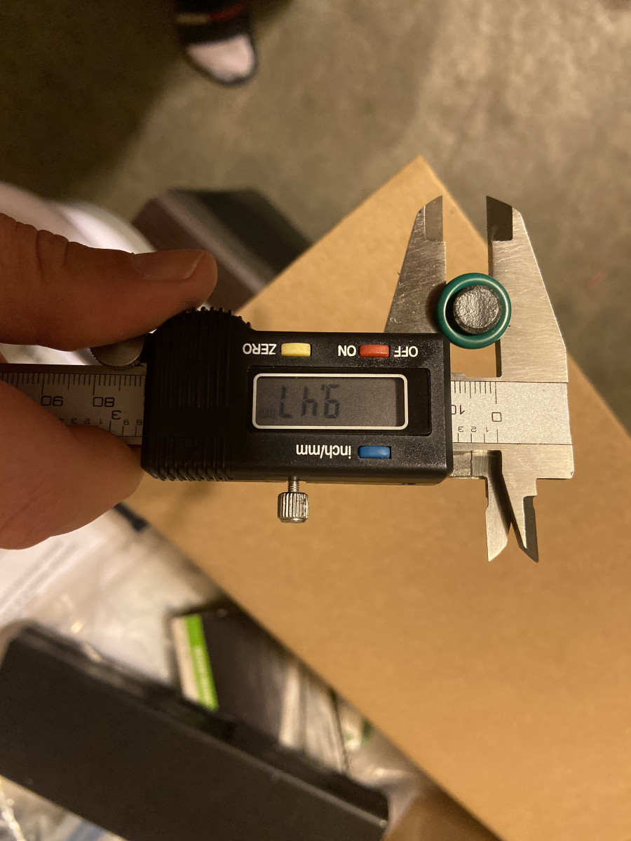

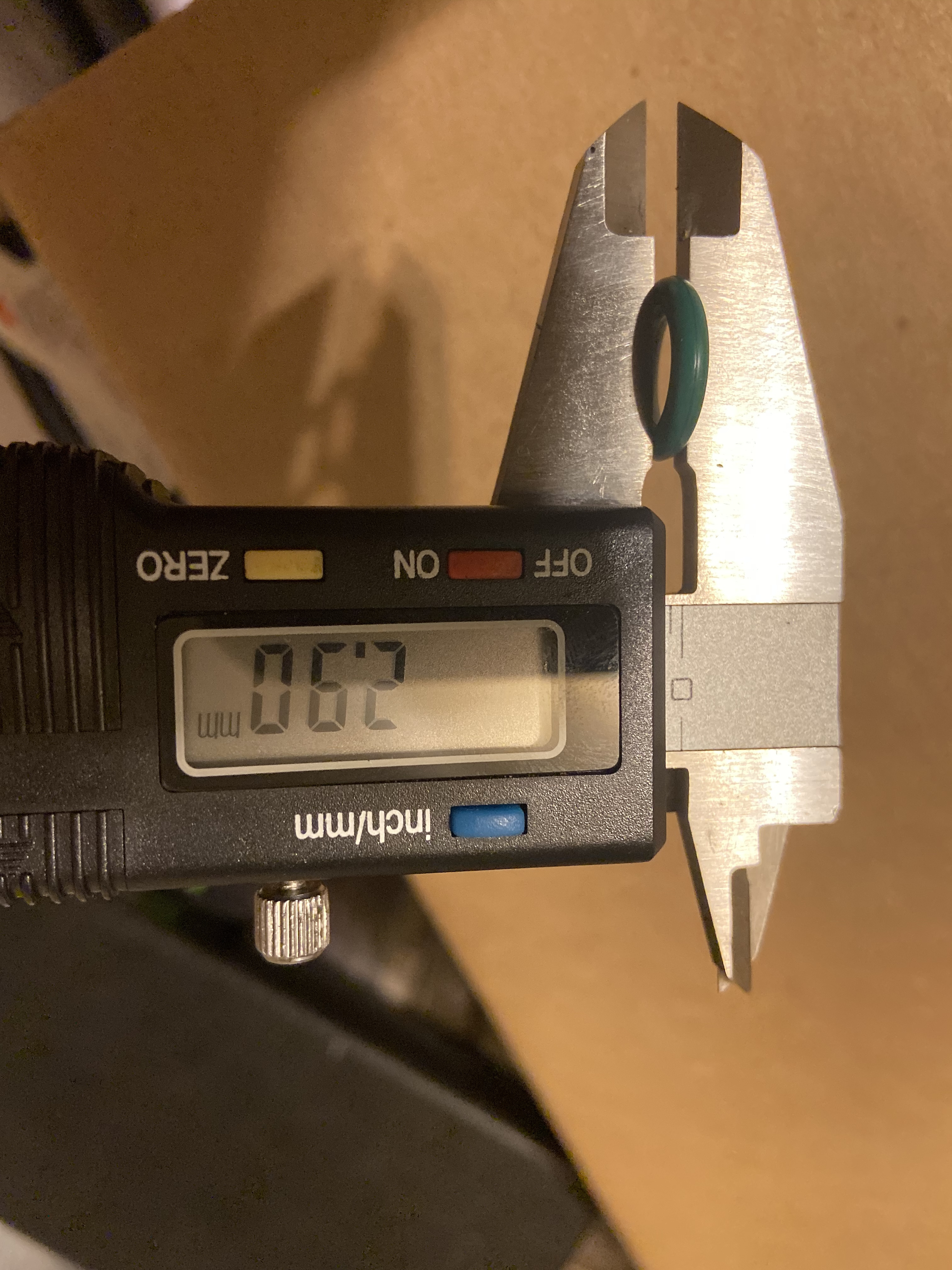

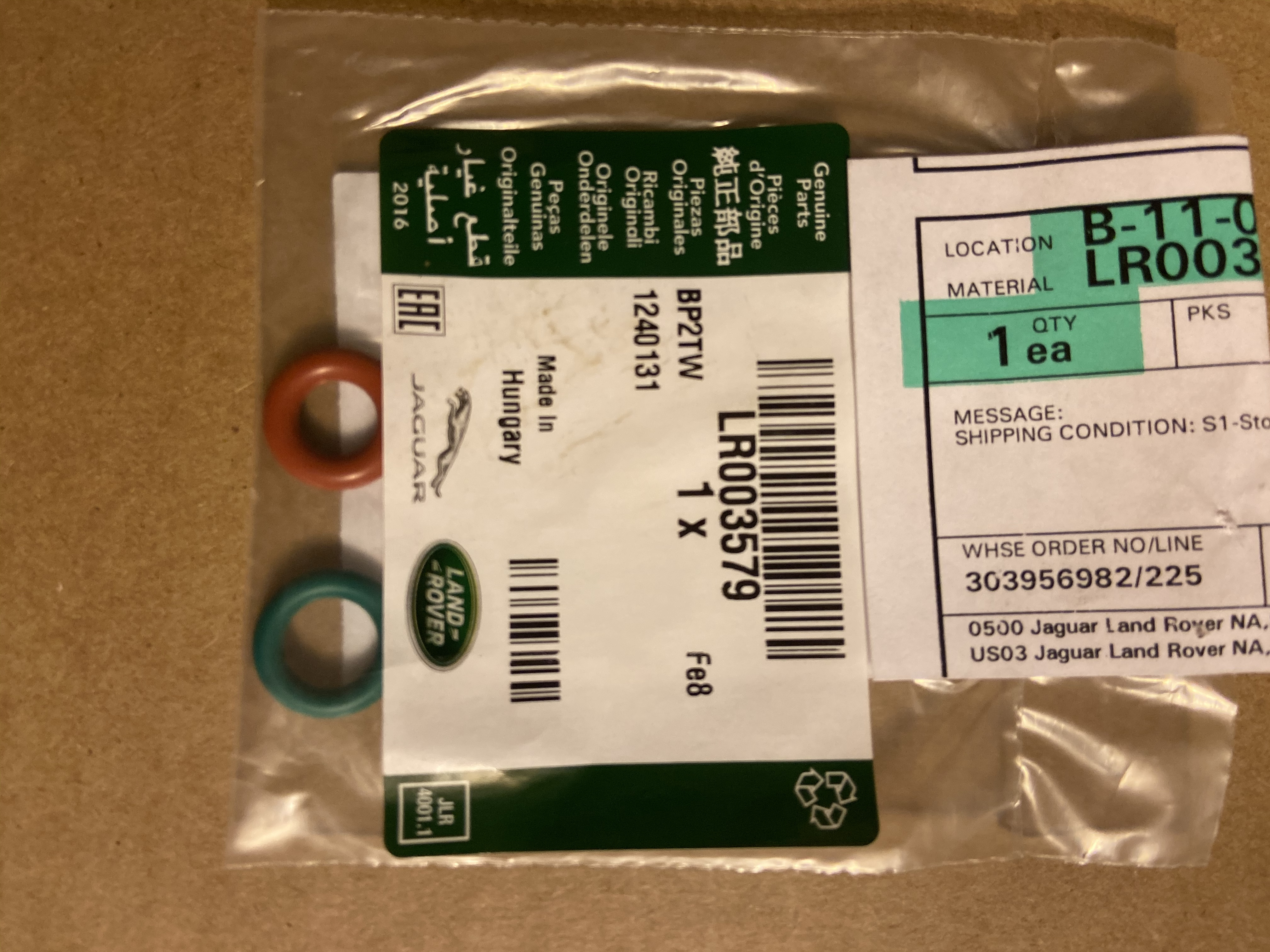

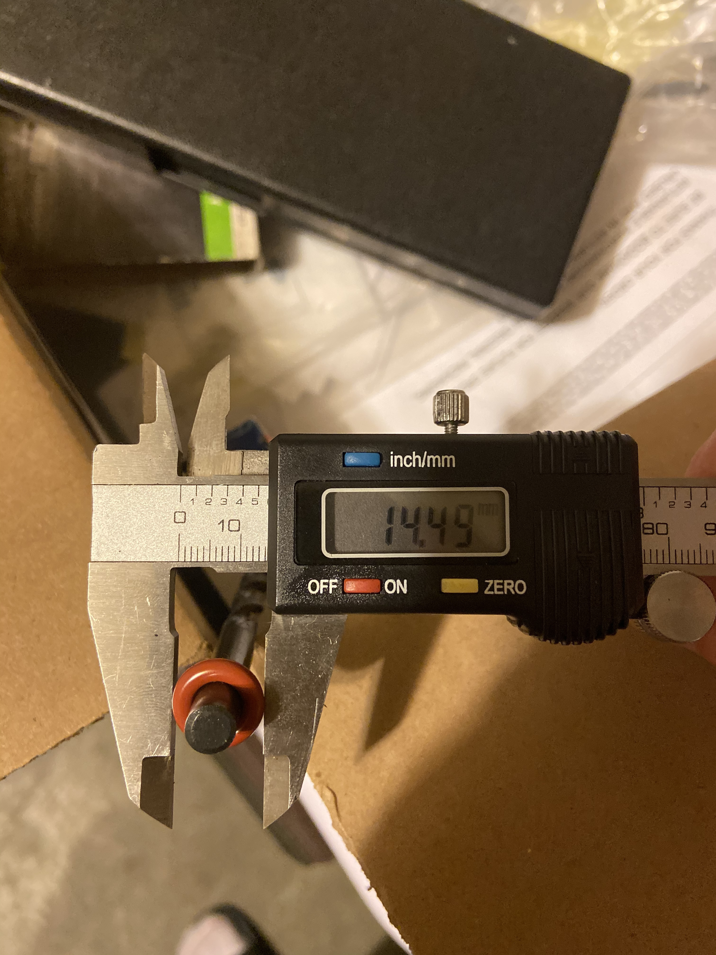

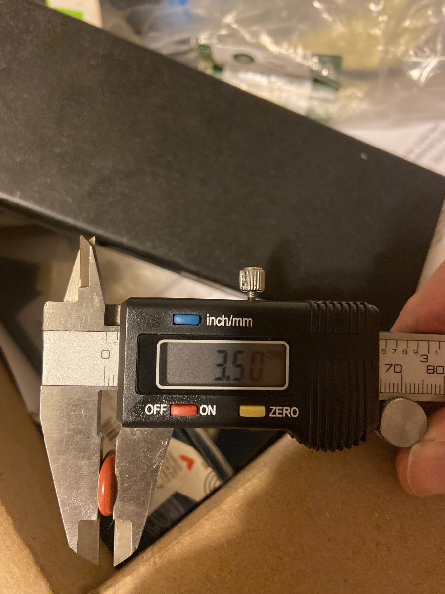

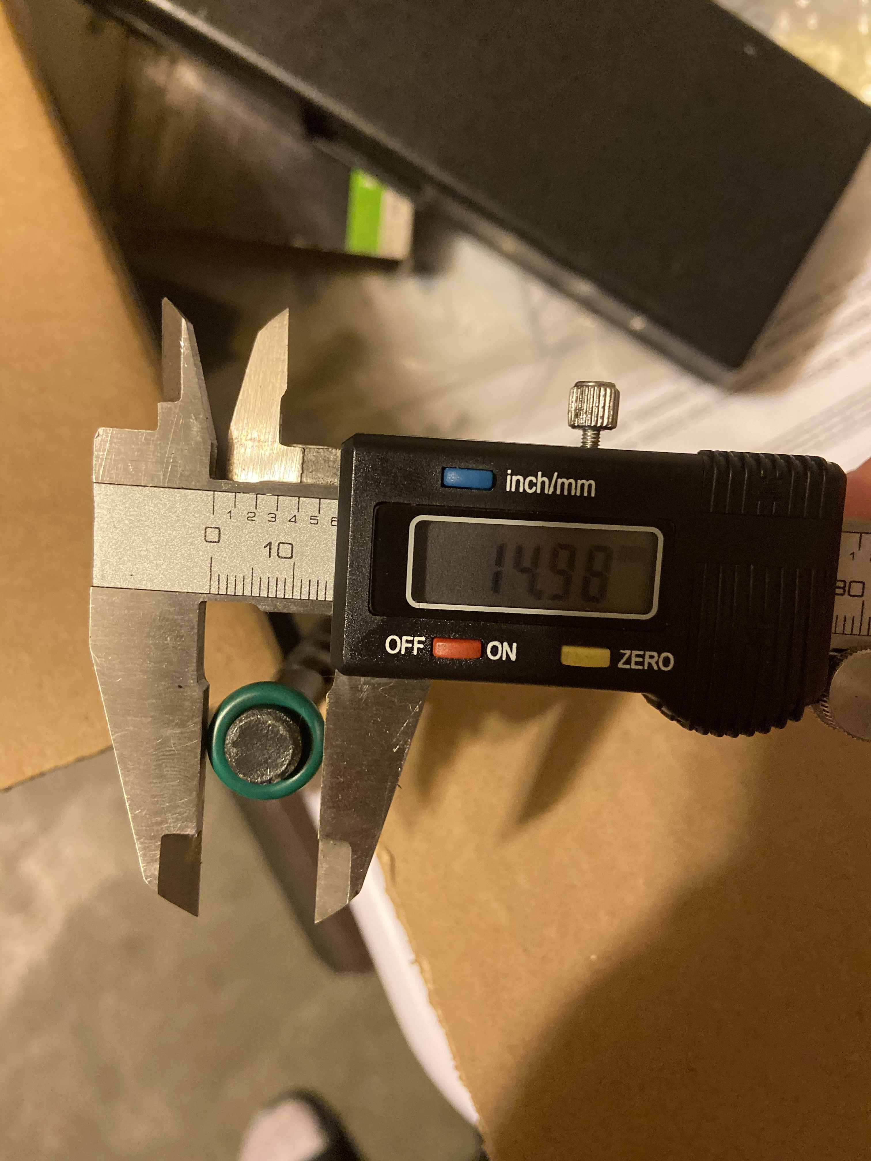

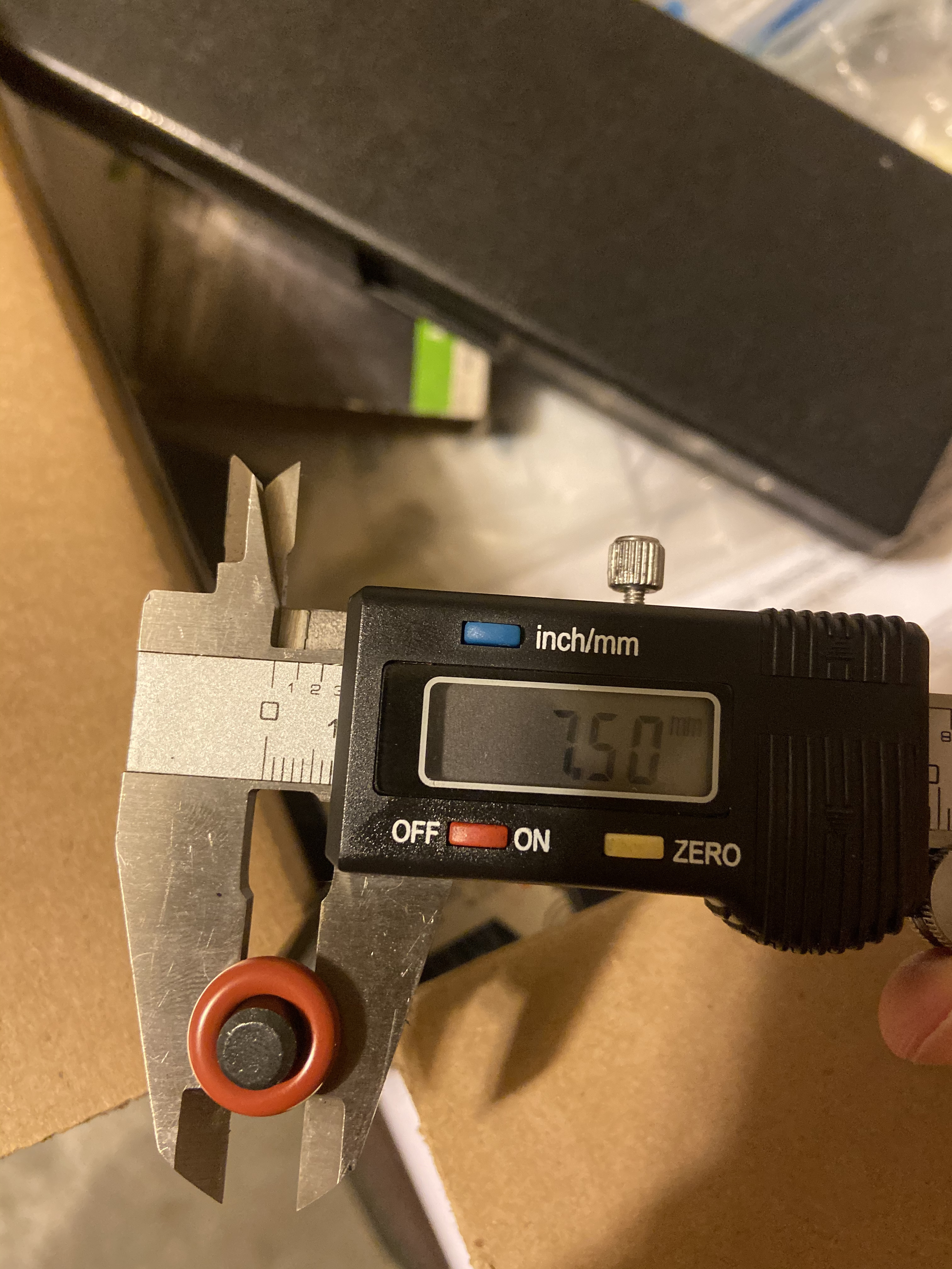

- pgill
- Posts: 813
- Joined: 27 Aug 2018, 17:42
- Year and Model: 2010 S80, 2008 LR2
- Location: California
- Has thanked: 120 times
- Been thanked: 189 times
Abscate Thanks
Here are the sizes for the O - rings as measured by my calibrated calipers
Green
I.D. 9.5 mm (.374")
O.D. 15 mm (.591")
Thickness 2.9 mm (.114")
Brown
I.D. 7.5 mm (.295")
O.D. 14.5 mm (.571")
Thickness 3.5 mm (.138")
I haven't found an aftermarket source
But as shown in the picture the O-rings can be bought from Land Rover Part number LR003579
If someone knows the correct Volvo part number please post it here for reference
Thanks
Paul
