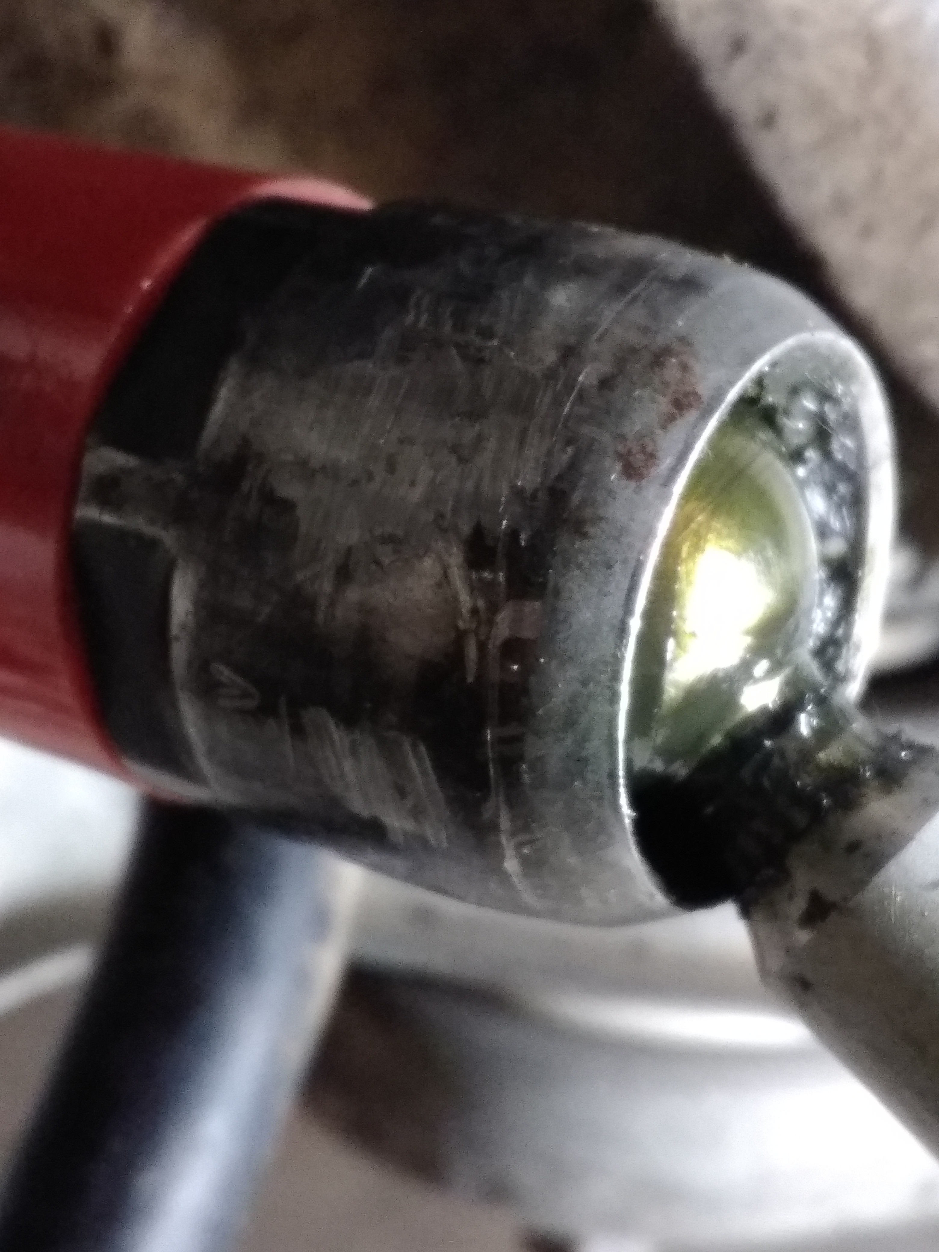

As you can tell the LH (drivers side) inner tie rod has a red graphite sleeve of some sort but up against the tie rod so I could not use my large crescent wrench to break it loose like I did the RH (Passenger side).

If this is to remove the old tie rod end, then use vise grip or pipe wrench to grip for removal. For proper install of the new part, you may need to make a thin section wrench by grinding an old wrench on the sides.

I got it off, ended up using a long pipe wrench.Now to send back my new ones sent they sent the wrong inner ones, i have the SMI rack, I think they sent me the ones for a TRW rack. Set me back a few more days darn it.I also seen someone else has already done an in depth write up on this subject, i should have figured that,lol.

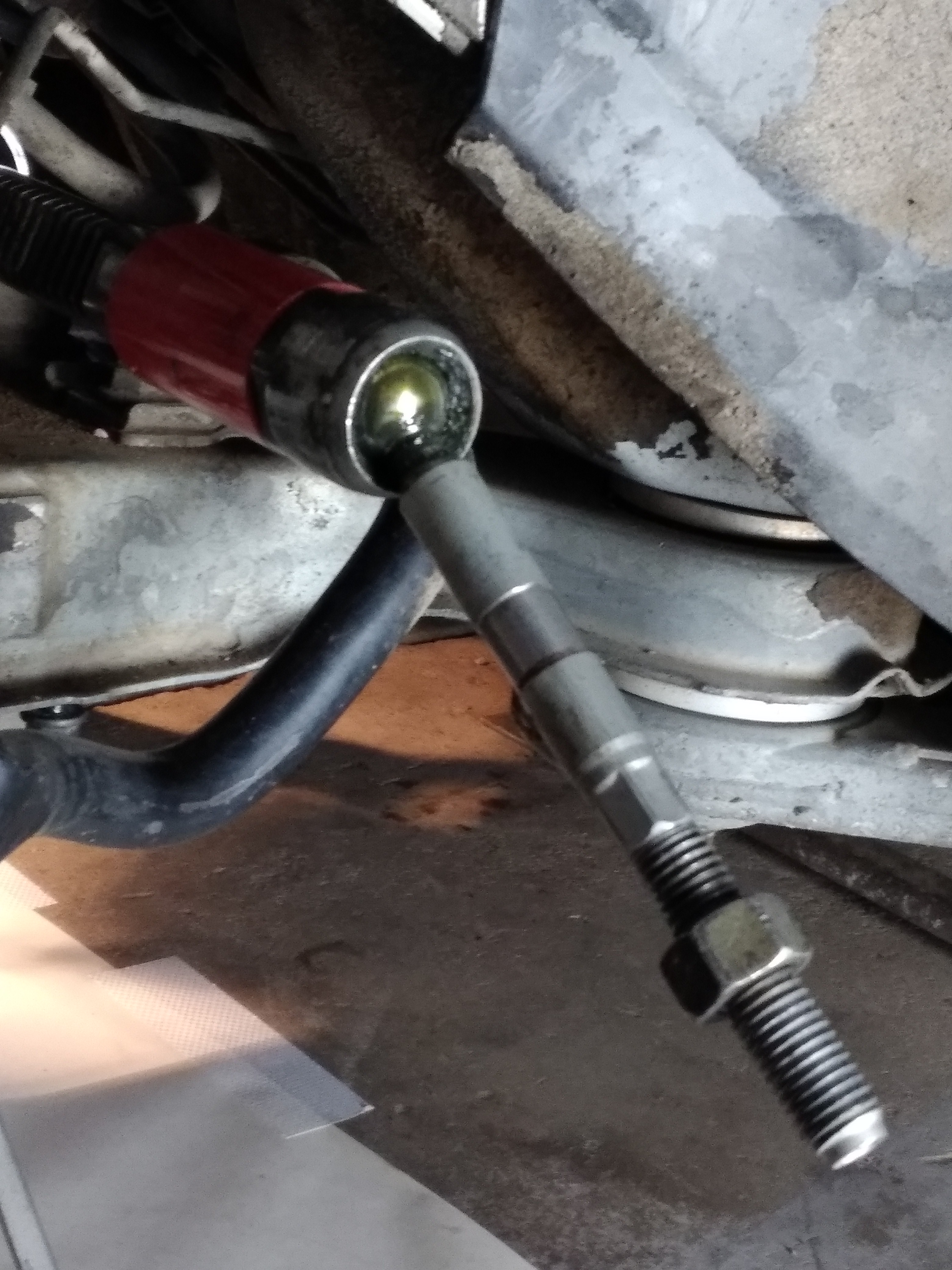

Have a question about the plastic sleeve that butts up against the inner tie rod:
What is its purpose?
In the picture above, the sleeve on his rack is red.
The rack I installed had a green sleeve. But, I don't remember if I pushed it back too far towards the center of the rack or not. Would that cause problems?
