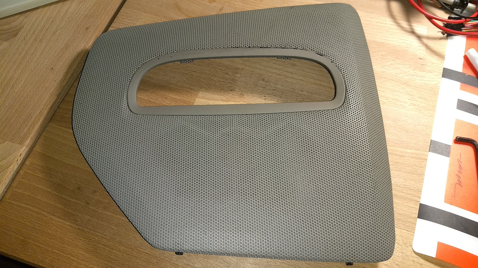

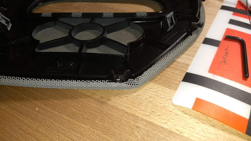

Re: BZ Nav Screen Removal Help
Post by vtl » Mon Jan 13, 2020 7:28 pm
Use a 90-degree pick like in this set: https://www.amazon.com/TEKTON-6943-Prec ... B000NPPBQK
You just need to pull it up in a few spots. Hope pictures help.
The frame under it is 4 torx screws, the RTI display is another 3 screws.
