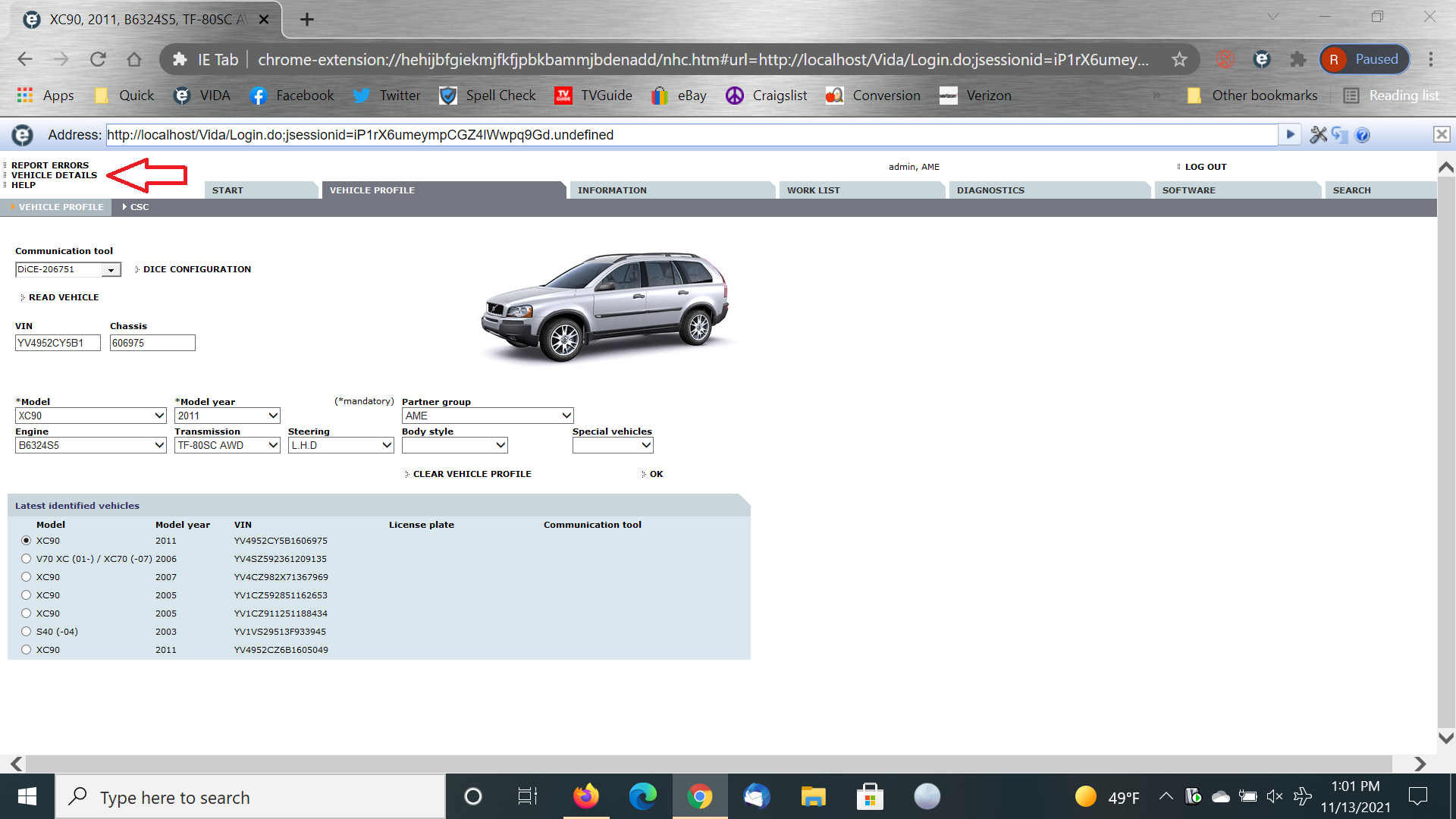

Dig through the page source and the database.Nilsson wrote: 13 Nov 2021, 08:21 do anybody have the "configuration test" file they want to share? i want to try it but want to know how the file look first and see if i can extract it myself
