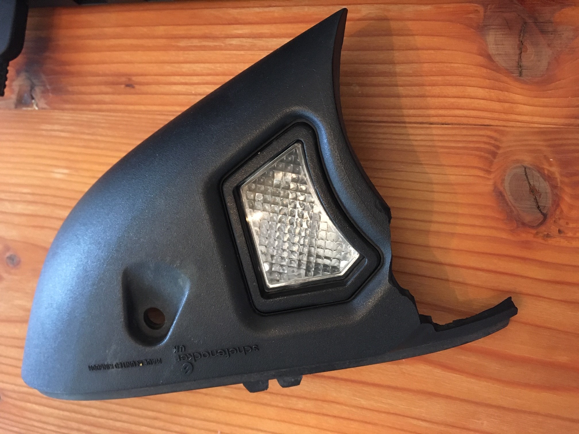

my wife hit a pole with the RH mirror of our 2007 XC90 3.2.
I am struggling to identify which part to order for the broken lower cover.
The only thing that comes close is Part Number: 30716804 (part 6 in the diagram).
But this does not appear to fit with the puddle light.
Any help appreciated. I hope it's not coming with the whole mirror housing only.

Look for a Volvo part number on the broken part.

(Part?) numbers found are:
3004-136 RH
3004-138 RH
Other info:
>ASA<
schefenacker
Made in United Kingdom
3004-136 RH
3004-138 RH
Other info:
>ASA<
schefenacker

31297438 is the whole part.
Although it looks to be separable, it doesn't look like that piece is sold as a separate part.
