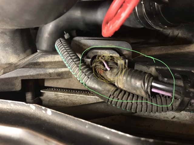

I’ve offered this suggestion up before, so may want to have a peek. On our 06 2.5T I had a similar issue. On occasion, it would crank but not start. I went through all the basic stuff but nothing wasn’t adding up to a solution. I ended up on some Russian website where a guy posted a video (of an XC) that contained my same issue. His solution ended up being my same solution. I still haven’t been able to find his video nor the site it was posted on & I’ve searched feverishly for it, since every time I post this I feel like a crazy person, not being able to cite my references!
Up on the top passenger (US) side of the radiator fan shroud there are a pair of substantive wires; one black, one red. In between these 2 there is also a tiny purple wire, maybe 16 gauge. Plainly visible was a length of green corrosion ~2-3mm in length, just up from the plug. The insulation had cracked or worn away & the copper threads inside had corroded, leaving what I assume only sporadic transmission of whatever signal was meant to pass along that wire.
Anyhow, I cut that section of wire out, soldered in a new piece, heat shrinked it & had zero issues after that point in time. We owned that car for 1.5 years after I had that incident without another occurrence.
I’ll post a picture of the area I’m talking about.
The vicinity is circled in green. More specifically, my break was in the area circled in mustard.

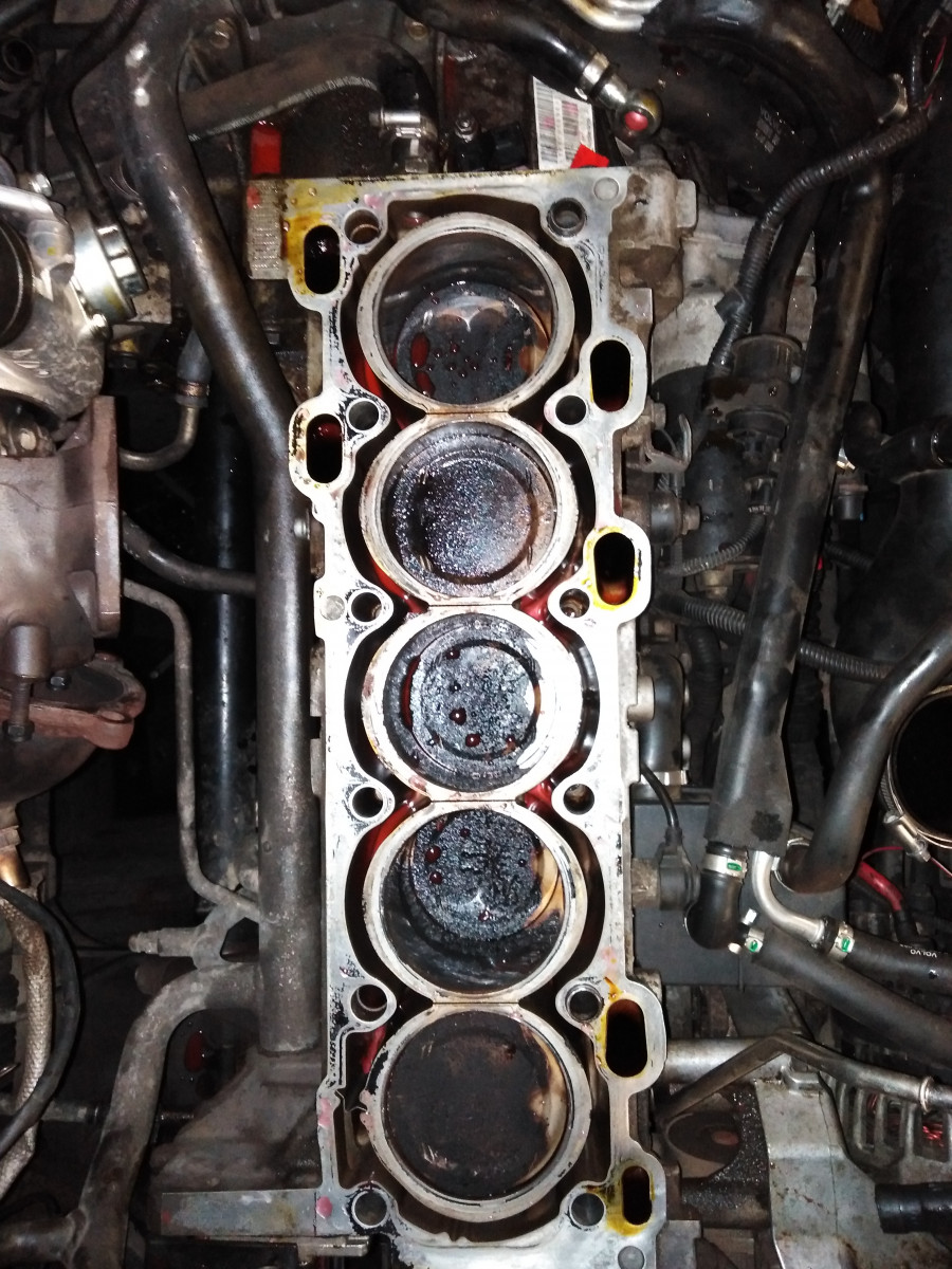

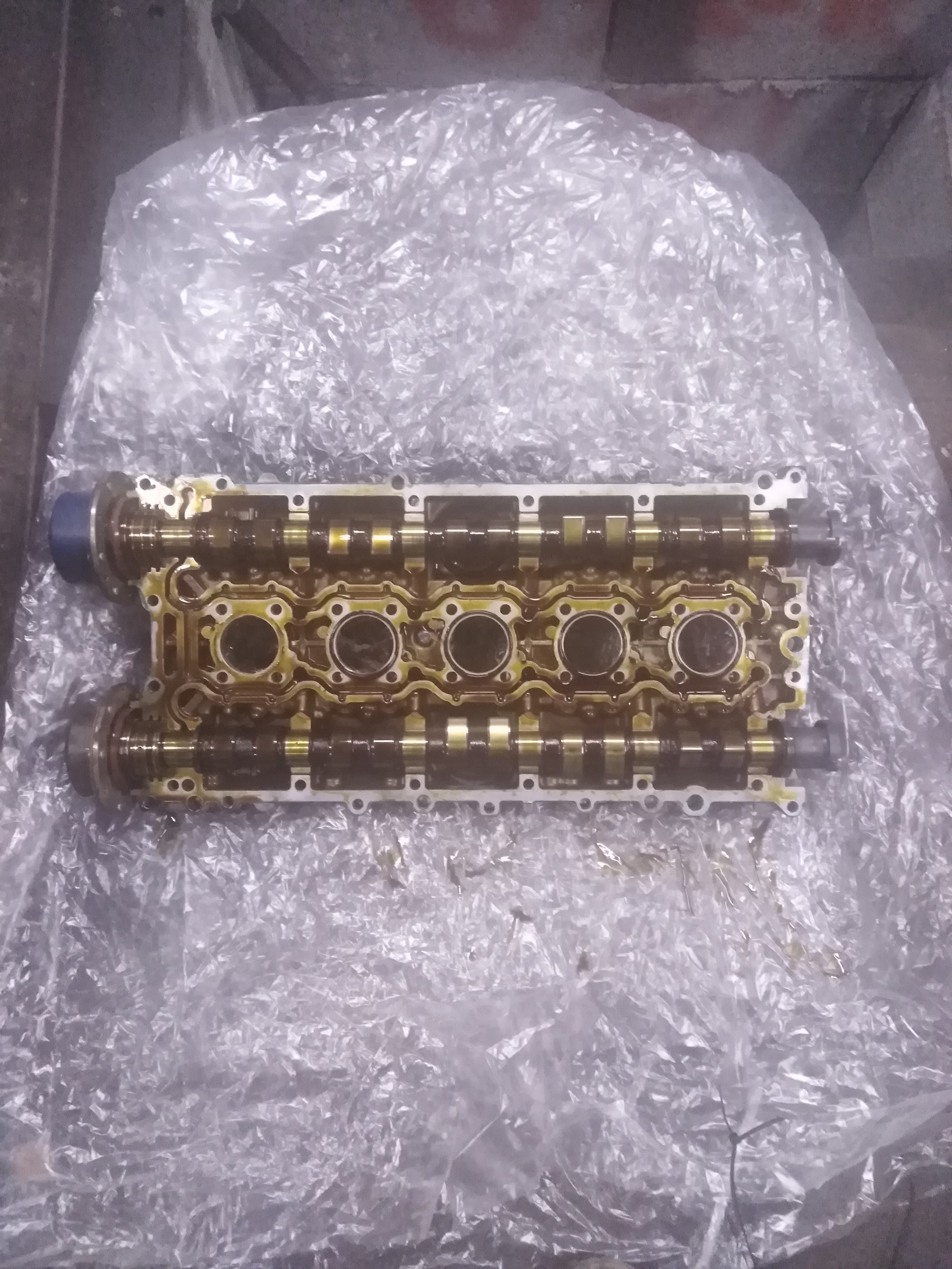

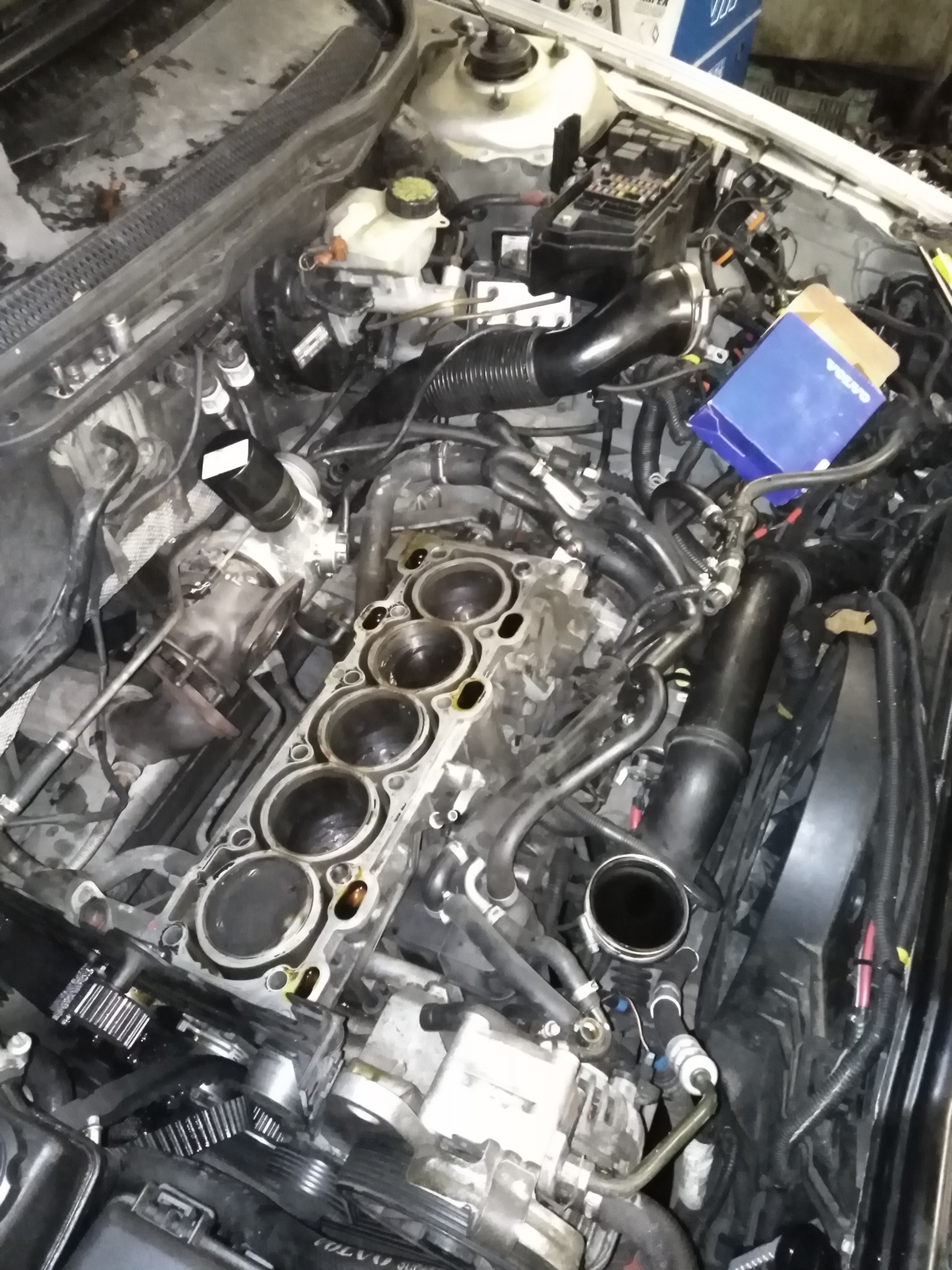

Pulled the head yesterday at mechanic. :!:
Timing has jumped couple of teeth altough the belt was okay on tension and condition. Seems water pressure inside caused to the exhaust side a block. Unfortunately I have to change all the 10 exhaust valves too. :cry:
The cause why its got head gasket problem...gasket wasn't cross burnt, but the layer have space between them, that means I have to take out the block too and refurbish, last time the head has torsion which was refurbished - my mistake that I didn't took out the block that time. Fortunately itt seems after pre-check of the block, that there are no crack, should be only torsion in worst case or just have to refurbish the surface.
Costly way of learning :!: :arrow: Anyway I do it the right way now, what I change will be original part only! Also If I have time then try too detail everything in the engine bay... :mrgreen:
